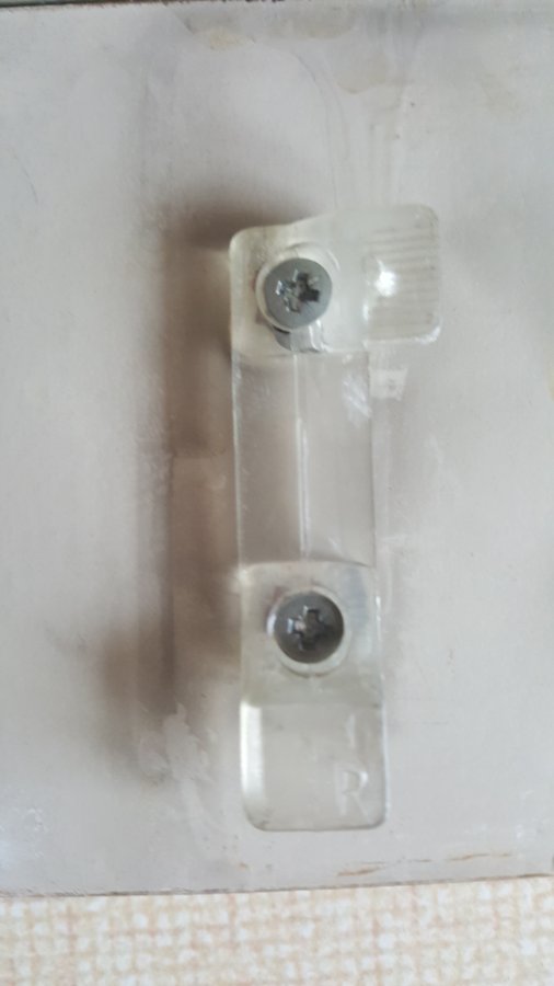

Hi Guys,
I have a very old fitted kitchen set up at home and one of the fixings to my draw has broke what is the best solution to getting this fixed...
Not too sure what I'm seeing but if it is the plastic bit if it has snapped cleanly then you can try welding it back together with something like ambroid pro-weld, EMA plasweld etc (basically pure solvents that melt the plastic back together). hold the two snapped pieces together and use a fine paintbrush or similar to introduce a drop of the solvent to the crack, it'll flow along it by capillary action and weld it back together.
If it's not snapped cleanly then you could try something like epoxy or a good dose of something like Evo stick 'sticks like s***' or a PU based construction adhesive - but you'd need to apply these across the back of the drawer front, not just where it snapped.
