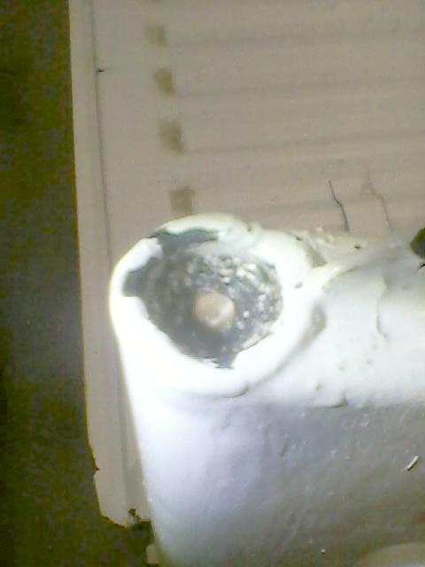

Two of the valves are seized and one has broken off when I've tried to loosen it.
Have seen this bleed kit. Does anyone know from experience if they work? ..... would save having to buy new radiators!
Here's a photo of the snapped off valve. Can't get the vicegrips in and drilling it out I doubt would be a success.

Yep, probably going to need to replace with similar you've posted a link to. Only other option might be a screw removing pliers, hard to tell from photo if there's enough to get a grip of.
I believe the best option is to get those in the link I posted.
The radiators are installed in bedrooms so not too unsightly.
