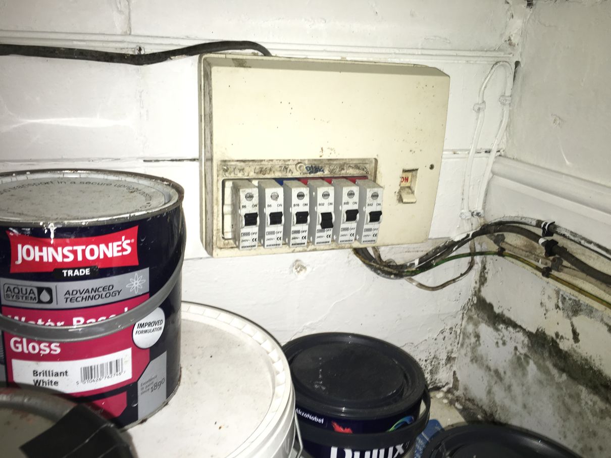

The accessible switch was a very sensible thing to install, as you probably found - you were able to isolate the pump when it repeatedly tripped all your sockets. Is it/does it trip the MCB instantly when the pump is switched on, or is there a slight delay? Delay could mean the pumps impeller (the twirly bit which spins in the water) is simply jammed or seized with a pebble.

I'd say it was pretty instant. As soon as i shouted for my wife to turn it on the MCB tripped. She said that she heard the initial 'clunk' that the pump does when it starts to kick in (don't get hung up on the word clunk, it's just how i'm describing the noise it makes when it starts to do its thing - the noise wasn't anything out of the ordinary) but then it just stopped and all this took like half a second tops so i'd say pretty instant.
So the manual on/off switch is in a room above the pump and there is no alarm or any other box of any kind below the floor but it is not wired on its own individual circuit- Yes?
Correct.
The on/off switch is not just in a room above the pump but in the room above the pump. The power cable wasn't the longest in the world at all.
Time to remove the tank with the pump inside (Tank is the new word for bucket/ housing ok?).
One Q- How high is the water level now since the pump is not pumping any water away.
To get anywhere near the pump now everything would obviously have to come up, we'd need to hire a pump to pump the built up water outside - so all this will probably now be done when the spark comes out.
As for how high is the water level, i would guess at its natural level of about 6 bricks high on a 9 brick high wall. My carpet is still dry for now, that's the main thing :)
