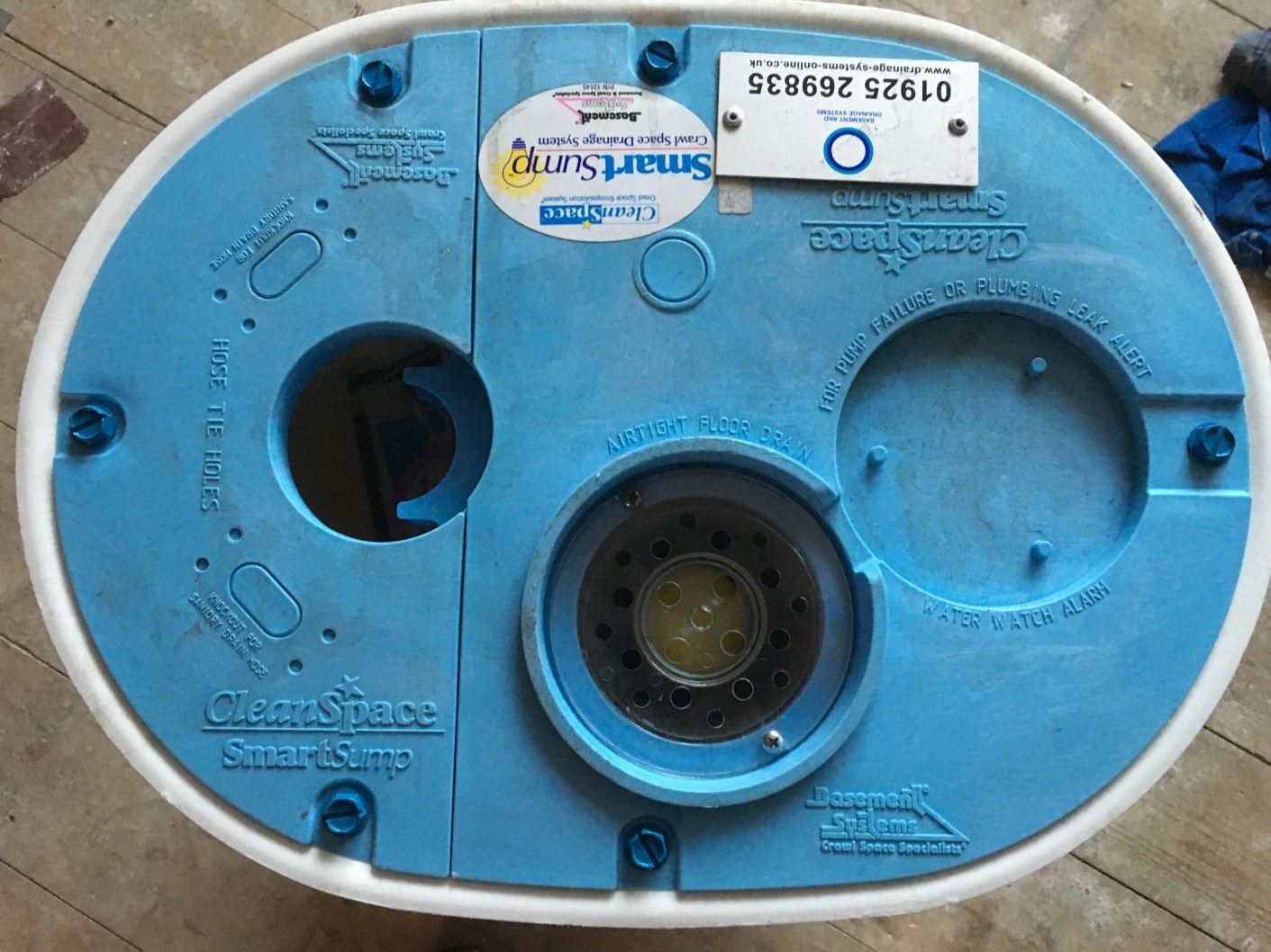

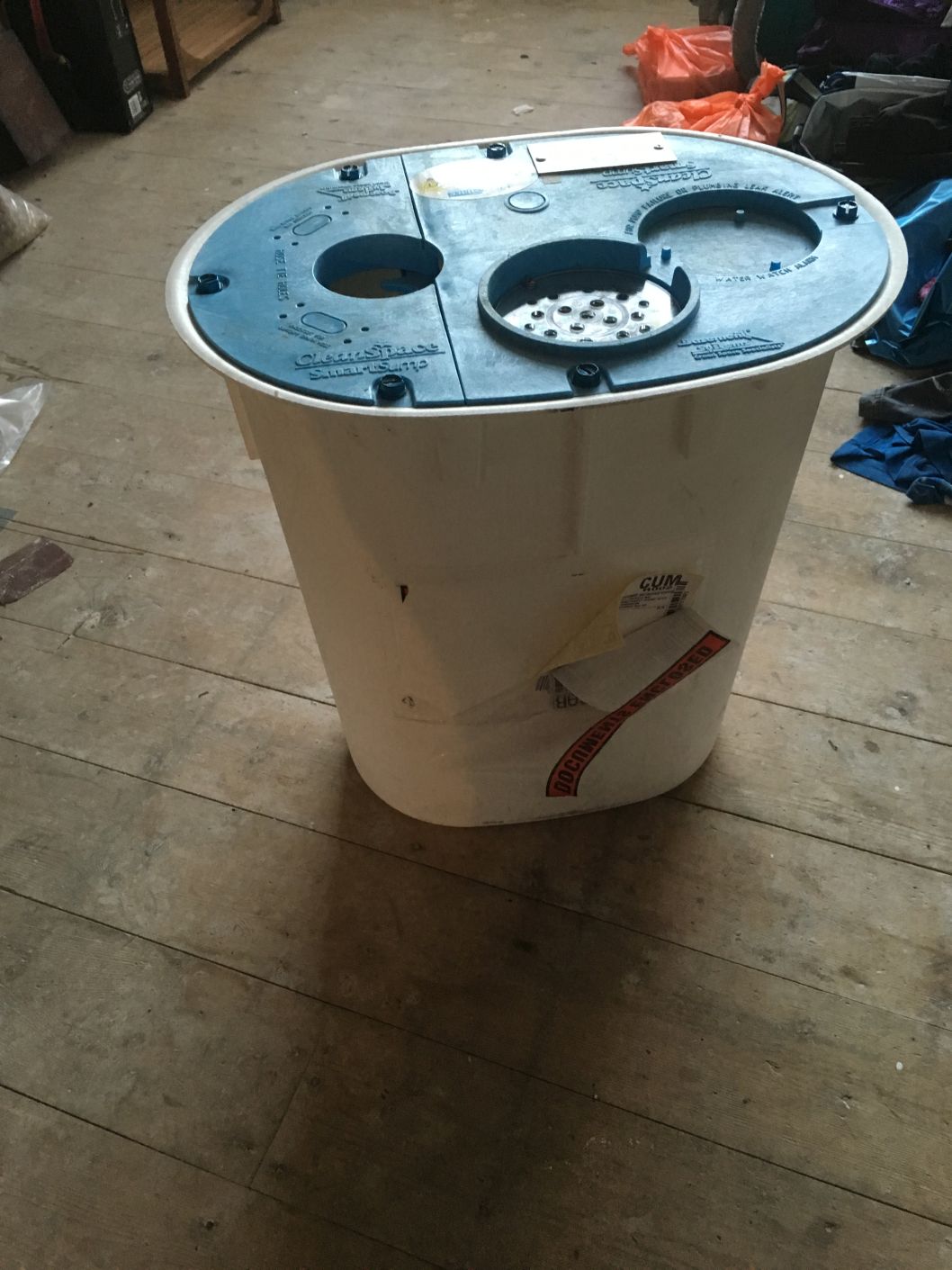

If you're thinking like a 10litre £1 bucket you pick up at B&Q that you use to wash your car with kind of thing then you've got the wrong idea. It came in its own 'bucket' / housing. I'll attach photos later.

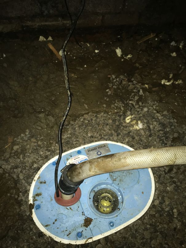

They dug a section of the floor down deep enough to place the pump in its bucket/housing. This was at the front of the house as that's the direction of the water flow. This was then filled with limestone chippings to aid drainage (basically so that the sludge isn't getting pumped out but the water is).

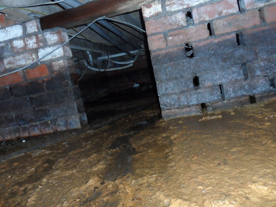

Sleeper wall & the crawl space floor...

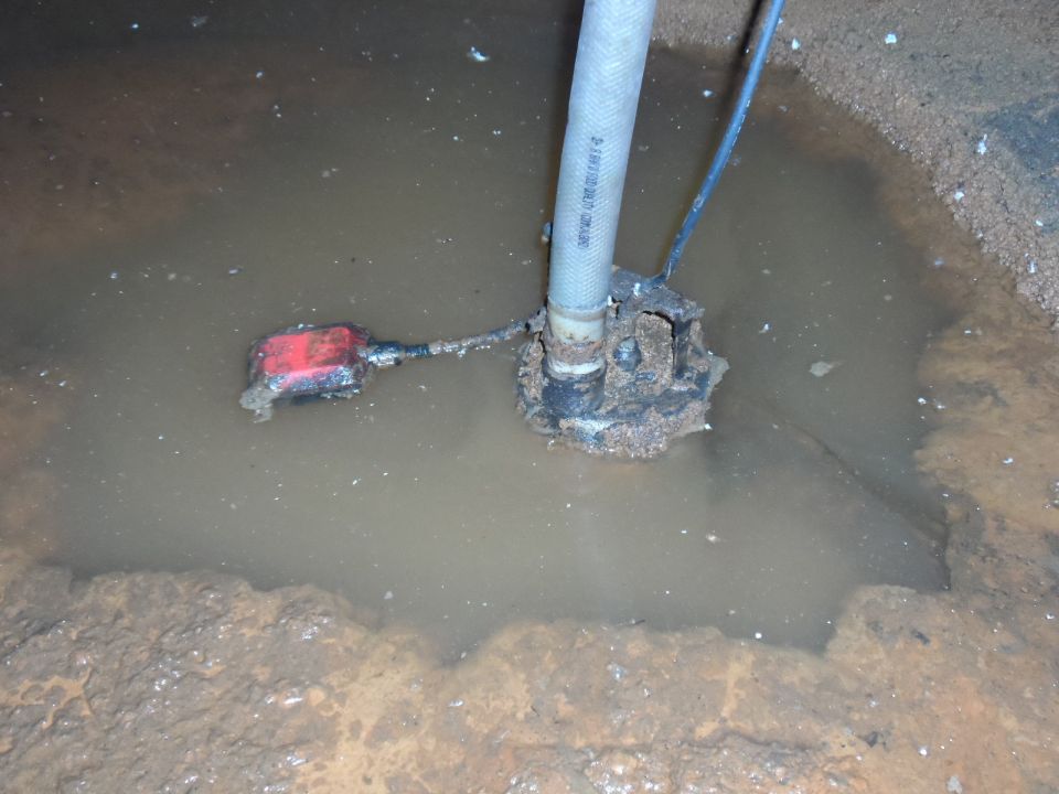

The old pump in the hole that was dug out. This pump was just thrown in & looked like a Screwfix cheapy so it would've been sucking all kinds of crap. When the new pump was installed they dug out a bigger hole to sink the new pump in proper...
The new pump which is in its own 'bucket'/housing/whateveryouwanttocallit...

The new pump installed in the sump / ground that has been dug out to house it. Filled with limestone chippings to stop all the crap being pulled out...

If you look at the photos of the pump above, it is fitted with a float switch - its the red unit floating on the end of a cable, next to the pump.
It uses a ball bearing inside the float switch, which when the float rises - the ball shorts two contacts.
