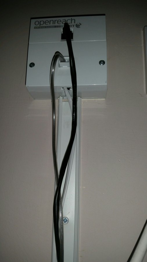

I have this in the hallway;
And i have this in the livingroom;
This is beside tv box and router etc for BT. When work was done with floors I got the cable rerouted under the floors, as it was installed around doors, skirting, windows etc bt BT guy.
Now, we have a basic alarm system that I need to setup. I would like to put the main keypad in the hallway and was wondering is there anyway I can get a phone line socket of this plate in the hallway rather than have to run a long and unsightly cable to hallway back from living room!?
Hope that makes sense. Thanks in advance
The hallway box is a standard NTE with a blank (no-socket) faceplate. You can remove the blank faceplace and replace it with a socketed filtered faceplate eg
http://www.adslnation.com/products/xte2005.php
If your lounge box is connected to the faceplate terminals, reconnect those wires to the unfiltered terminals on the back of the new faceplate. There are also filtered terminals on the faceplate which you can use if you want to hard-wire your alarm to the phone line so it cab't be accidentally unplugged.
This should be acceptable if you use ADSL but if you have FTTC / Infinity / fibre then it may slow down your broadband speed.
Yeah I have Infinity which is why we moved the "master socket" to living room. I just need to connect alarm to phoneline, if i hard wire it as suggested will this effect internet performance? The run from this plate to master socket is approx 8m.
Some alarm systems "take over" the phone line to ensure that the alarm call can be made even if the phone is already in use. Others simply connect to the line and hope that the line is not already in use.
Ones that take over the line have to be connected between the incoming line and the phones in the house. The incoming line goes into the alarm unit where it passes through normally closed relay contacts and then back out to the house telephone wiring. When it is necessary to make an alarm call the alarm unit first operates the relay to disconnect any calls in progress. It then connects its dialler to the phone line and waits until dialing tone is present before it makes the alarm call.
This is what I have done with my alarm system. When I went to infinity, they changed my living room socket into the master as for some reason the one in bedroom was the master upstairs). I then connected A & B from the alarm system onto the 2 connections on the back of the master socket so it's first in line as shown below. Hidden away so cannot be disconnected - the white cable going into the back of the socket (have conduit round the room for other cables)
