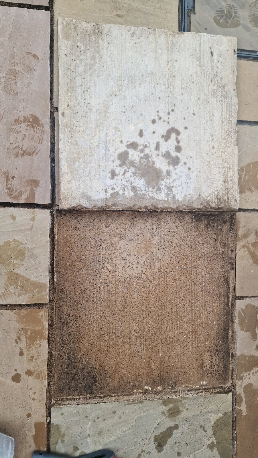

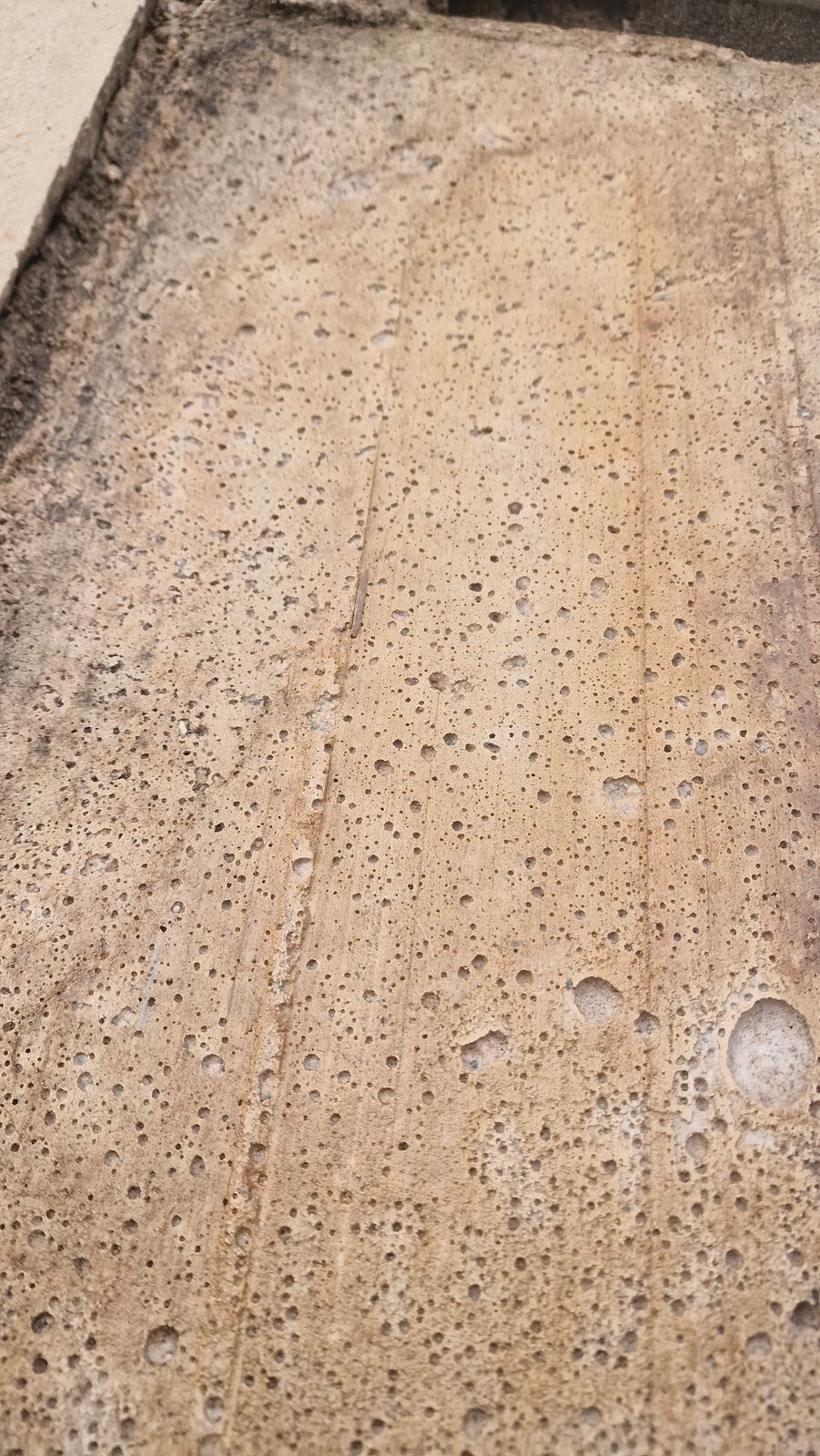

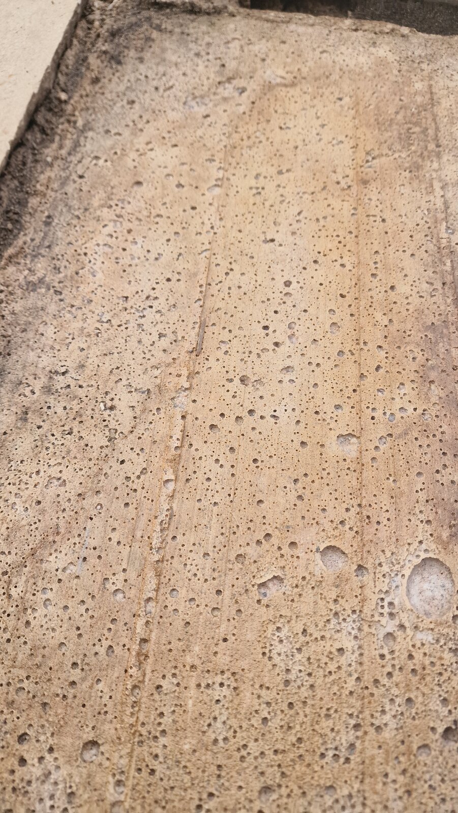

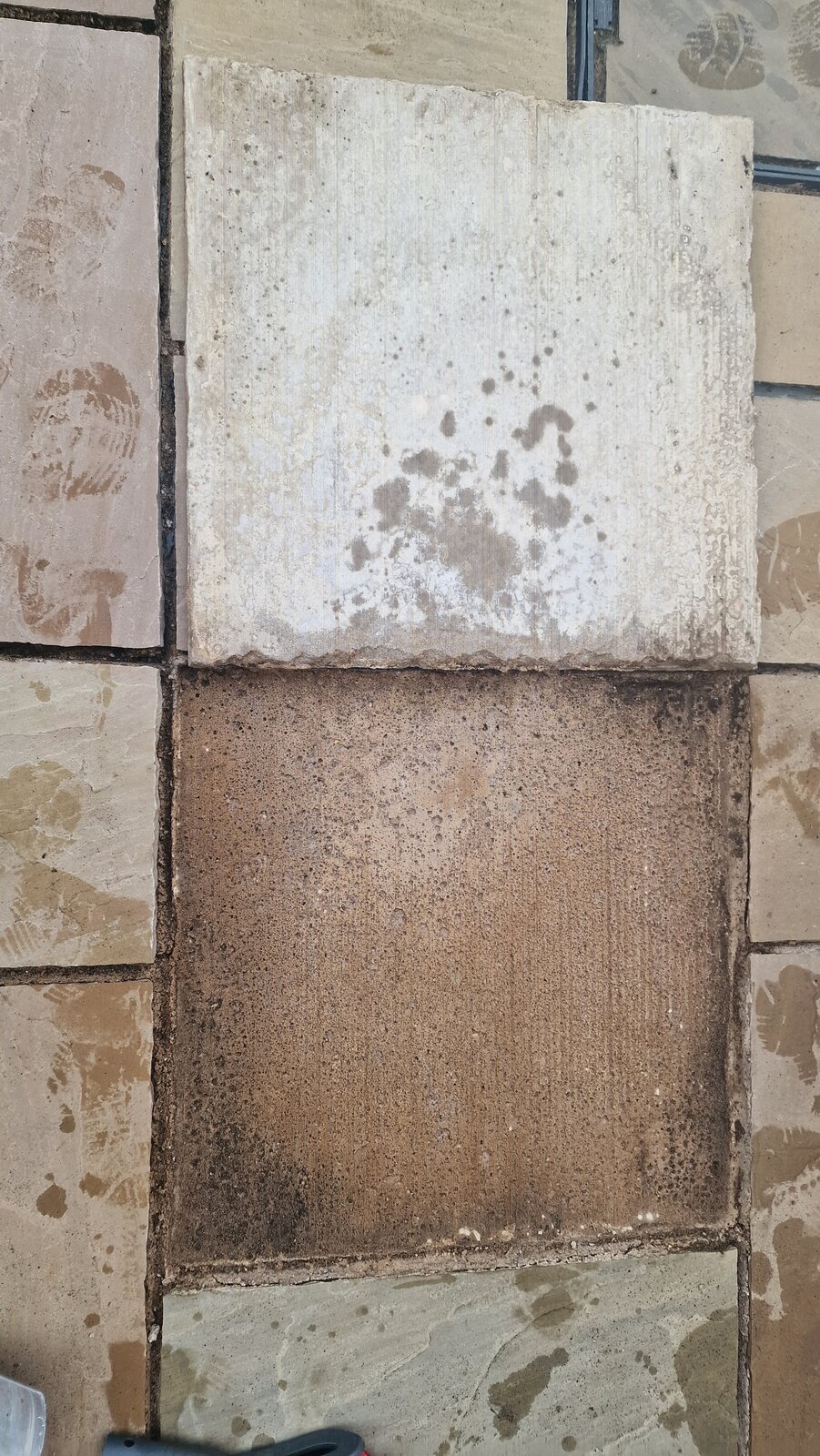

I'm re-laying a 3 yr old patio that looks like no primer was used on the back of the slabs. The bed is full and solid, and you can see the grooves from the slabs in the mortar. The mortar seems to have just come away from the slabs leaving them clean.

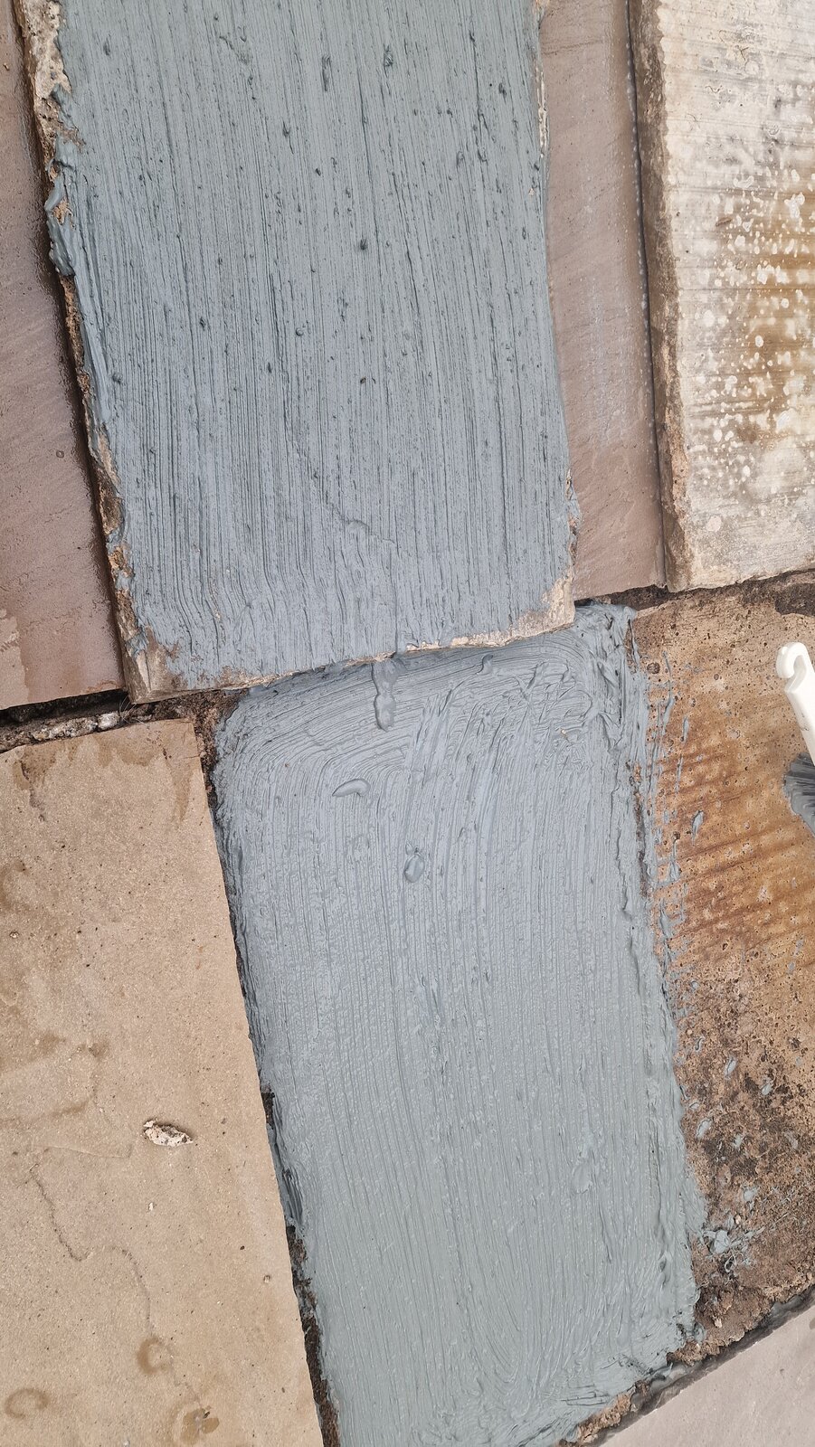

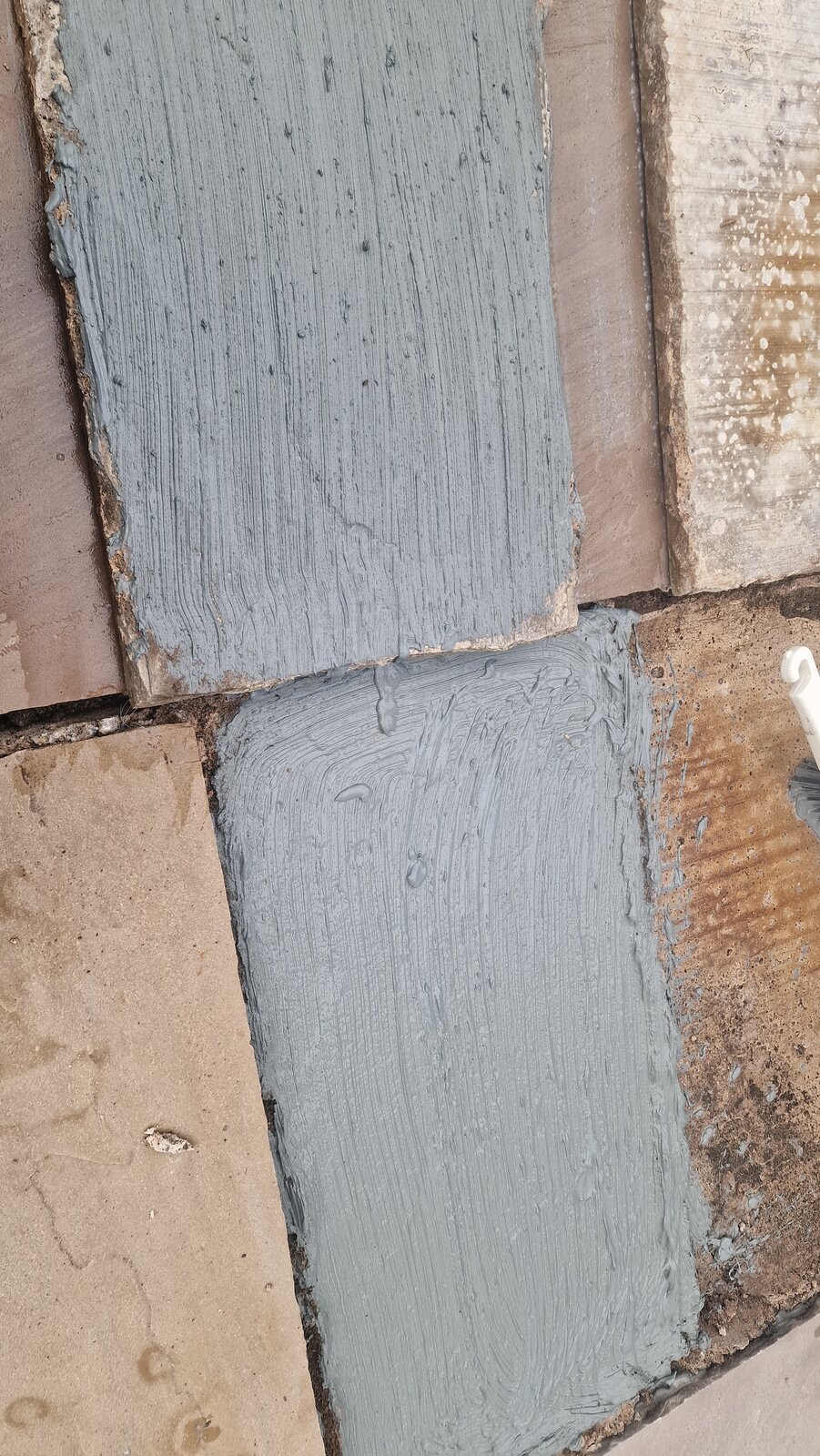

to re-lay I'm using SBR:water:cement as a 1:1:5 slurry.
