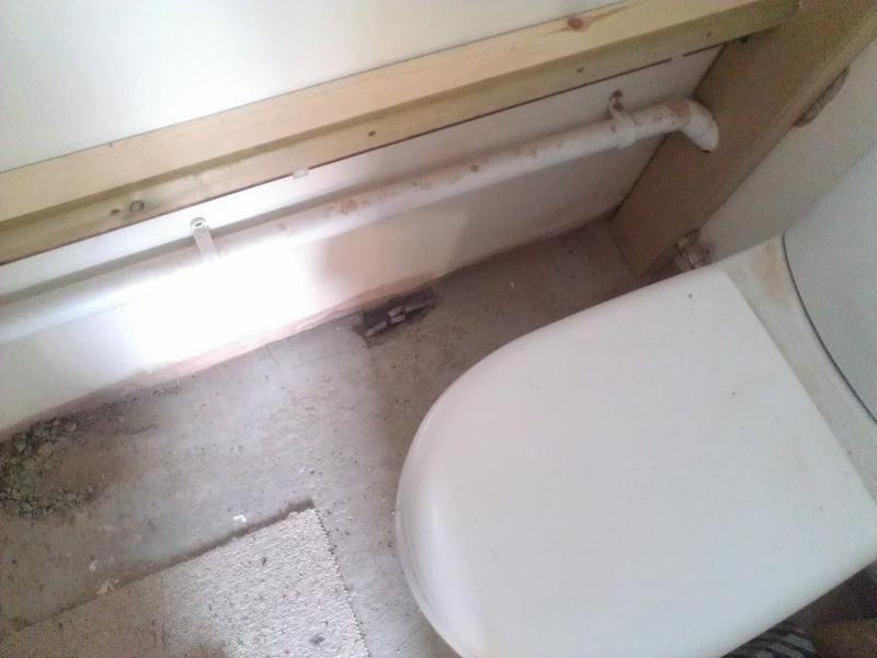

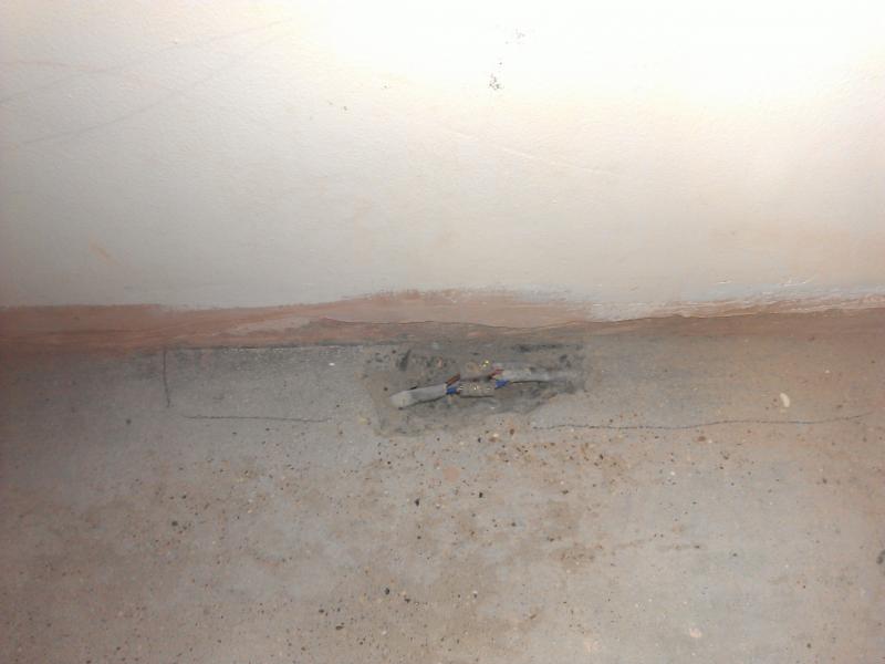

It turns out the cable damage was in the floor of the WC on the other side of the wall, not the main room. This is the link off the ring main in the kitchen to the workshop conversion. (The WC and adjoining hallway is all part and parcel of the conversion). It looks like the carpenter was drilling holes to fit the boxing into and he's gone right through it. There is a temporary solution in place so he has power to finish the job.
Now, to avoid a dangerous situation in case of a spillage (which is quite likely at some point it being the location it is) the solution has to be 100% waterproof. What do you think would be the prudent solution that I should insist on? Are there any regulations (or reasonable interpretation of) regarding wiring underfloor to a WC?
Hardly good practice to bury an unprotected cable so shallow, and in a place so vulnerable to get damaged. In an ordinary room, a carpet gripper could be nailed here - in this case a boxing is being fixed here.
You could dig out a bit more of the cable at both ends, cut the damaged bit, and fit two junction boxes with a short piece of cable in the middle.
The junction boxes would be placed into the boxing. Maintenance free junction boxes, as it looks like they will be unaccessible.
Just noticed your insistence on waterproofness, I suppose weather proof enclosures would satisfy that requirement.
