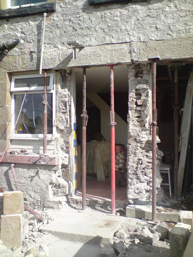

We're currently having the position of an external door and window into our kitchen 'swapped' to provide a final exit from the stair to satisfy building regs for a loft conversion. The builders started work on Wednesday morning. When my wife returned home in the evening she just happened to meet the builder at the end of our road where he said he was waiting for her to return (seemed a bit odd? waiting at the end of the road?). She said she'd see them in the morning and then went to the back of the house to see they'd left the house as shown in this pitcure-
. Bearing in mind we're still using the kitchen and bathroom in the house and the house still has 90% of our belongings inside we were astonished that they had left the house open like this. It was also raining at the time.

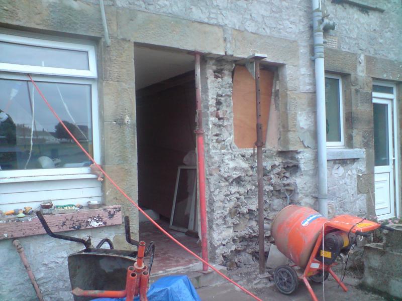

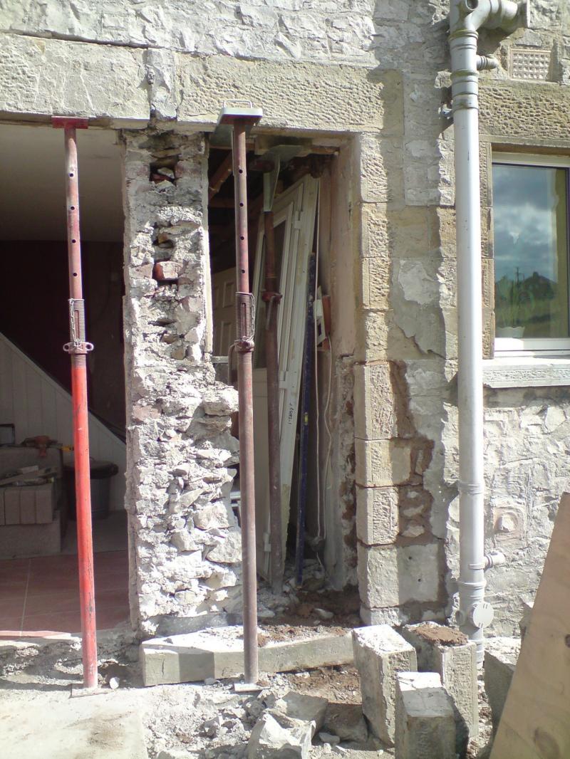

Thursday was much the same when we returned to find the house looking like this -
We spoke to them and they said there was nothing else they could do. We understand it is difficult to board up in this situation but the fact that they just left the house like this without even phoning us to tell us they were going, to check what time we were returning or to tell us that again they had been unable to secure the house. (they had not asked us to be back by a certain time and we undestood they worked until 5pm but our neighbours tell us they left soon after 4pm).
We feel that this is totally unacceptable but are a little cautious at approaching them for fear they'll say they don't want to finish the work and leave us with a big hole in the side of our house and therefore a big problem!!! I'm sure it wouldn't have been too tricky to even lean a piece of wood up against the props or fasten up a tarp so it wasn't so obvious the house was open - there was even a piece of 8' x 4' sheathing ply just off the picture that they could have used!!! They did however manage to take all their tools upstairs and cover them with some sheets - presumably in the hope they didn't get stolen!!!

They are legally liable if they leave your house insecure. A bit of a temporary ply door shouldn't be too difficult for them.
Firstly, get them removed from your approved list. If you need to pass your expereince to someone at your firm who manages the list then do so today. Then write to the company and expain why they are no longer approved.
Also if they are on any other local council or trades list, do the same.
Then demand that the property is left secure and that if they dont do it, then you will call out a 24hr company to do it for them and recharge the costs to them. An you don't want a token board either you want a proper frame and openable entrance/exit if need be

My problem with tackling them about this is that we have a 2yr old son and my wife is 8 months pregnant so i cannot afford the time if they decide they're gonna cut their losses and walk off - we live in the countryside and finding builders at short notice is not easy. I'd rather let them finish the work and then confront them when it comes to paying them. They tell me that the central pillar which can be seen on the pictures is a bit precarious and they didn't want to drill into this when fixing boards in case it weakened it further. I just need to know whether what they are telling me is valid or not as my instinct from the limited experience i have is that the situation is disgusting but before i go jumping in with two feet i wanted to ensure i was in the right.
I propped up some old internal doors on the inside and fixed a plywood sheet roughly outside and whilst this isn't exactly secure it is far better than what they left and took me all of 10minutes.

The two central props are standing on the concrete doorstep. the one on the right is on top of a small limestone plinth that runs along the front of the house. This one does look a bit dodgy on the photo but from memory i can't remember thinking it looked precarious on site? Think it may be an opitcal illusion!!
irresponsible monkeys.
we often have to complete the knock-through into a new extension, prior to the windows going in.
this always means buying some 18mm hoarding ply and securing the building until the windows are fitted.
we either screw them to the wall with washers over the screw heads or use acros and planks along with the ply boards.
