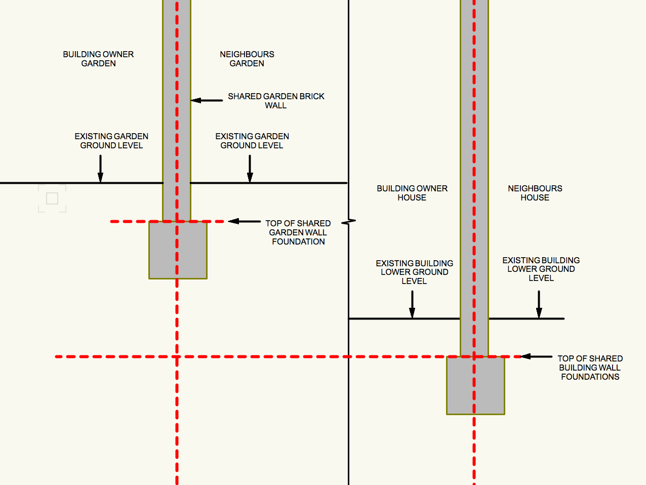

My garden is at 2 levels.
So I would like to excavate an area at the lower level to give me a patio at the same level as my living room.
I don't know how deep the foundations below the existing garden wall are but the new retaining wall I want to put in is about 700mm away from the boundary wall line.
Appreciate any advice on what I need to do before I start any work!!

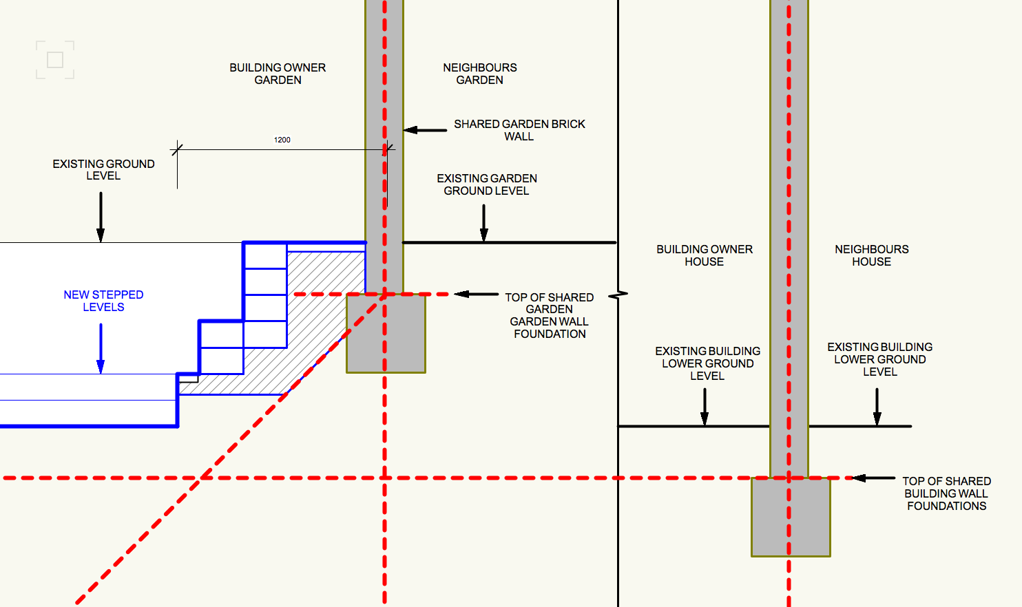

I think if you take a 45 degree angle from the centre line of the top of the pile / foundation, into your garden, then any area below the lines is party wall notice.......
As I do not want to service any party wall notices I have redesigned my garden so it steps away from the wall at a 45 degree angle!!
It depends on the distance.
If the work is within 3m of the neighbour wall then its simply going below
If its over 3M and under 6M then the 45 degree rule applies

The garden boundary wall is at a much higher level than any shared building foundations, walls etc.
Can I build some sleeper walls that step away from the shared garden boundary wall in a way that doesn't require a party wall agreement!
I've attached a before and after sketch.

Just to add that no new foundations are being proposed adjacent to the existing garden wall foundations. Just bedding for the railways sleepers.

I checked with a party wall surveyor.....it's a party garden fence notice to adjoining neighbour.
So unfortunately a 3m notice needed ...
