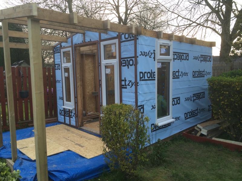

That was my project this time last year, here's some pics.
I can give you a run down on the how to.... materials and costs etc, or any specifics.

The summer house walls were constructed from 125x50mm off the saw red pine at 5.4m lengths.
The floor was 9x2" @ 450mm centres.
Roof 5x2" @ 600 centres.
The floor joists were laid on concrete pads around a metre apart throughout the footprint of the shed...DPC on top of the pads before laying the joists.

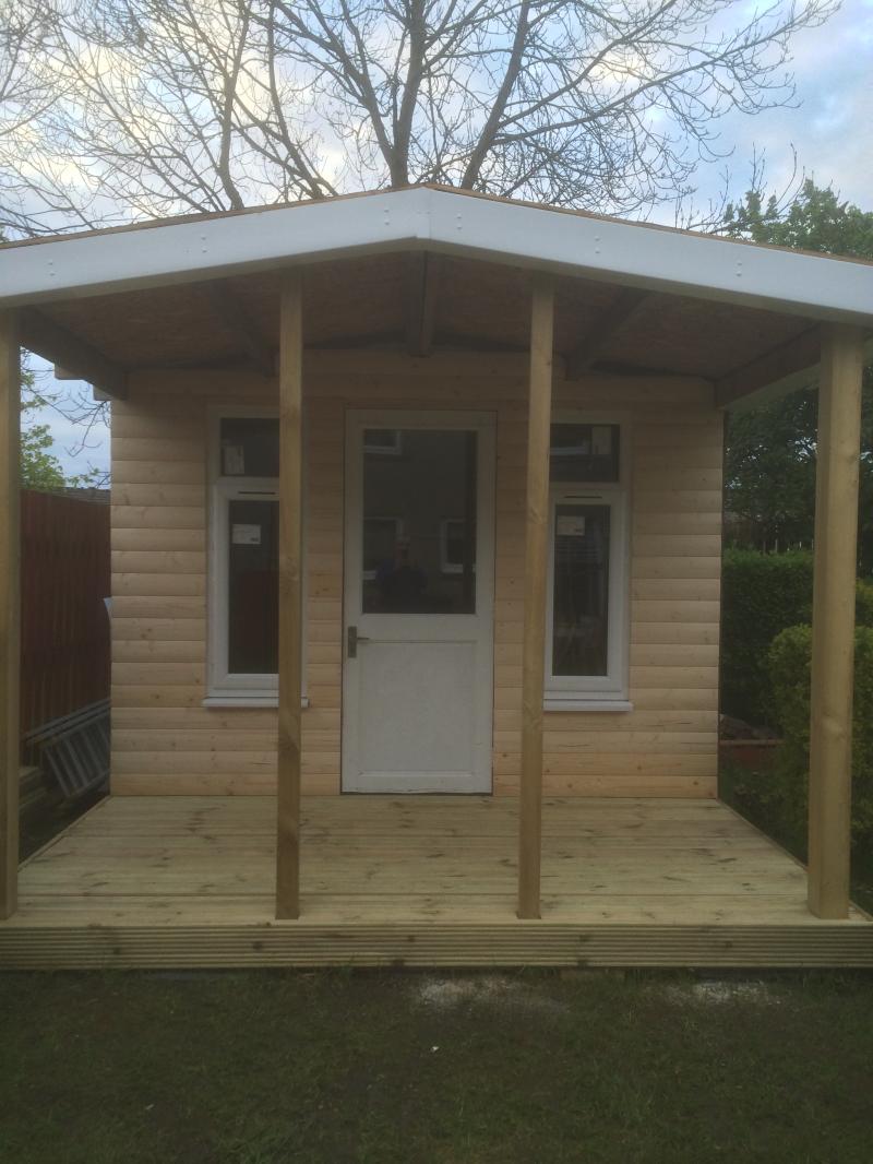

I made the shed the same size as the lengths of 5x2, the shed being around 3.4m in length and veranda 2m.
Once the floor joists were laid i built the framing for the walls, on the outside of the frame is 9mm osb plywood then builders paper (breathable membrane) then vertical straps every 450mm to which the log lap cladding is fixed.
The inside is insulated with 150mm rockwool between the studs then 500 guage vapour barrier is fixed (plastic sheet) and 12.5mm gyproc to complete.
The roof i formed myself and plated together using various cramping plates and truss clips. there are many ways to construct a roof depending on the pitch and type of roof covering. The problem with building summerhouses is the restricted heights we are allowed to go to.
That roof is 2.4m to the ridge giving a pitch of 11 degrees (which is not enough for tiles) but i torched on felt beneath the tiles and that is the waterproof layer..the tiles are aesthetic.

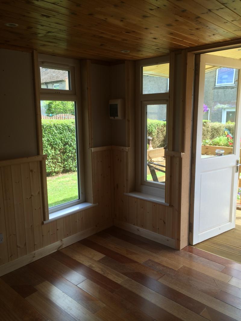

The space between the ceiling and roof is stuffed with rockwool.
The floor is netted, and again rockwool between floor joists, then 18mm wbp plywood, insulation pads on top of ply then 18mm hardwood flooring.
The lower half of the inside of the shed was lined with channel lining on top of horizontal straps.
The Electrics were taken from the house consumer unit and run through 16mm armoured cable the 11 metres to the shed and into a consumer unit.
Tere is 3 circuits..one for lights...sockets and a seperate fuse for a 1500 watt panel heater.

Veranda was done in decking...approx £100.00

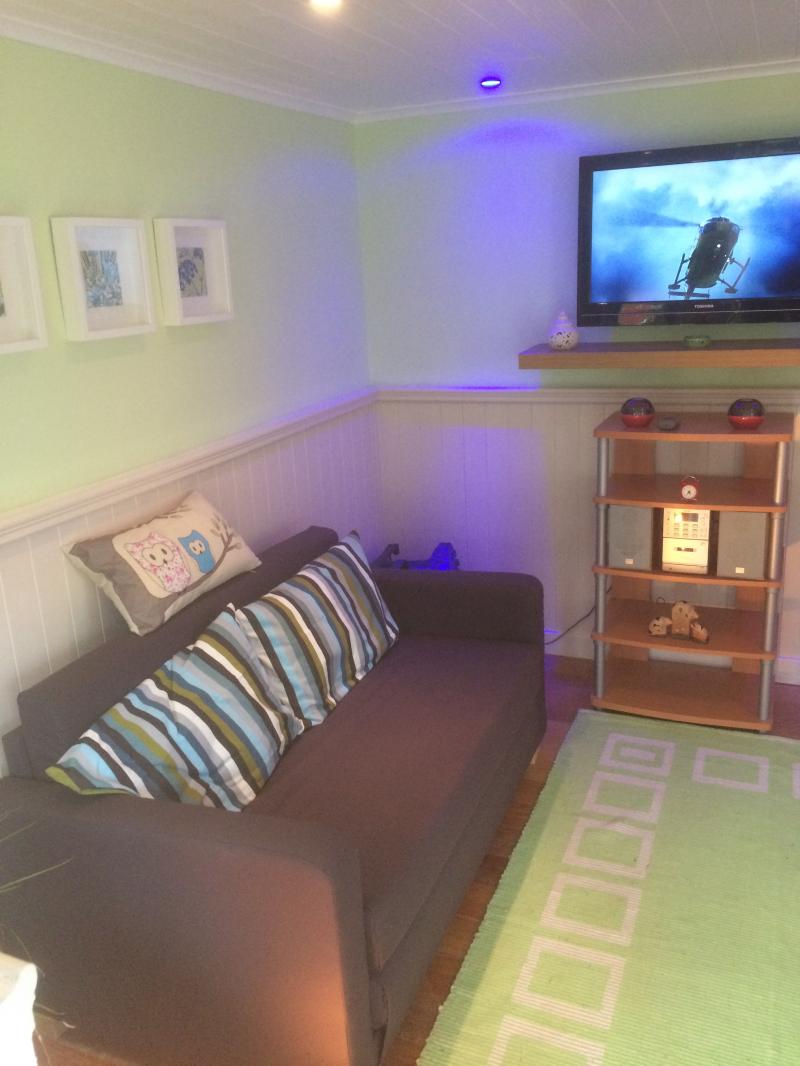

The rest of the expense was the lighting, flooring, underside of canopy and lining the ceiling, paint and preservative.
I used to come in from my work and do a couple of hours every night so took around 5 months lol.
Its a great wee space for us to sit in the summer with the door open with a cup of tea.
