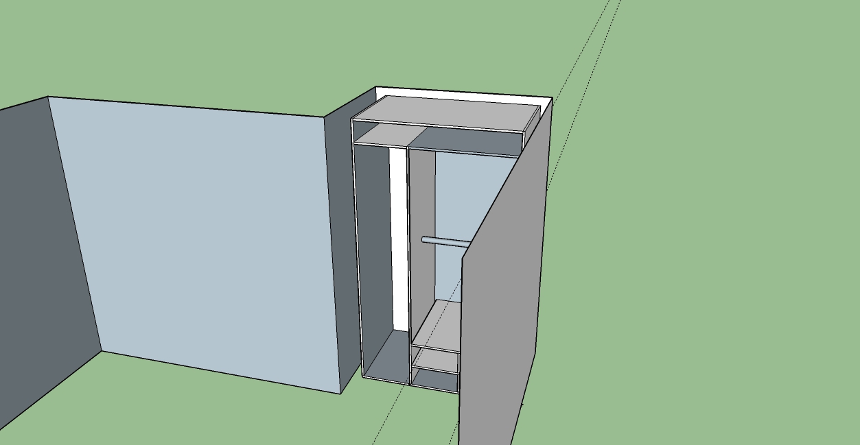

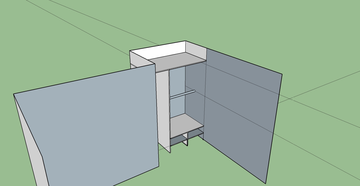

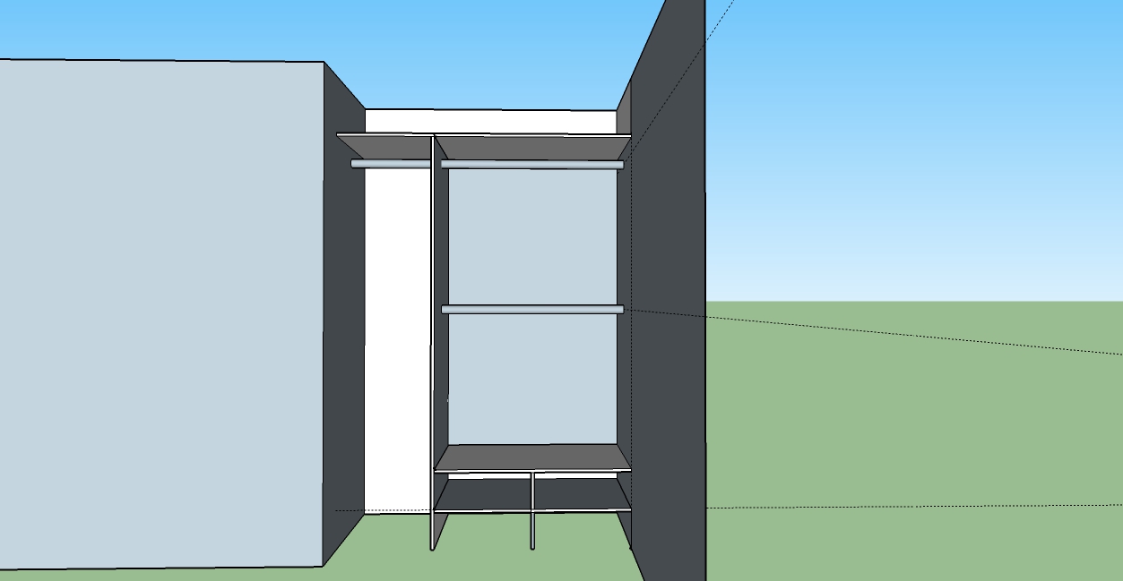

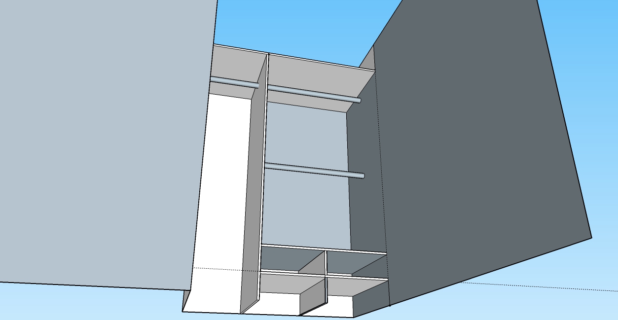

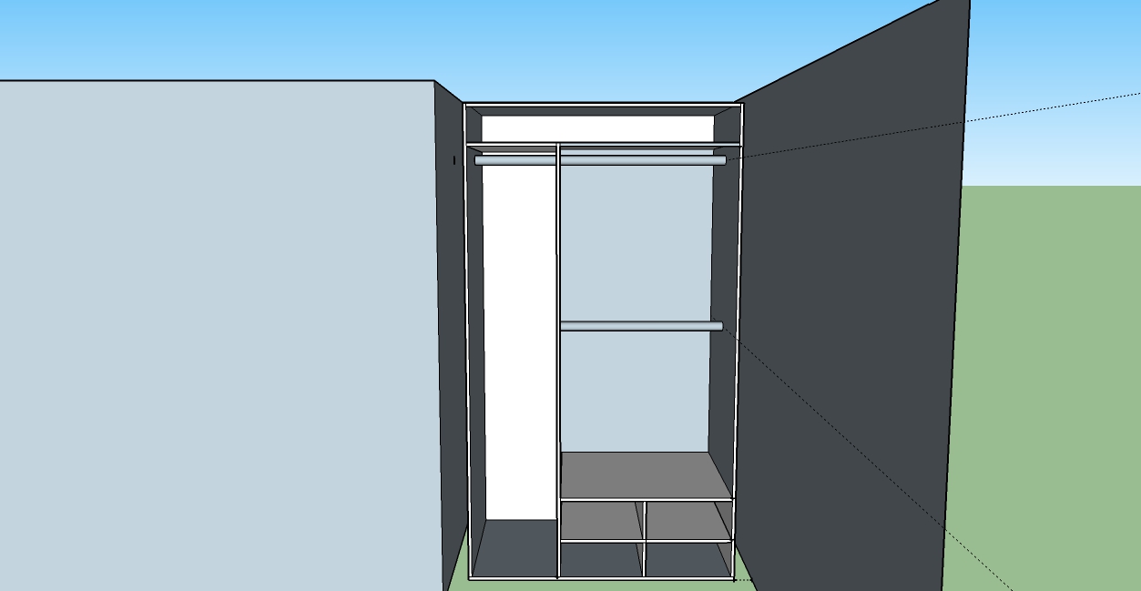

Am building a decent sized wardrobe in an alcove. Space is 900 deep x 1665 wide x 2670 tall with existing carpet in place.
From what i can tell looking online there are a number of ways it can be done.
Client doesn't want anything fancy and are trying to save a bit of money by painting it themselves, so decorative trims, and unnecessary timber facing is not required.
They have specified the internal design (see attached image), so it's just a case of deciding how to put it together.

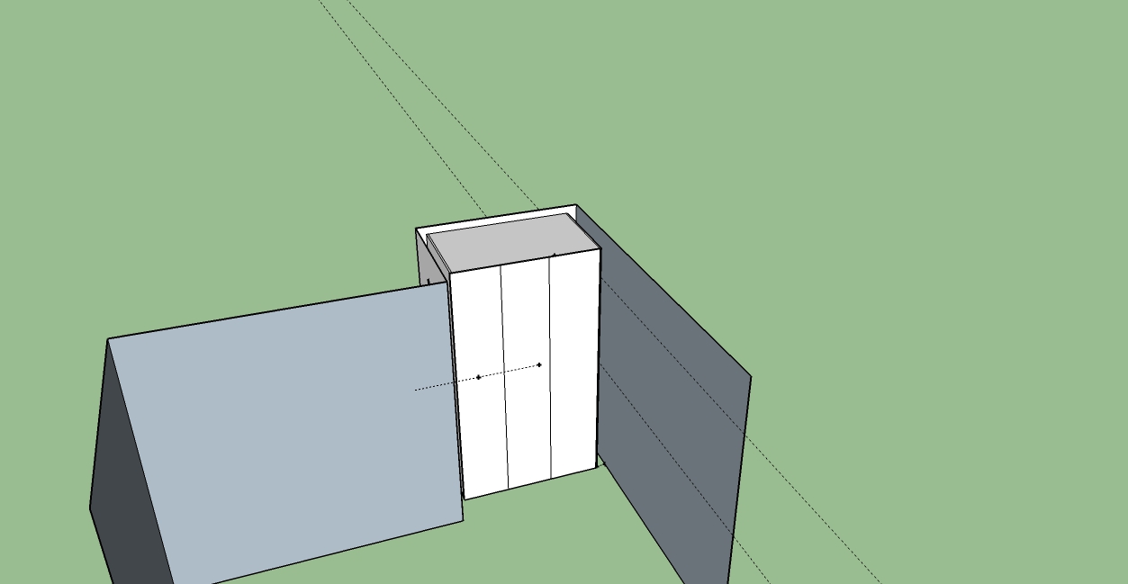

So I believe I can either A) build one single skin carcass and then put a trim around the edge of say 100mm
B) just build the shelves and divider separately without a carcass and then add the trim and doors, or C) build a carcass out of 3 separate boxes.
I intend to build it of 18mm mdf. The front will have three doors, the first finishing at the left hand divider
And secondly, the question is whether I build it onto a base (if I build a carcass) or directly onto the carpet, or cut out the carpet. Not sure I entirely understand the reason for a base. If it's uneven underneath either on floorboards or carper, surely I can just pack it level.
Thirdly is it worth putting a back on it?

Needs to sit on a plinth or doors will catch on the carpet and you have to stand back when opening as doors would normally pass over your feet. Also looks strange with doors to floor.100 mm seems a lot of space to waste with trim.?
If it is built in, why bother with back and sides at all? All you need is a frame to hang the doors and any shelving. Doors might work as sliding doors on rails, depending on layout. I made my built-in 35 years ago, 14 feet wide, 6 sliding doors on rails, with 3x large cupboards above.

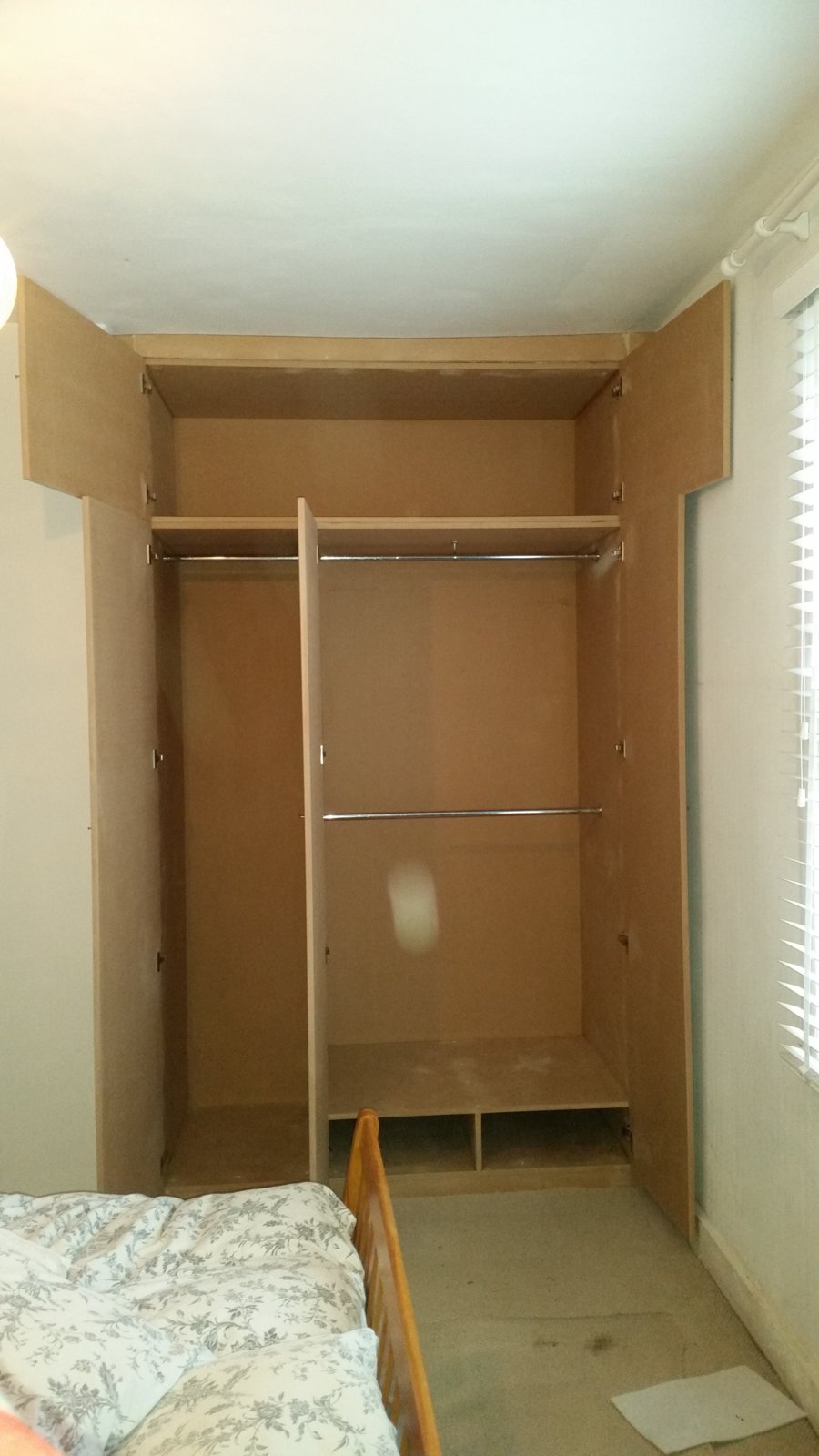

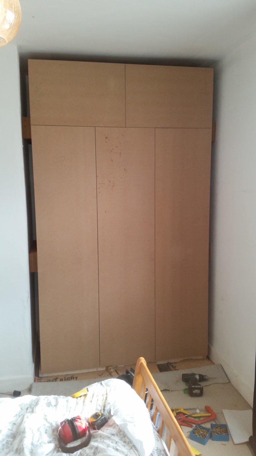

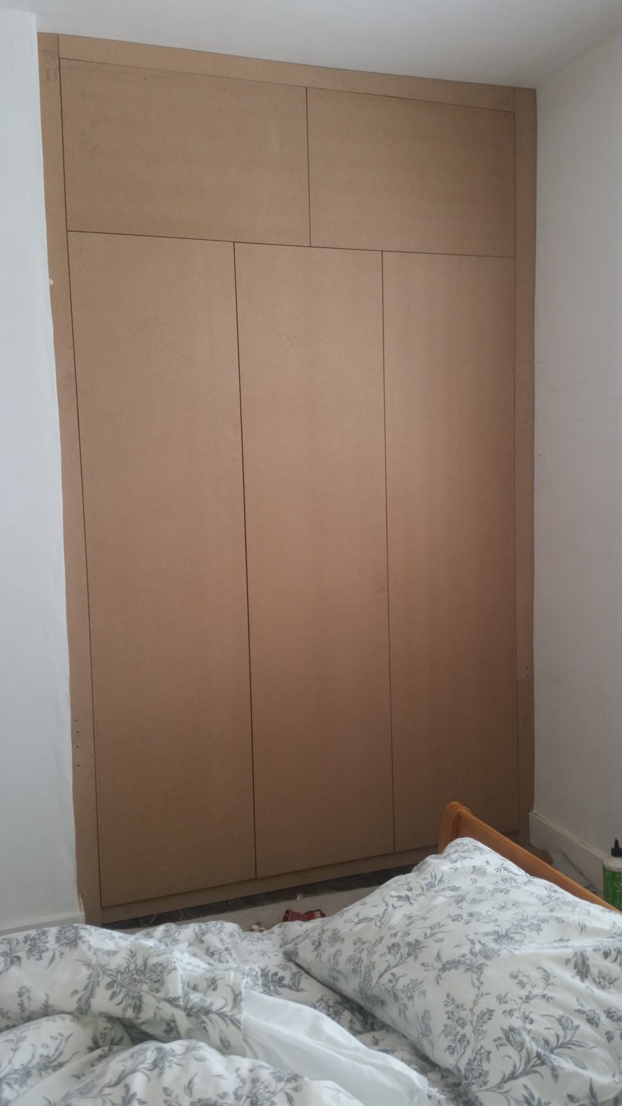

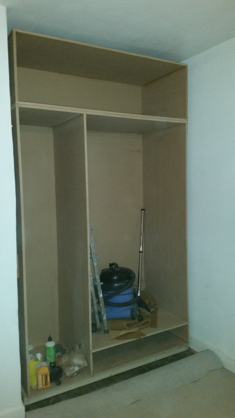

The project is finished so just thought I would provide some feedback from what I've learned encase anyone else tackles this for the first time.
So it is clear from the comments above that there are multiple ways of doing this. And more importantly, there is no one "right" way to do it, so long as it is accurate and strong.
How I built mine:
1) Choose design -

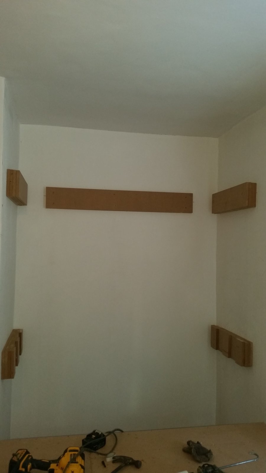

A) Build the shelves and dividers using battens on the wall to support them. Then build a frame at the front to hang the doors the trim pieces off of. Guessing you would need to switch to a folding sliding door system on a rail, or floor & ceiling pivot hinges.
B) Build a carcass either fixed to the floorboards, or on a base, with doors attached to the carcass, and infill pieces attached to the carcass. The top unit is a separate box. Makes life easier.
I chose the carcass method, with overlayed doors to hide the carcass edges.

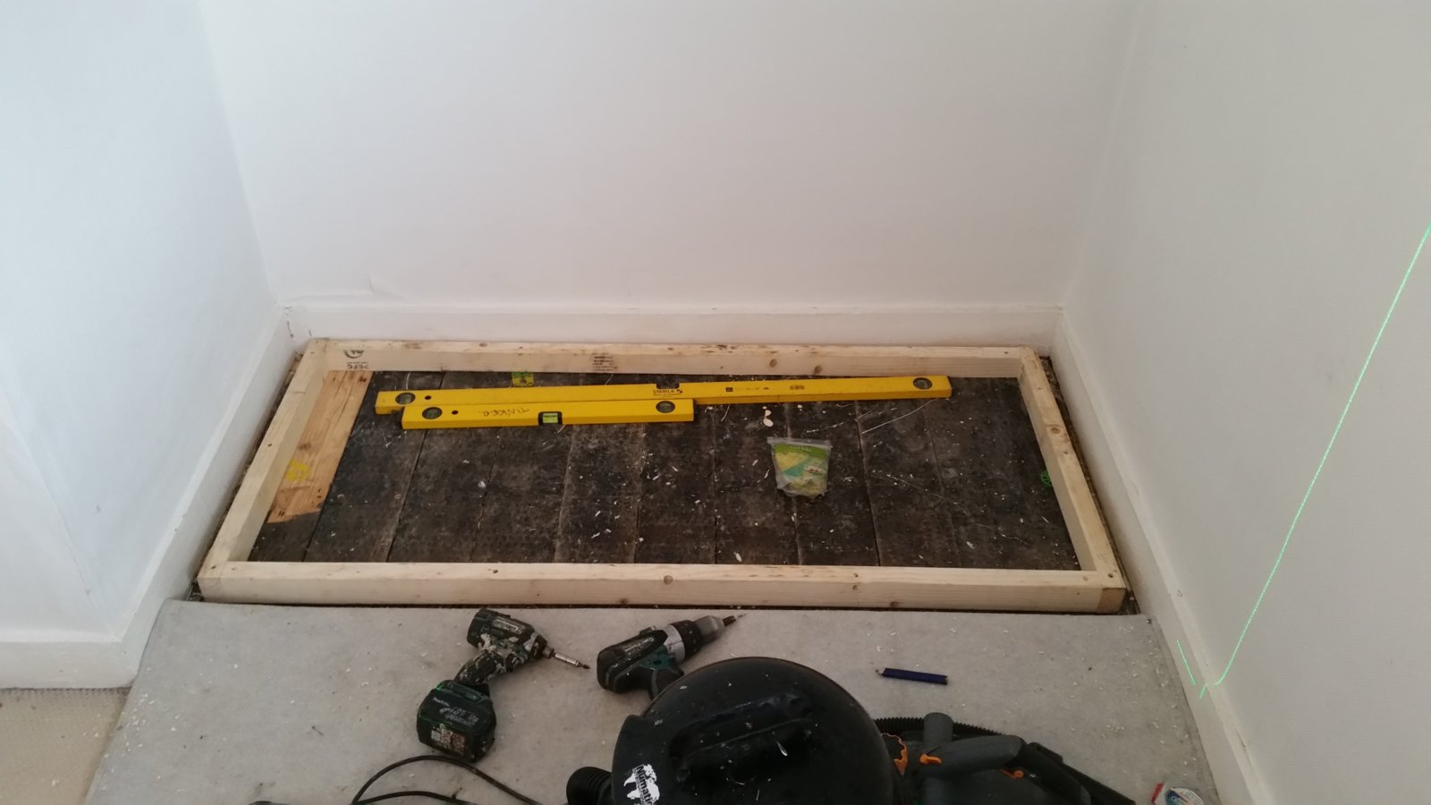

4) Check for pipe work under floor - If you're confident enough to take a risk be my guest, but I had to take the time to check for pipes. In these old houses, pipes were often laid at the top of a joist right under the floorboards.
5) Build & level base - Given that I was really tight on height because shoe storage at the bottom was taking up height in the double railed wardrobe, I wanted to consider levelling the carcass on carpet. There are many advantages to building a base, including: Doors won't potentially drag on carpet, easier to level a base than a carcass, can inspect for pipes, and super solid. So I went with some 2 x 3" CLS timber and just about got away with the height. Floor was totally skewiff, so needed a lot of packing and planing. I also had to install inner cross members since the wardrobe seemed to need central support, not just at the edges.
6) Decide on cutting location - I was cutting in the garden and assembling in the bedroom. This is very tiring and takes much longer. I should have asked the client to completely clear the bedroom or factor it into the cost.
7) Prime - Had I been painting it, I would have probably primed the unit at this stage

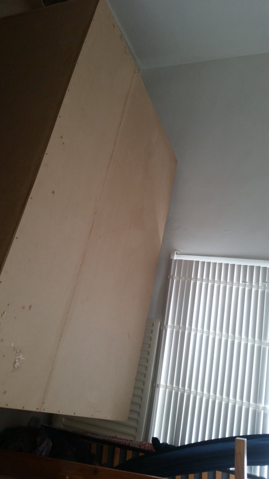

8) Build carcass of main wardrobe & square up on floor - I had a show shelf and decided to dado joint it, so now is the time to cut the dado. I then assembled and fixed the carcass on bedroom floor, then squared up, fitted back, then stood into place. I must have used a screw every 200mm, but this is probably overkill. Squaring up in the odd shaped alcove, I measure the gaps on sides and at back for packing material.
9) Fit mdf packing - I had initially thought to install some solid timber to the wall, but there was a lot of MDF offcuts. Removed carcass. Cut MDF to size, stacked on top of one another, and fixed to wall, filling the gap to within 5mm or so of the carcass. Replaced carcass, and fitted packers in gaps. Fixed wall of carcass to packers.
I went a bit nuts on making sure the whole thing was super solid, after the client commented that her son liked hiding in wardrobes. But no harm in that.

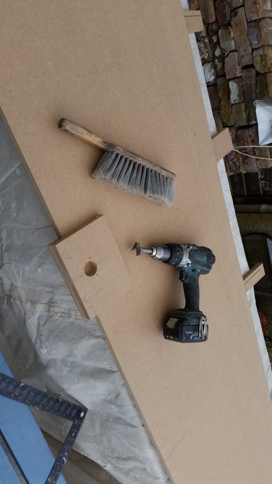

10) Cut & fit doors & hinges - Made a jig, made hole cutting process much faster. Blum recommended 5 hinges for 2m door, but this seemed overkill, and I've even seen 3 on a door that size which has lasted 20 years, so I opted for 4. Outer doors used overlay hinges, and central one half overlay.
11) Cut & fit infill panels - L-shaped method as mentioned on here before. Another good used of offcuts. But quite fiddly and time consuming. Walls were totally out so needed a lot of scribing. Had to make a join low down out of eyesight due to the total size being longer than a single sheet 2440mm. Did a bevel joint, glued and nailed with a supporting brace behind.
12) Fit infill piece at base & gripper rod & carpet - To cover the timber base I had to fit a covering infill piece under the unit. Then refit the gripper rod and carpet.
13) Fill & sand screw and nail heads - I used a lot of nails and screws to make it super solid, so this took me some time to do.
14) Fit shoe shelf - Now is the time to install the shoe shelf. Otherwise you make it really difficult to get fixings in the base.
15) Sand down all edges to take off sharpness
16) Paint - I could also prime the unit at this stage, but certainly I would be painting it now.
17) Fit clothes rails - The position of this took me some time to figure out. Typically they are 1.8 - 2m from the floor. Each rail needs ideally at least 750 - 900mm. But I was trying to fit in a 180mm shoe store too. Ended up at 2m exactly with an 80mm gap to shelf, giving me 845mm between rails.
17) Fit handles
18) Tidy up

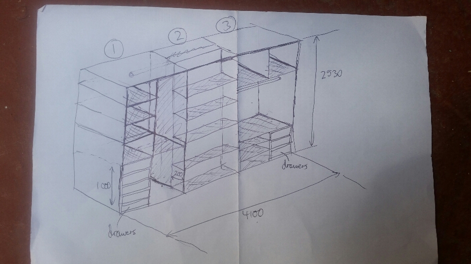

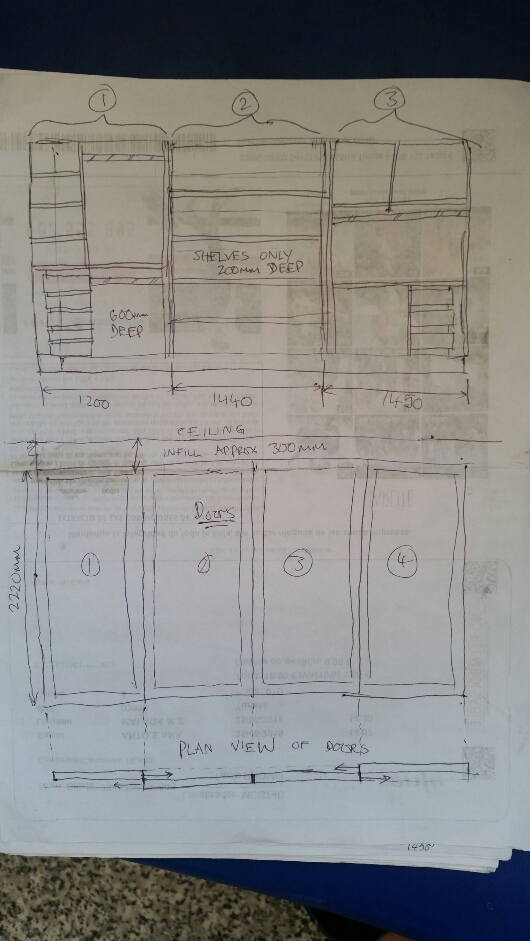

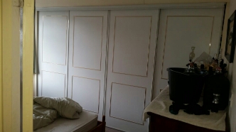

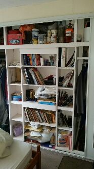

This time the wardrobe is a bit more complex so I do have some more questions.
So the first wardrobe I wrote about in this post was a single plain mdf, to be primed and painted.
This new one is a 3 part wardrobe, surrounding the chimney breast. The design hasn't been finalised but at present I am proposing 3 carcasses with inbuilt shelves and drawers, and a separate frame with 4 of the largest sliding door kits I. e. 2220 x 914mm per door. Room is 4100 x 2530mm so will have infill panels at top and sides.
Given that the carcasses will be about 600mm deep, the central one on the face of the chimney breast will be more of a bookshelf i.e. only 200mm deep. Much like the attached images.
The client seems to want mdf veneer, probably just beech, and presumably something different for the doors.
So two questions. Firstly i just want your opinions on how you would approach / assemble this to give me some ideas.
