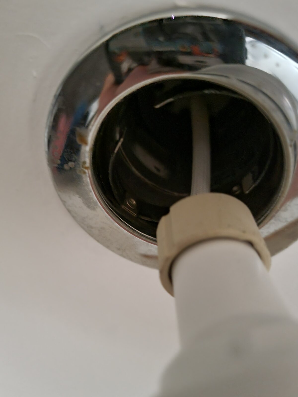

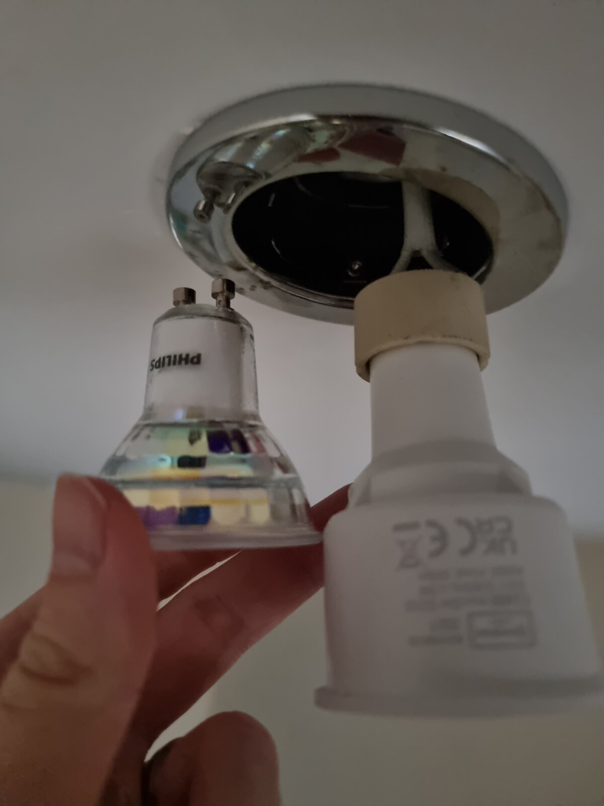

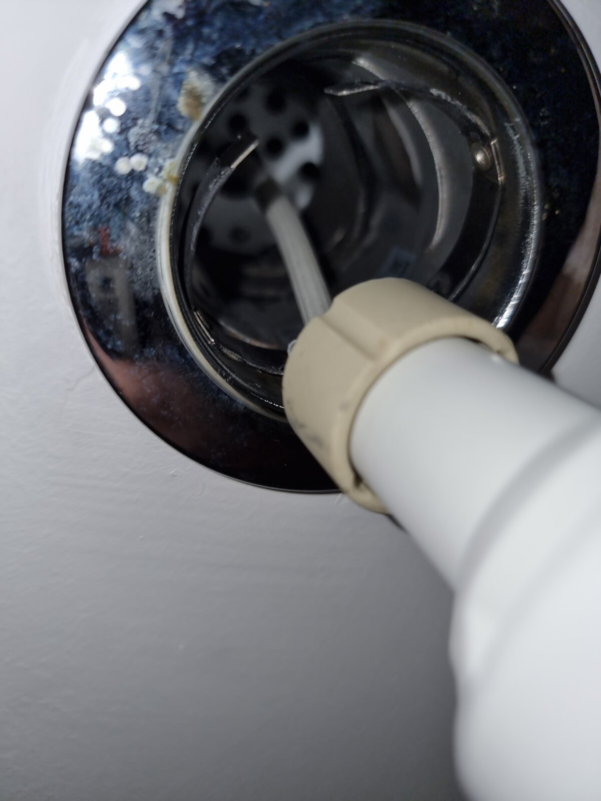

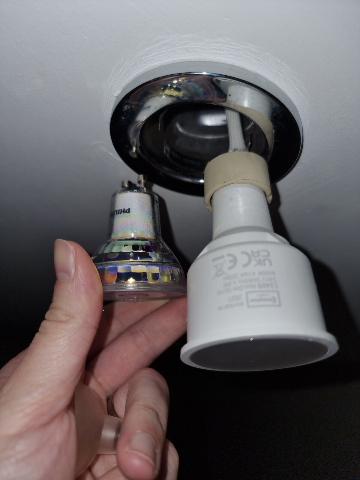

I'm at my wits end with these downlights. I finally cracked how to get the bulbs out (literally brute force pull them down somehow, no twisting here sadly) and went to replace them with some decent bulbs to find that the new bulbs just slip straight out. Am I being a moron and are these downlights designed for a specific bulb type? The socket is obviously GU10 but I can't figure out why a 'standard' GU10 bulb just flops itself back out... very frustrating

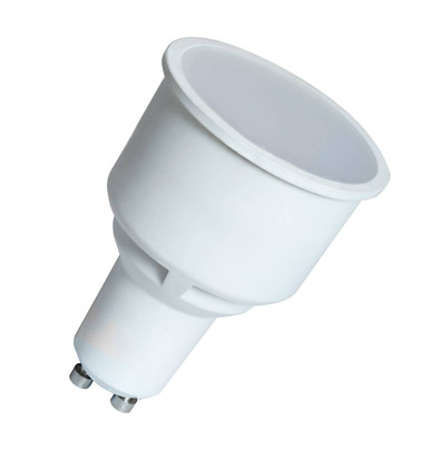

You really have 2 optiond
1. Buy some of these

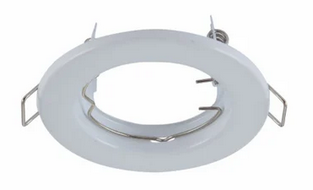

The conversion from tungsten to compact fluorescent resulted in a longer bulb, to get these to fit some sort of conversion was required, or they would stick out of the holder, in your case it seems a spring clamp to grip the barrel of the bulb, so as @Murdochcat has shown, there are also surrounds with circlips 1719658713629.png which I found here but may be easier just to swap the lights.
Thanks both, yeah in my old place we had what I would deem the 'nice' ones where you just twist the inner bezel and it popped out. These are just plain awful because sometimes there's not even a gap between the bezel and the light so getting something up behind them is a pain!
I think for now I'll just shell out the extortionate cost for the 'fatter' bulbs, I think long term plan though will be to replace all my downlights with normal ones.
