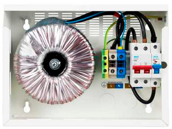

As we get more and more LED lights we are also reducing the number of tungsten which may have damped out surges?

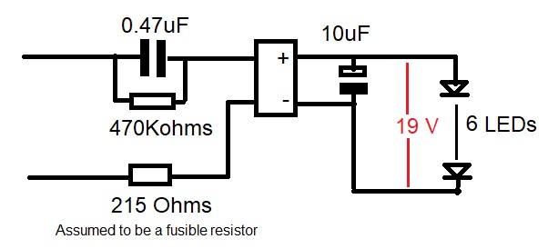

The inrush current of a 1 Watt LED golf ball is surprisingly high and may have been the cause of problems with the village Christmas lights.
They are festoons of between 100 and 200 lamps
The normal running current per 1 Watt lamp is 4.4mA
So a festoon of 200 lamps running normally is approximately 0.9 Amps
So we were surprised to find 6 Amp and 10 Amp fuses were blowing on two of the festoons
After some further investigation and modifications to the power supply boxes we have found that a fault in the festoon cable and/or lamp holders is the most probable cause of the fuses blowing. Out of 8 festoons only two of them are blowing fuses.
That said the inrush current is significant, both in current and duration. These are extracts from e-mails with the manufacturer
After a conversation with our engineering team, please note that our **** lamps have a 33mA of inrush current.
For a 200 lamps festoon, you will need a minimum of 7 Amp fuse.
Please note that the inrush current in the LED lamps can go up to 10 times of the standard current value.
Thank you for coming back to us.
The inrush current lasts for about 10ms, but it takes between 40--50 cycles for the current to stabilize to the normal operating value.

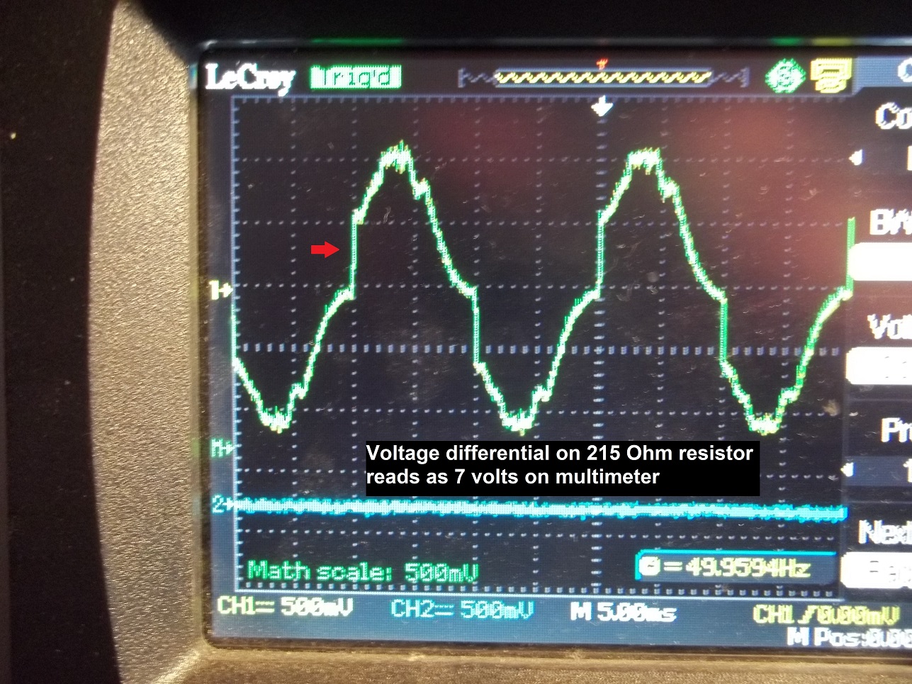

The joys horrors of measuring current into an LED lamp. :evil:
Differential measuring across the lamp's 215 Ohm fusible resistor in series in the Neutral enable one to calculate the current flowing
Peak to peak on the scope is 20 Volts ( probes are 1:10 ) and the RMS voltmeter reads the voltage as 7 Volts RMS which suggests the current is about 32 mA.
( I = V / R = 7 V / 215 = 0.032Amp )
The rated current for the lamp is 4mA for the 1 Watt power which does compute 230 V x 4 mA = 0.92 Watt
4 mA or 32 mA ?
The simple RMS calculations cannot be used as the load is a capacitive load and calculations are only valid for a small part of the wave form
