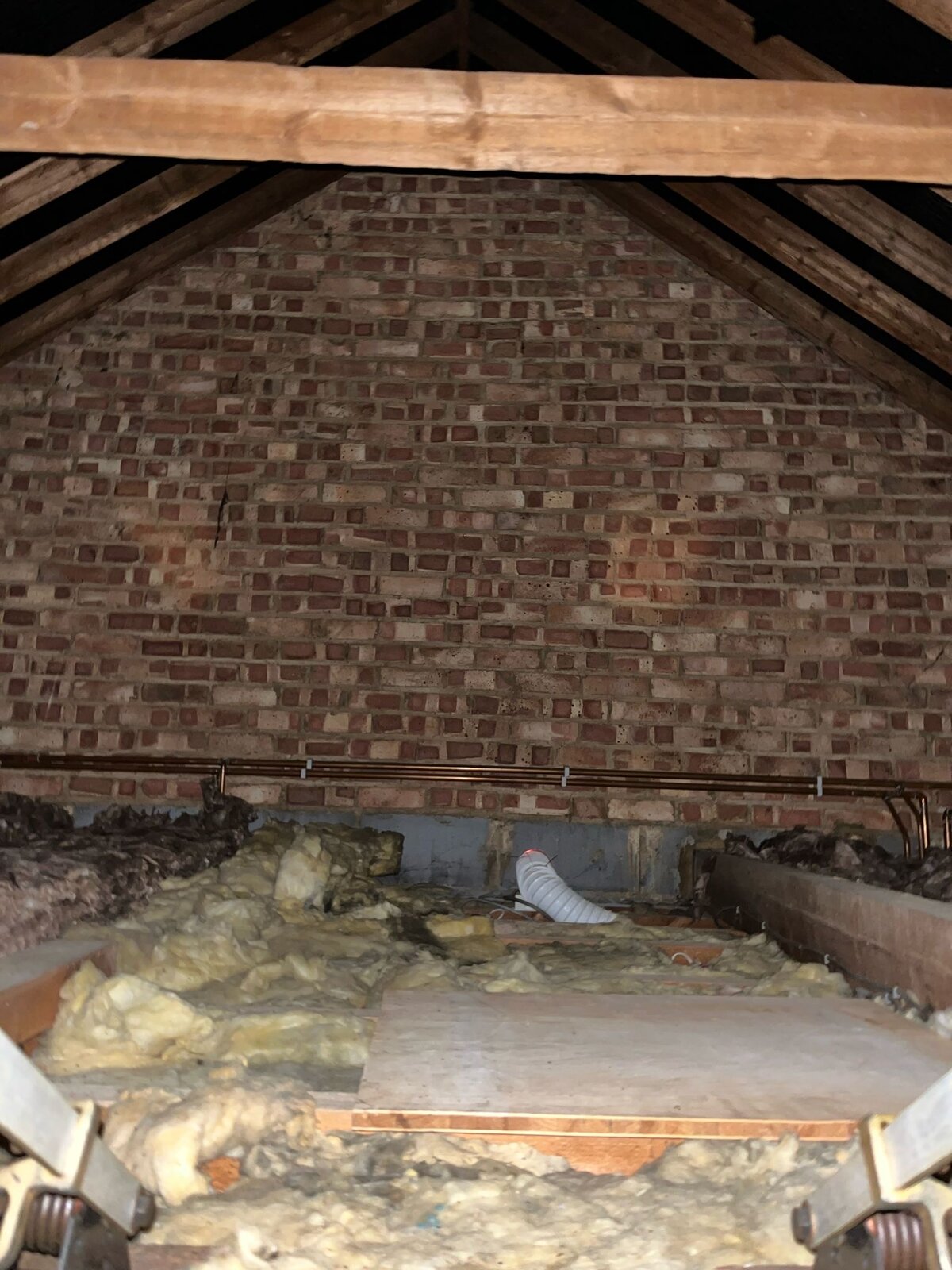

Loft height is about 2.6m guess (32 red brick courses and 1 concrete block course high) 12m gable to gable and front to back 8m.

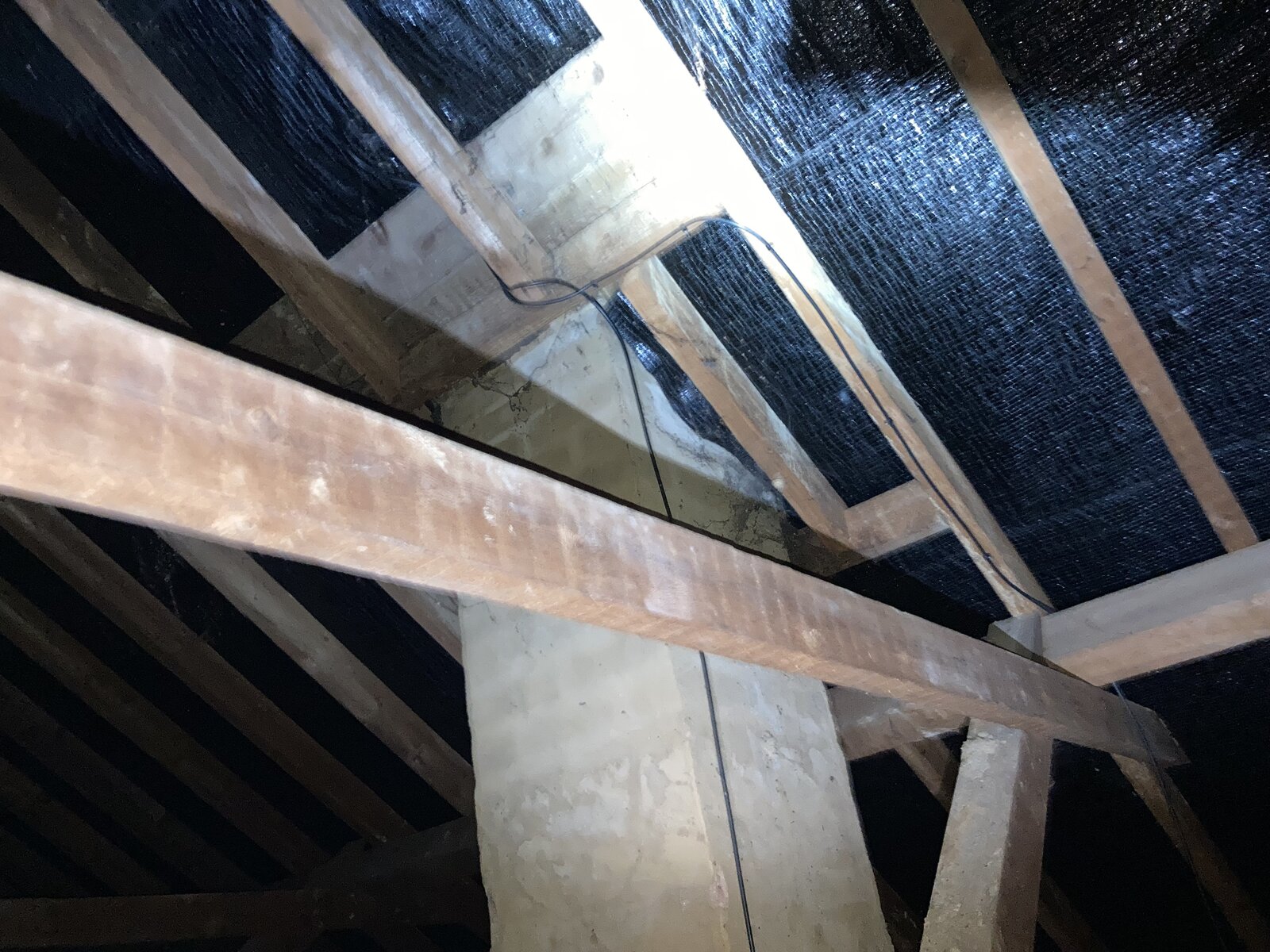

A couple of steel beams located parallel and under the purlins. The stair well will take up some room so needs some clever design to maximise the space.

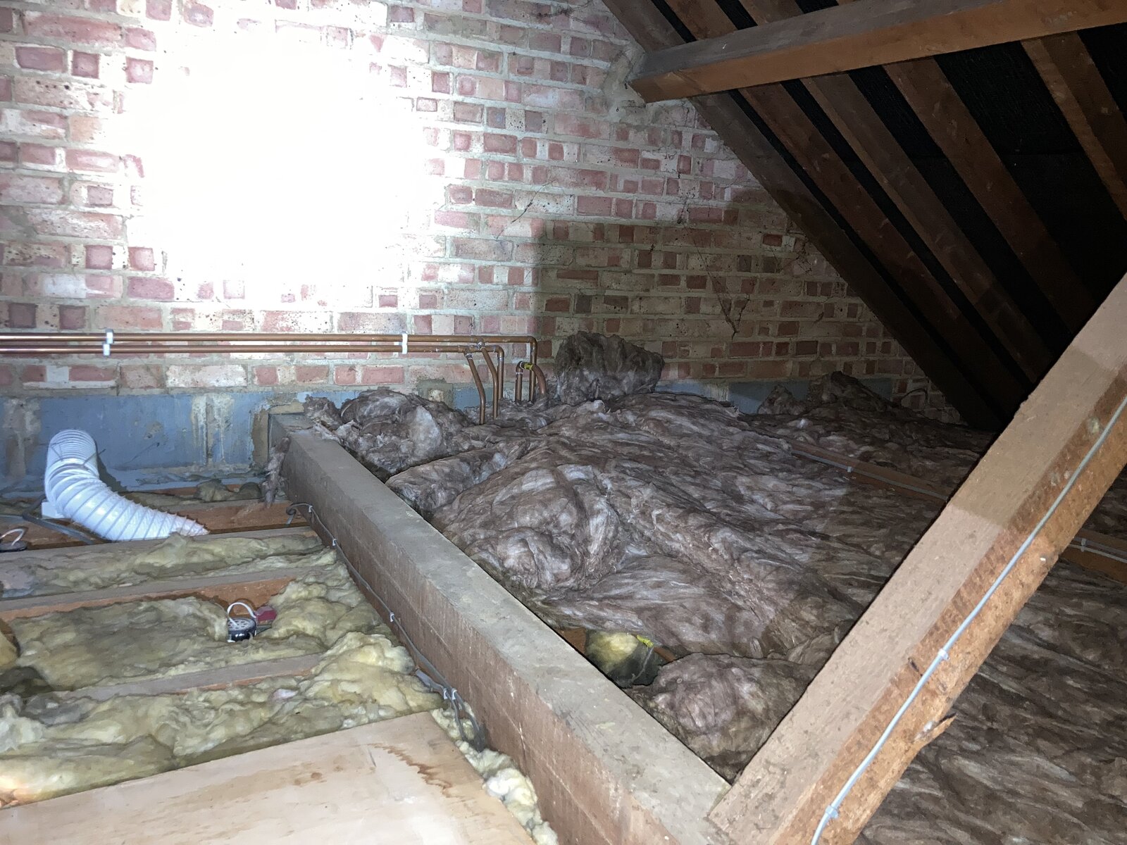

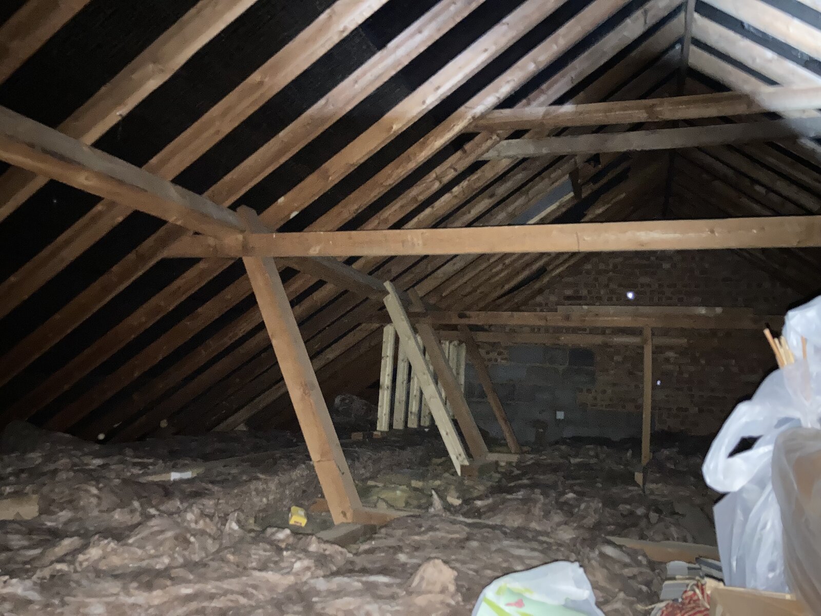

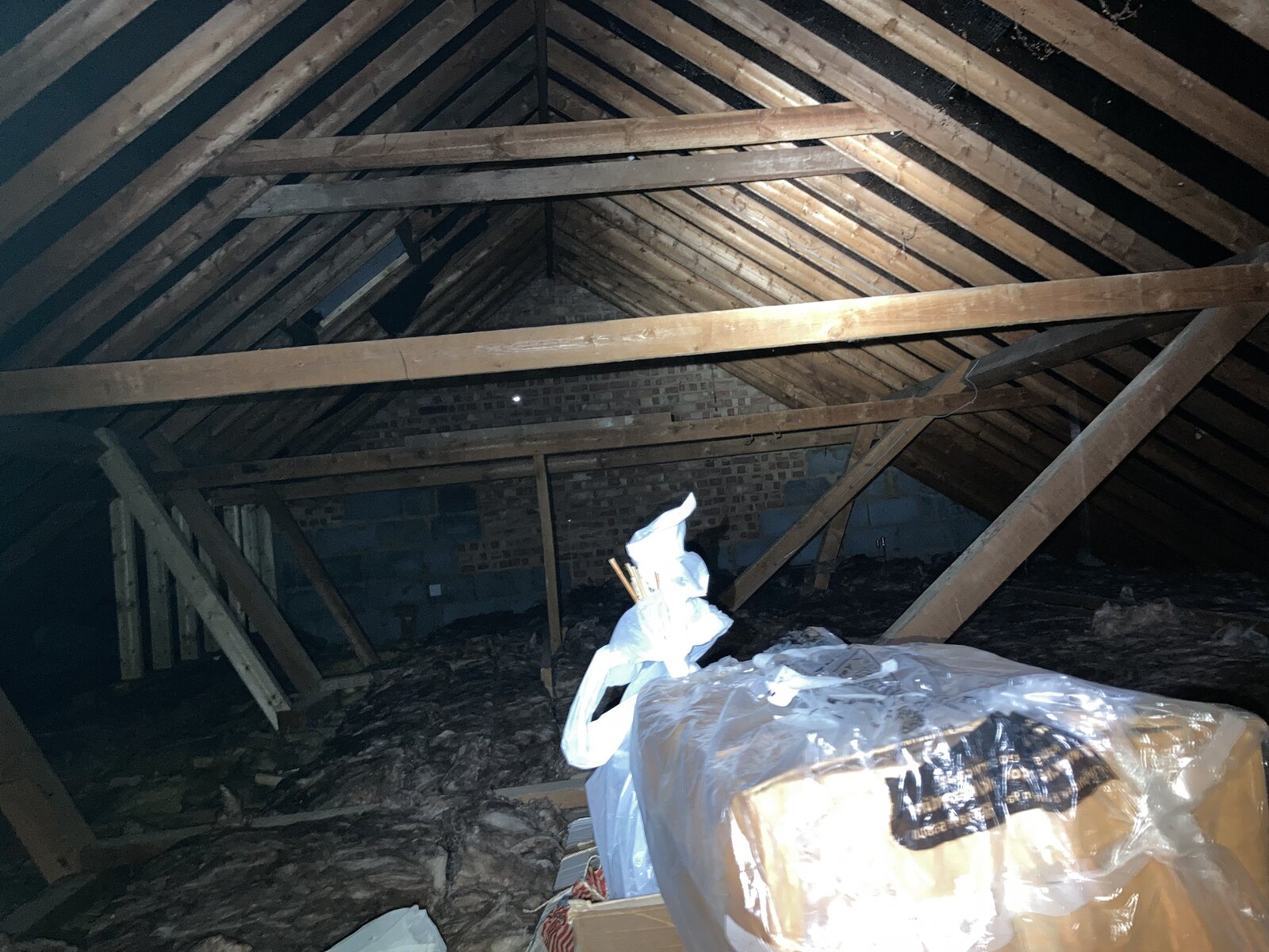

My thoughts (regards steels) are what appears to be the haphazard purlin propping and the removal of, once the loft area is clear. A pair of steels beneath the purlins would be useful in that respect as well as supporting to floor joists.
Thank you!
The new timber propping looks like to support roof where a chimney stack was removed.
So if I understood correctly, these steels will be in the loft space and not below existing ceiling?
How are steels useful if they're not required?
I haven't seen the design, so I can't answer.
Generally, a large open (50m³) roof structure that the OP is proposing, would be difficult without steels unless he's proposing a total re-roof with engineered attic trusses...?
Without actually seeing the GF wall layout, it's difficult to tell. But those hefty ceiling binders and the haphazard purlin propping tells me the GF walls are either scarce or not working favourably.
