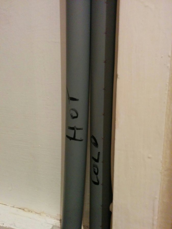

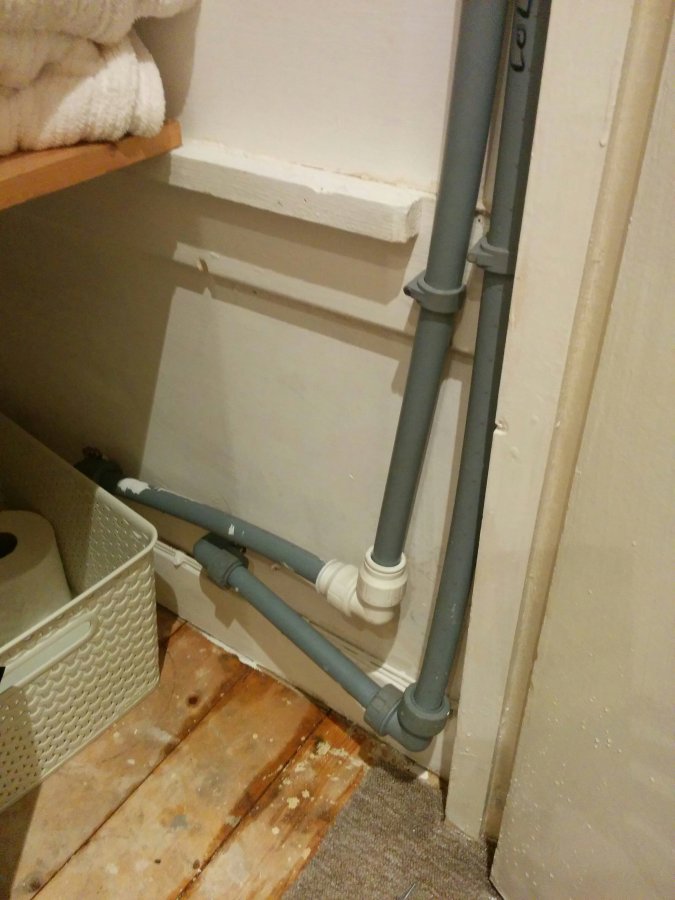

Hi Tony,
See above pipe that burst (the one with the white joined valve is the one he has just repaired) it is marked hot on the pipe and it is upstairs, the combi is now in the kitchen...

It burst between the two joined parts of the hot water pipe which the Plumber has now repaired, I don't have a picture of this sorry.
I am however fearful that this will happen again and plan on turning off the water when I leave the house until I get someone else to look at all of the pipes in the house.
If it was a push fit connection that had popped off then the chances are very high that it was never properly fitted, and the higher pressure and shock from dishwasher solenoid valves closing could have popped it off.

as far as the exploding pipe fitting, I've seen a few dozen pushfit fittings blow off of pipes over the years, every one of them could be proven not to have been fully pushed on or had no inserts in the pipe or been under strain from poor fitting, and going by that picture it looks like it was a bit of a rushed job.
