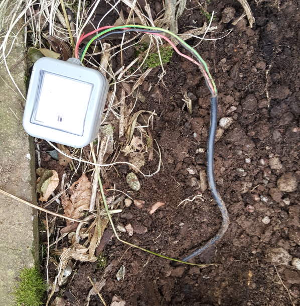

Haven't had a good look at it in a while now, will have to refresh my memory, but it's definitely 3 core. It'll date from the early 90s, yet I seem to remember it's red, black, and green/yellow... that seems like a mixture of the old and new colour codes to me, but what do I know.

Thanks for the fascinating insight into colour schemes! But even then, I have to be different – having had a good look again, mine are red, grey, and green/yellow. Oh well, the red is definitely live, and I can guess what the g/y one is, so…

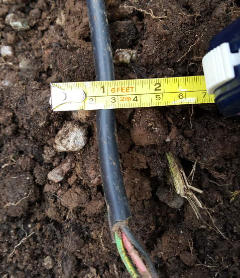

But as always with EVERY DIY job I bring to these hallowed pages, it gets worse and worse… just when I’d familiarised myself with all the procedures and bits and pieces, I discover that the external diameter of my armoured cable is… hard to measure exactly, but I’d say 6 or 7mm FFS – the thinnest SF do is 11.7.

Are you sure its SWA? The smallest SWA available is 12mm diameter on my chart, for 2 core 1.5mm.
1.5mm buried direct is 25A current carrying capacity, according to the book.
Well well... after all that, I think you're right - it isn't. It looks like it, it feels like it (very stiff, hard to cut plastic outer)... but I don't think it has the steel armour.
That leaves me with a quandary, doesn't it. It will have been there since the house was built (1994 I think - I've only been here 3 years), and goes from where you see it, under some flags, about 25' to the house, so I guess in practice it was fairly safe.
Originally it came up through a concrete block to a pedestal kind of light, but the light had all rotted away, so I decided to break the concrete up and expose the cable so that I could do something else (undecided at that point) with the power...
PS just stuck the little socket on the end today as I needed to do some drilling
Is that NYY cable, not the same as SWA but can, I believe, be buried if certain conditions are met.
