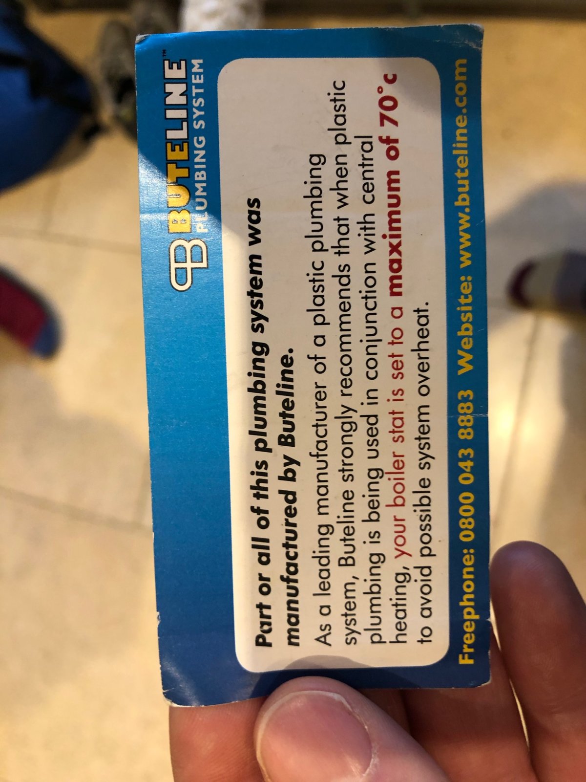

I had Buteline installed in a house rebuild 6 years ago and have experienced no end of problems. Leak after leak after leak. I currently have 4 rooms with big holes in the ceiling and must have repaired 6 others. Buteline claimed it was a crimping installation issue but it’s clearly not. I’ve subsequently talked to several plumbing companies and it turns out the problem is down to Buteline not handling hot water over about 70 degrees. One installer pressure tested to 10 bar no problems at all - put hot water through it and it all starts leaking. Buteline now make it clear that it can’t handle hot water and give you a sticker to put on your boiler to run it at 70 degrees. I’m going to end this nightmare by ripping the whole lot out as it is clearly not fit for purpose...
