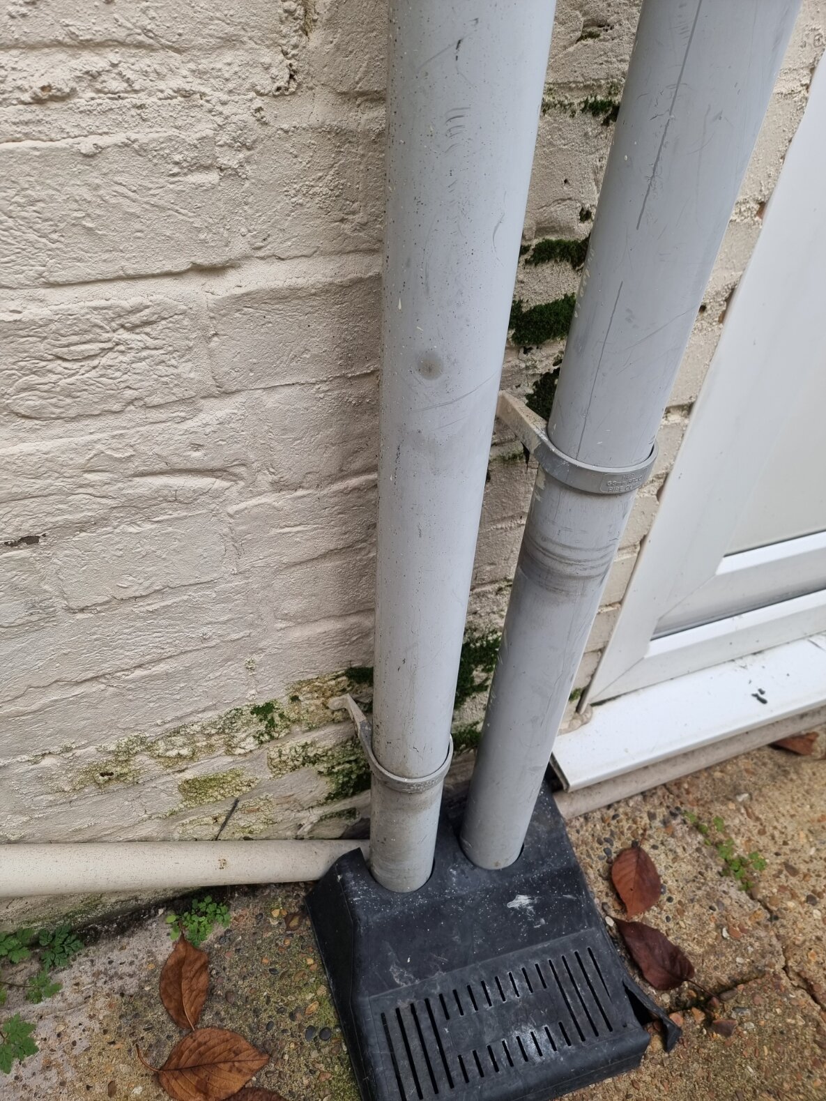

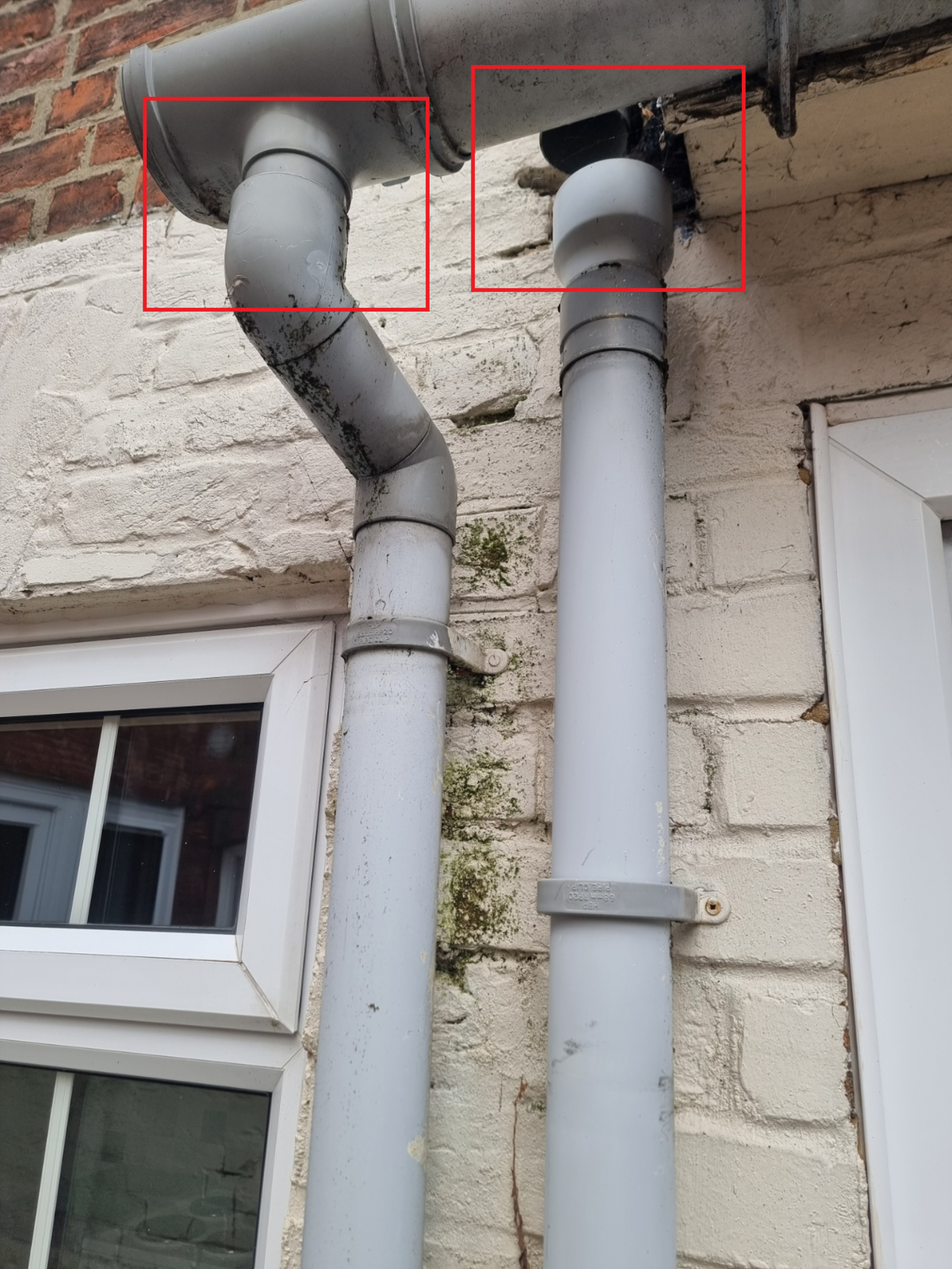

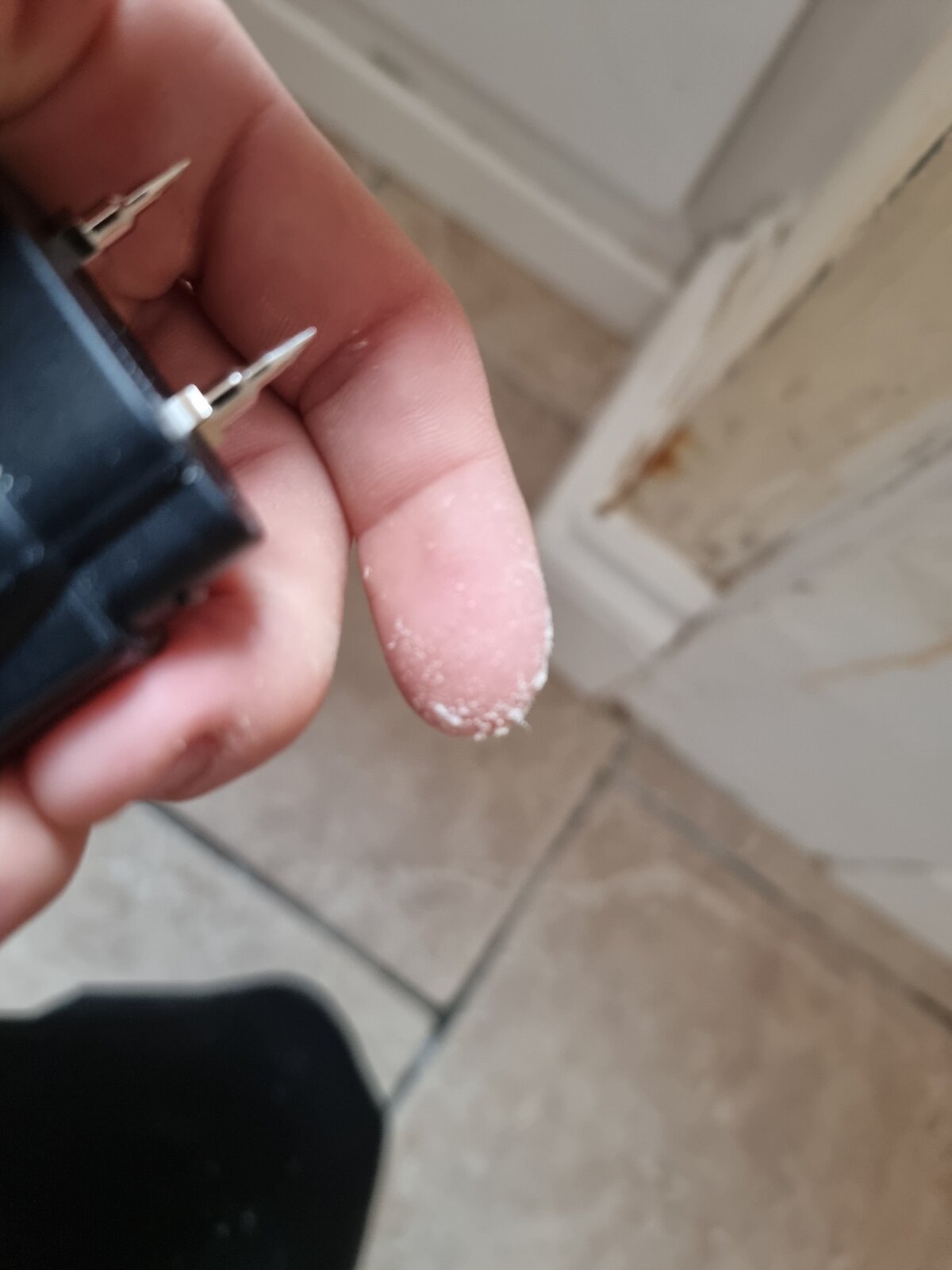

Fast forward 2 months, My L3 Surveyor has been in and also noticed these areas, specifically one patch of 'Damp / Historic damp' in the kitchen, By the door. Adjacent this door there is a drain pipe which is 1. Misaligned in one area. and 2. Has a pipe missing on the down shoot. (Both pictured). Behind the drain pipe on the wall there is visible, growing moss which is telling me that the area is holding moisture, and again, on the inside adjacent there is damp. On my prior viewings this 'Damp' on the inside remained dry, However after the recent downpours we've had, after another visit yesterday the area is more-so damp and now has salt deposits (Pictured).
Me, Someone who isn't very clued up on this is telling me this has to be the obvious culprit and fixing the drain pipe will stop the damp around this area.

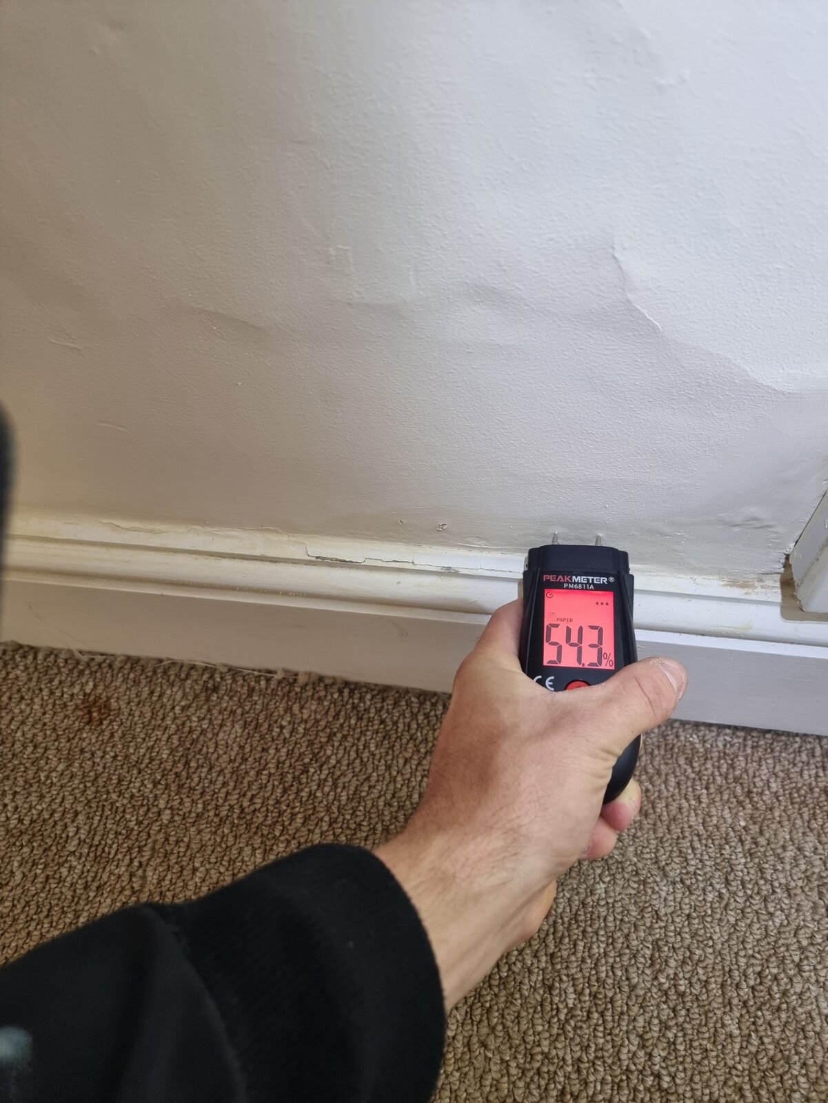

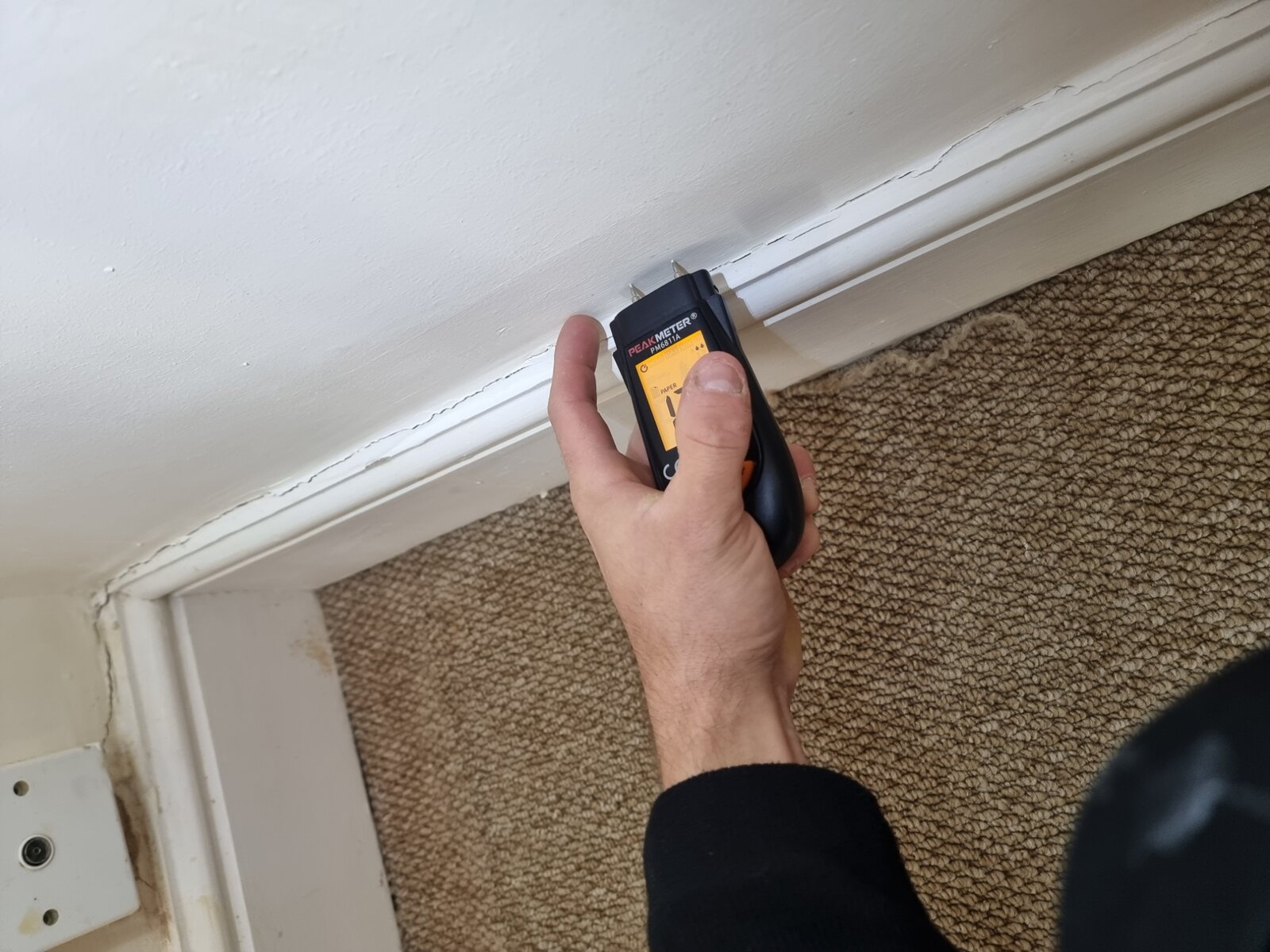

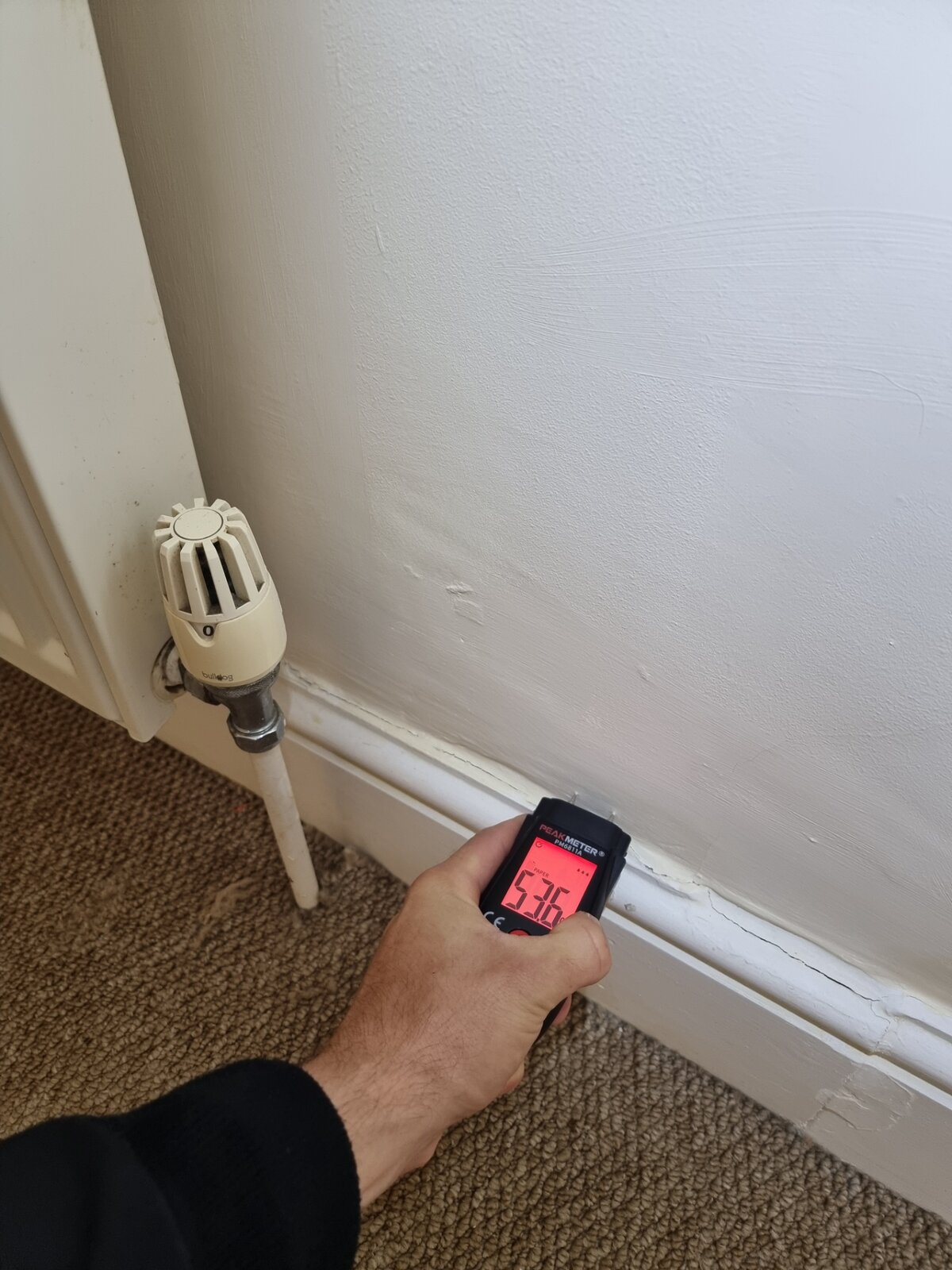

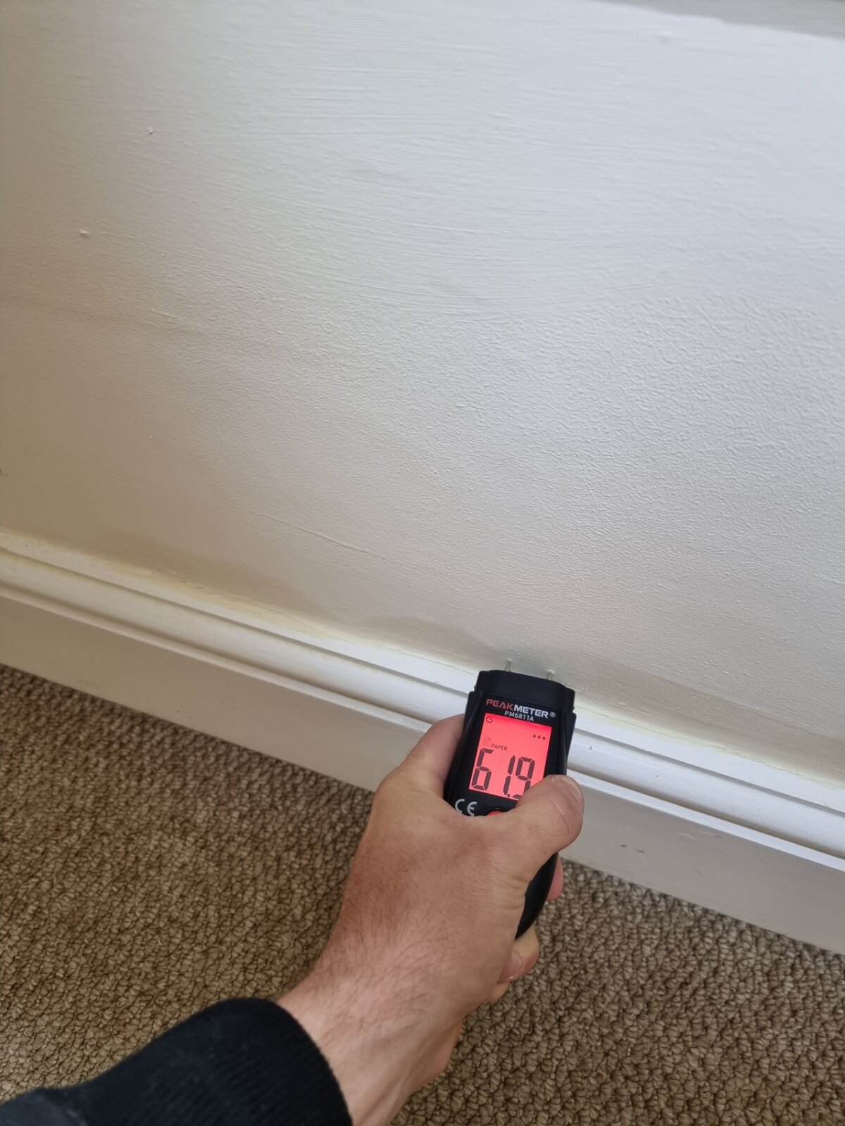

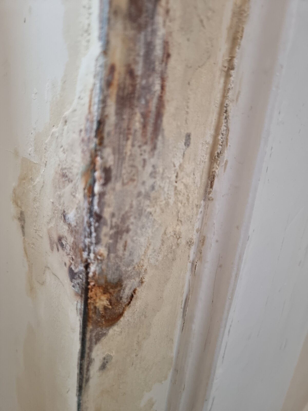

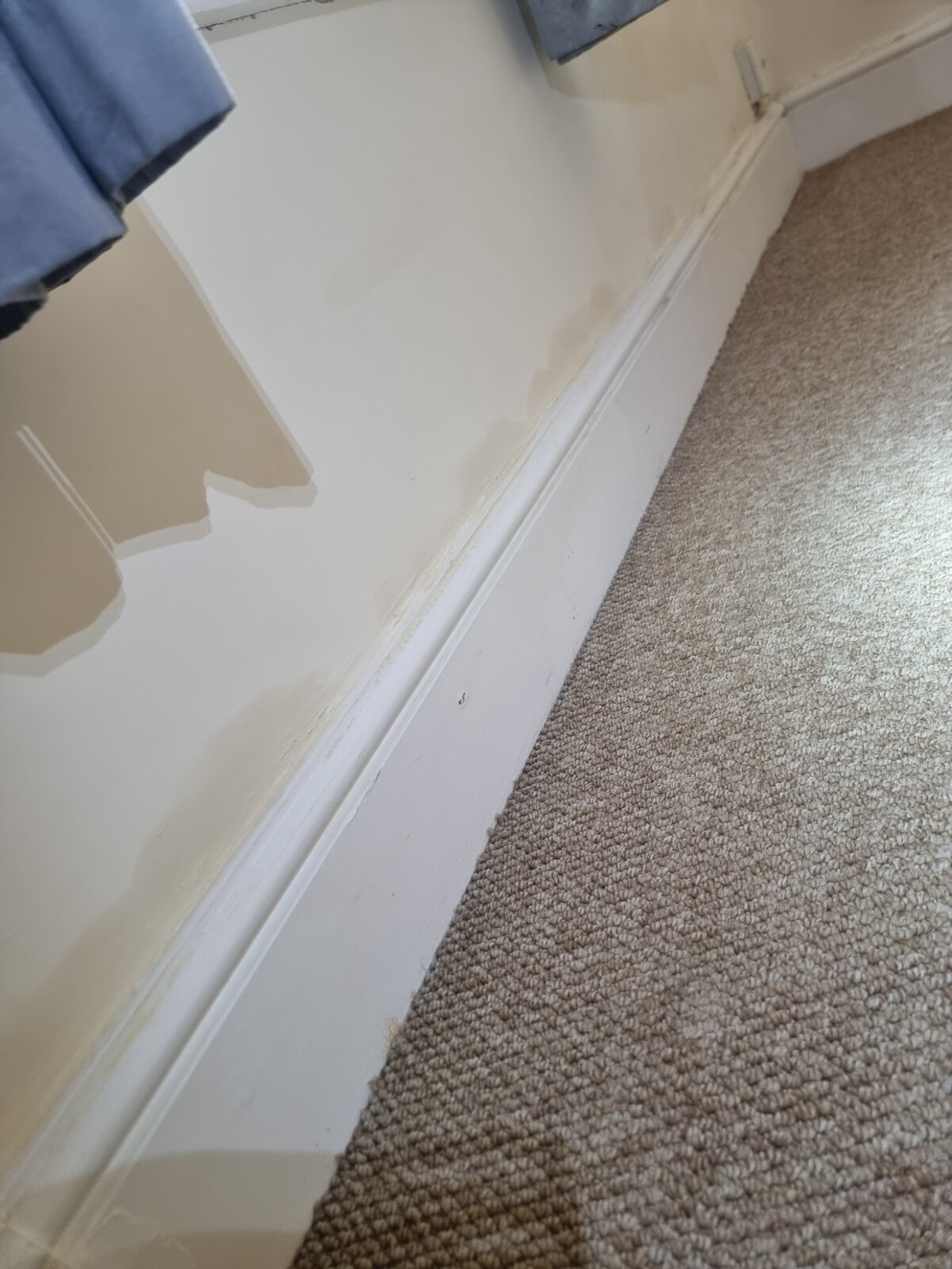

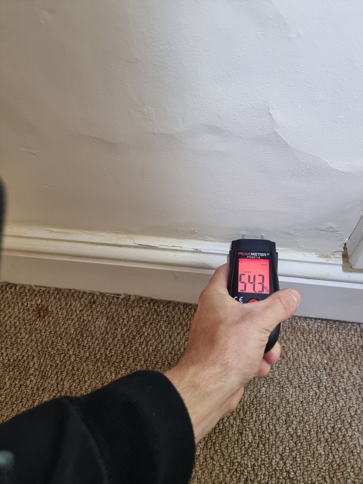

We're now upstairs on the first floor in the master bedroom. This bedroom and wall in question sits directly above the front door / front windows and above is also the guttering. When viewing yesterday, Along the front wall (Front door facing) I noticed what I can describe as 'Visible Tide Marks' running all away along the skirting board along (Pictured). These 'Tide Marks' were between quarter of an inch to half an inch above the skirting board and were consistent all the way along (Pictured). When I put my moisture meter on these marks, The readings were quite high - Between 50-70% which is quite wet. If memory serves, The other 3 walls in the room DID NOT have these tide marks and the moisture readings went down to between 10-15% just above the skirting.

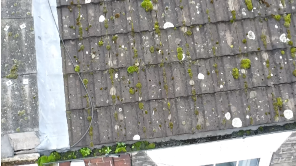

Now, I took a look at my Survey and noticed that the Surveyor noted & took a picture of the 'Blocked guttering' directly above. At the time of the picture, There was no heavy downpour however there is still visible sludge / water. I can only imagine how much worse these gutters have been over the past week or two due to the heavy rains.
My Idea; The gutters are flooding, Water is absorbing / trickling down the wall and sitting where the water meets the first floor, Then soaking through the brick and becoming visible through the plaster / paint which is what I'm seeing.

Pictures 6-11 are the first floor master bedroom + the guttering above the window.
