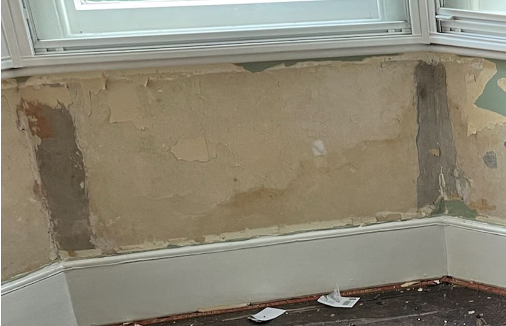

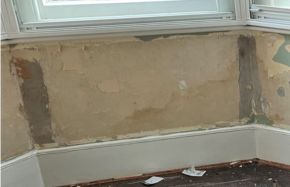

On stripping away the wallpaper, I see a tide mark on the plaster under the bay windows. This is about 2 metres away from the drain, so probably not likely source. The shape of it doesn't look like rising damp (see photo), it seems to be coming down from the corner of the bay window and spreading out to either side, could this just be condensation from the window, or a leak perhaps? I wouldn't have thought 'rising damp' would make a mark of that shape.

On stripping away the wallpaper, I see a tide mark on the plaster under the bay windows... it seems to be coming down from the corner of the bay window and spreading out to either side
show us the outside. It will be a building defect, perhaps a roof or gutter fault, or gaps around the windowframe.

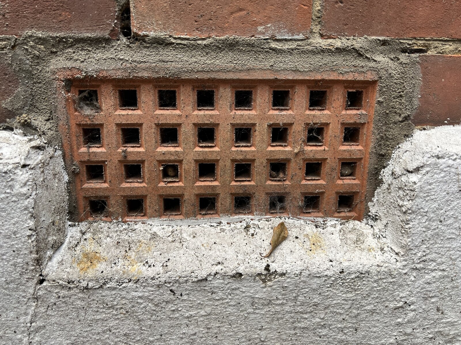

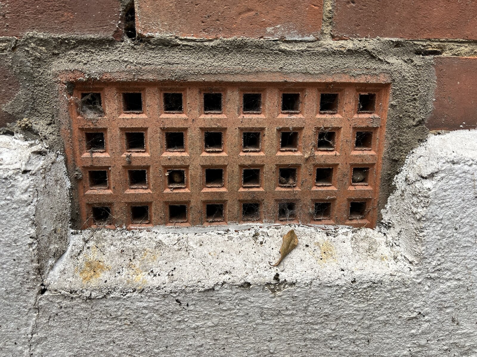

Here are a couple of photos. The first shows the air brick - the bottom row of holes is blocked by the plinth. Do you think it would help add more ventilation if I hack away some of the plinth to expose the holes? I presume they've done that to keep it a certain distance above the ground level.

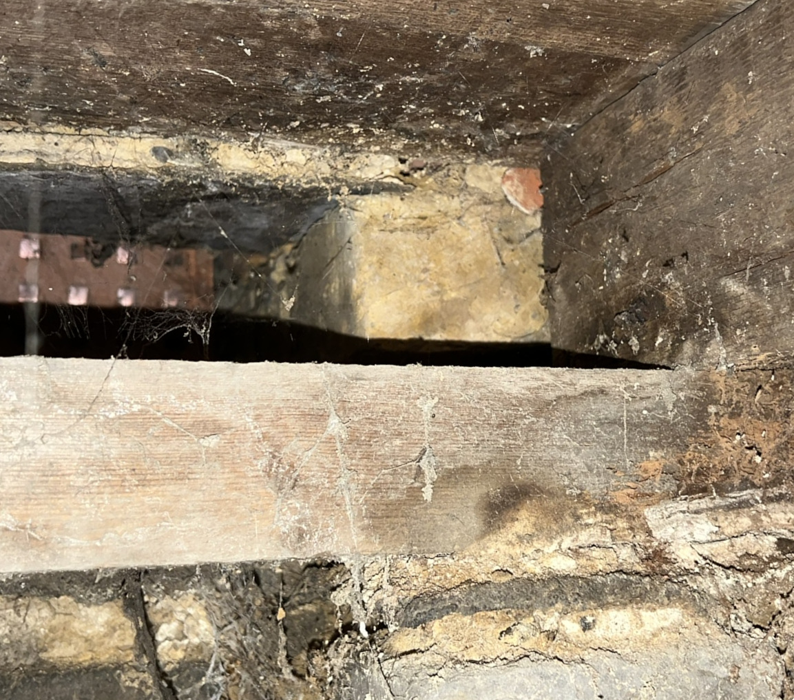

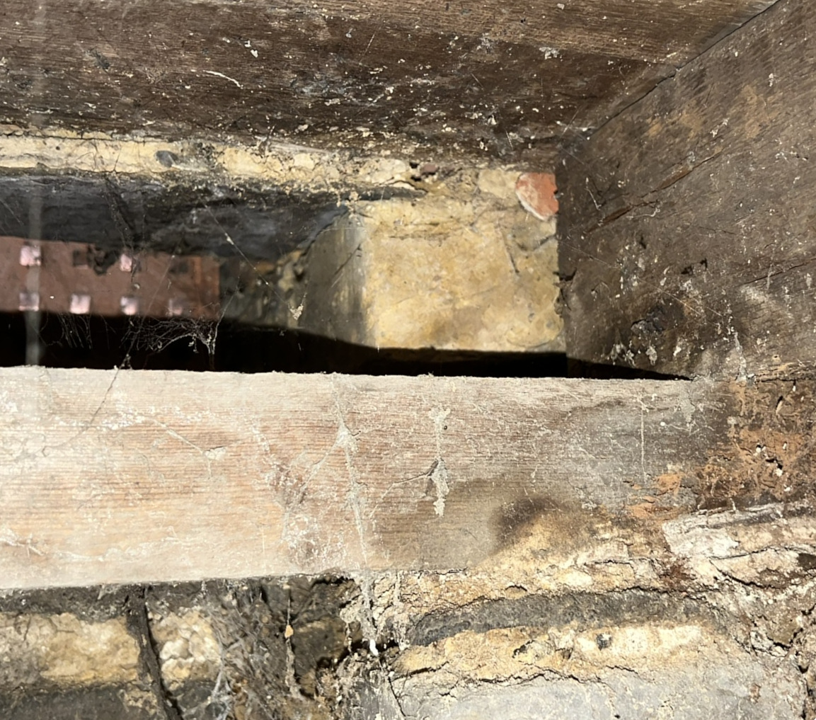

The second picture shows the same air brick from the inside, only two rows are visible, I think the top two are open, just blocked from view in this photo. Do you think this gives enough ventilation? This is the only air brick in the front wall. There is another at the back of the house, which was partially blocked by debris (soil, rubble) on the inside.

There has been previous work in the bay - neither wall render nor skirting are original.
The latest pics show extensive rot damage to the joists and probably to the floorboards.
The single air brick is inadequate. You need a number of air bricks at the front and rear of the house to provide through ventilation.

Lift a number of floor boards to expose the rotting joists below.

A pic of the rear airbrick location would help?
Yeah I thought that, why are parts of it grey - is that a cement render from a previous damp proofing attempt? It feels much colder to the touch than the lighter areas.
Yes there is a lot of damage to the joists, not so much in the floorboards though. Mainly in the corner of the external wall opposite where the drain is.

Next. No, I mean across the interior of the wall, & the exterior Why not remove all obstacles, and, as best you can, take pics showing the rear elevation at low level - do the same at the front elevation. Clearly show air bricks and plinths.

Yes the DPC should be just visible when viewing from under the floor.
