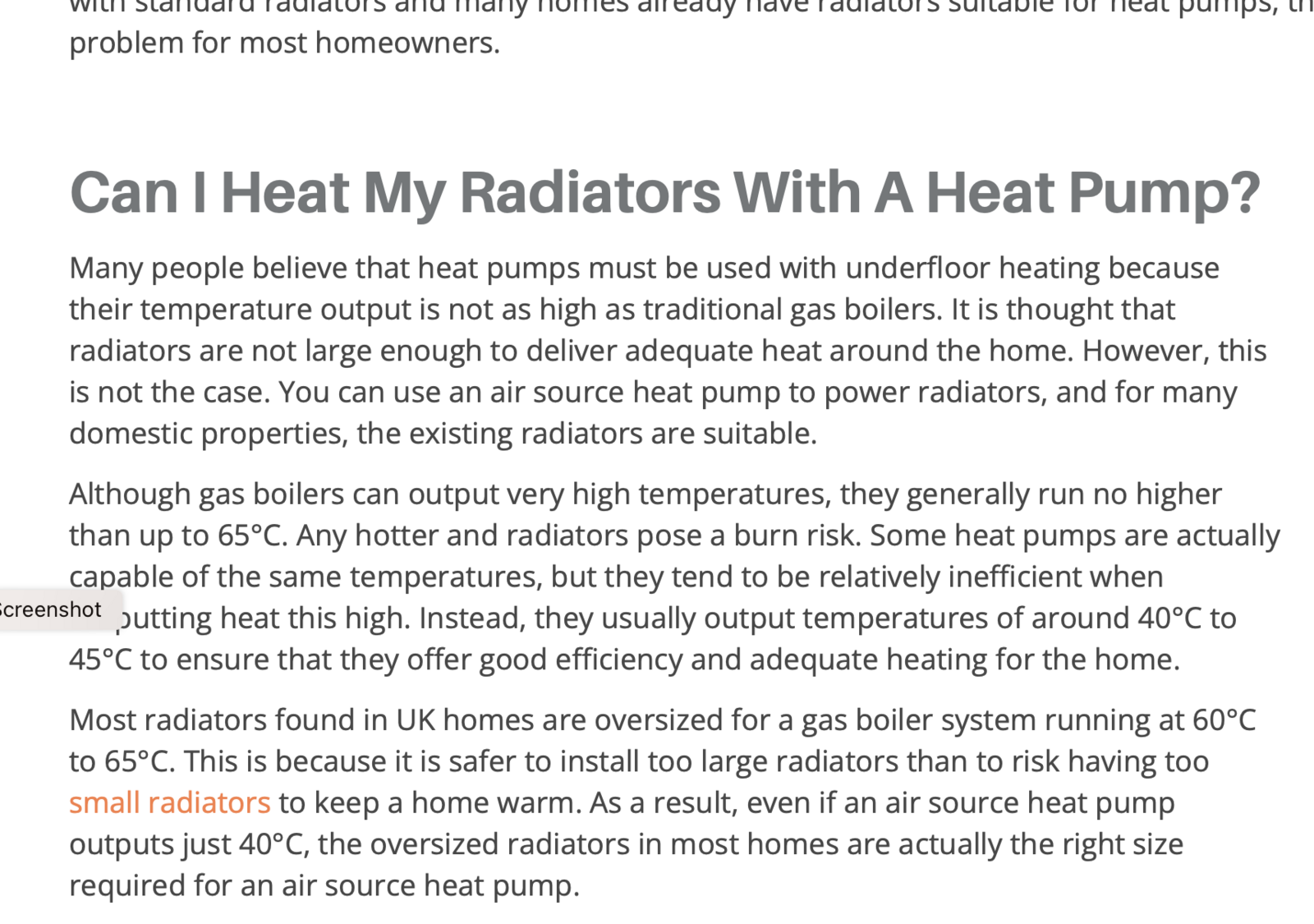

In the Living room we have a double 600 x 1200....and last winter I measured the temperature of the Radiatoer..it was 50*......and we were comfortable.....the other rads. are seldom if ever used.....
Here is an expert from an article from Just Radiators about ASHP...............

No harm to compare some numbers,
If you have a rad with flow/return temps of 65C/50C then the rad will output 68.8% of its rated output.
If the rad has flow/return temps of 45C/40C then that rad will output 35.4% of its rated output or 51.4% of the 65C/50C output.

Quite often, older rads were oversized for 20° deltaT and "can be" suitable for LTH.

Most rad manufacturers now include a conversion factor for lower flow temps in their charts... Or they print the rated outputs for different deltas.
