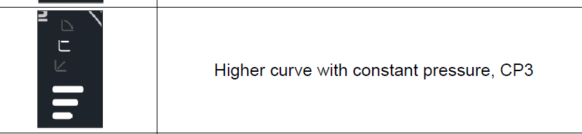

I suggested increasing the pressure by 0.5 bar by adding water and not air, air is only used when precharging the E.vessel before filling, can you change pump setting to CP1 or CP2. Have you a link to that pump as I don't seem to be able to find one.

Can you run the pump for awhile on CP3 which is constant pressure at 6M.

I will try this setting this week and update if that's ok?
