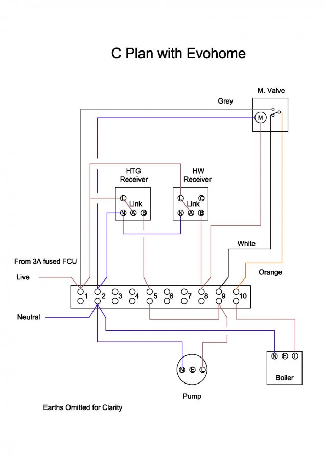

OK so I've now got all the kit, 11 TRV's a wall stat, a 28mm 2 port valve (with 6 wires including white) and the hot water kit. But I can't find a wiring diagram for C plan using the evohome kit. My main concern is what do with the white wire from the 2 port valve. My hot water tank is in a cupboard up the stairs and the boiler is down in the utility room, with all this kit being wireless I really don't want to have to get that white wire back to the boiler by wire.

However, it's not difficult. I sent you a C Plan wiring diagram in an earlier post, but I have now modified it for you showing how to connect the Evohome components. All you have to do is simply substitute the Cylinder Thermostat and Room Thermostat shown on the C Plan diagram with the appropriate Receiver. You will need to add Lives & Neutrals to the receivers to power them.
The numbers below refer to the main terminal strip, which follows the conventional Sundial Plan format and as used in the Evohome installation manual for S and Y Plans.
Central Heating Receiver
L = Terminal 1
N = Terminal 2
A = Link to L
B = Terminal 5
Now link L & A
Hot Water Receiver
L = Terminal 1
N = Terminal 2
A = Link to L
B = Terminal 8
You don't need a connection to the receiver C, that's only for a Y Plan.
As you won't have the programmer shown in the standard 'C Plan' diagram, just ignore it. The live supplies that would come from the programmer are now made via the L & A links at the Receivers.

The white wire from the motorised valve needs to be connected to the pump [not boiler] live, as it is where it gets its switched supply from. You could possibly get around it with a relay at the wiring centre energised by connecting the coil to the motorised valve L & N and using a set of changeover contacts instead of the internal microswitch inside the motorised valve, as shown below.

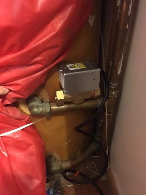

This is where I plan on putting the motorised valve, is this right? Between the boiler feed/vent and the cylinder? Looks like it will be
pretty tight but I should be able to get it in there.

Probably the best solution really. The relay is complicating it a bit. Also if you can fit the motorised valve where you show it, that will be fine.
