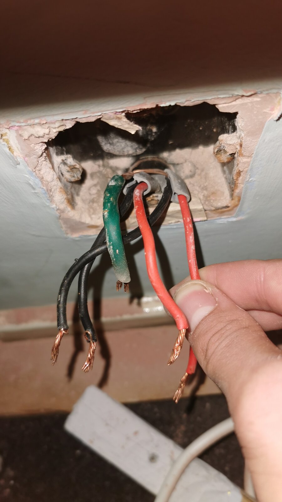

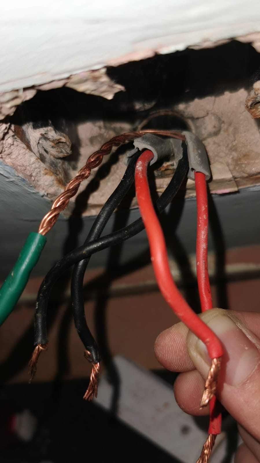

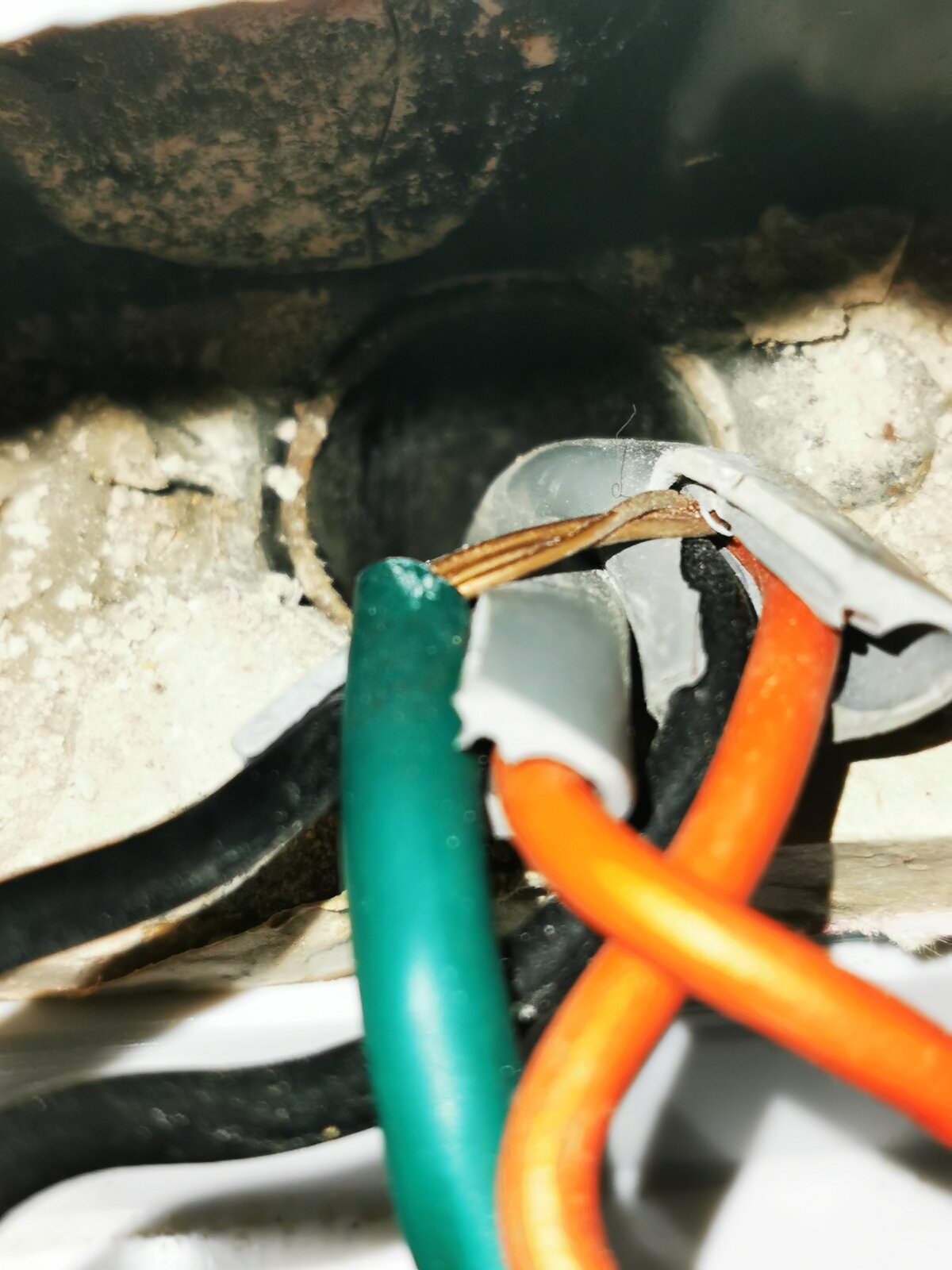

Riley Jarvis Joined 9 Oct 2023 Messages 1 Reaction score 0 Country 9 Oct 2023 #1 Dose anybody know what wire size this is (house was built in 1960's and has never been rewired) its down as 2.5mm2 on the EICR)
M Murdochcat Joined 29 Jun 2013 Messages 7,075 Reaction score 2,321 Location Surrey Country 9 Oct 2023 #2 Its almost certainly 7.029 - dating back to the early 1970's or before - so 2.5mm would be the modern size Most EICR software (if not all) only list metric sizes so people select the closest Why do you ask?
