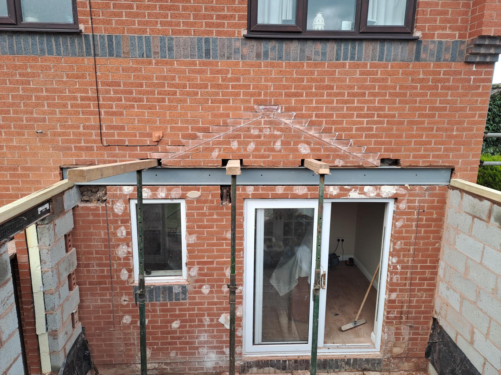

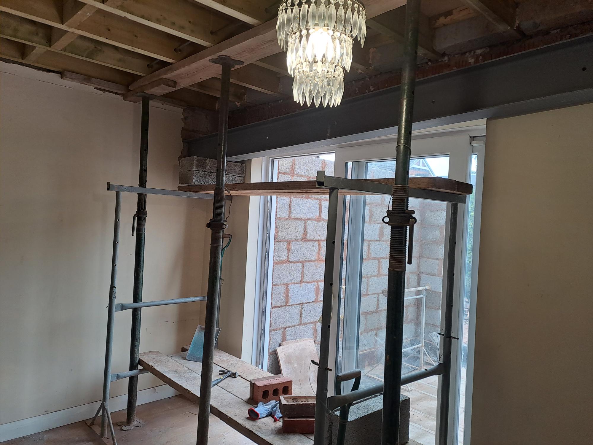

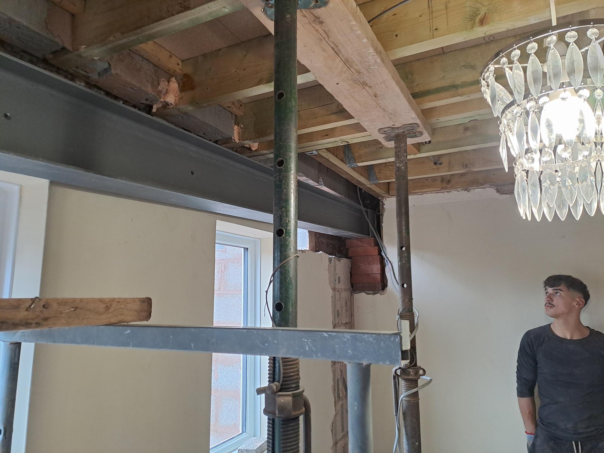

You want 3 props either side of the wall and 2 to push the beam up
The norm is around 3foot centres. The important thing is to make sure the acrows are vertical and sitting on a good timber to spread the load and reduce the chance of slippage. The theoretical capacity plummets when they go out of vertical.

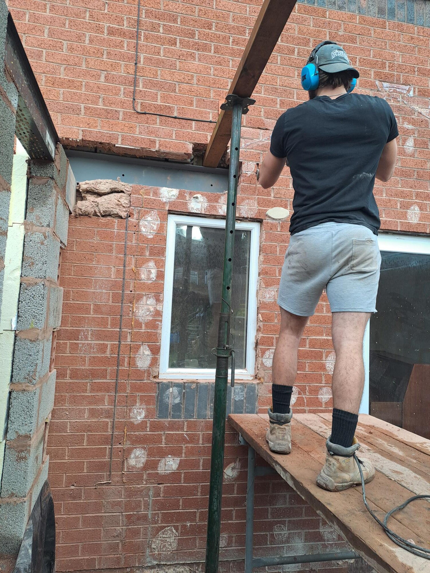

Do you really need a beam lifter for an RSJ that short. Or have you thought of using a catnic lintel instead they are much lighter and easier to work with.

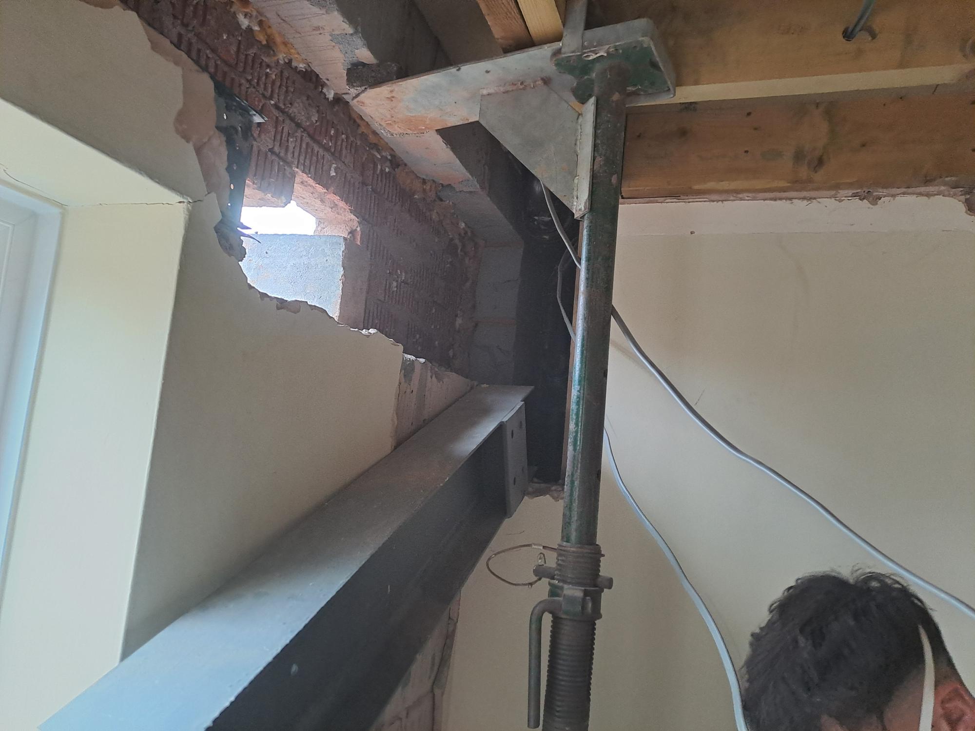

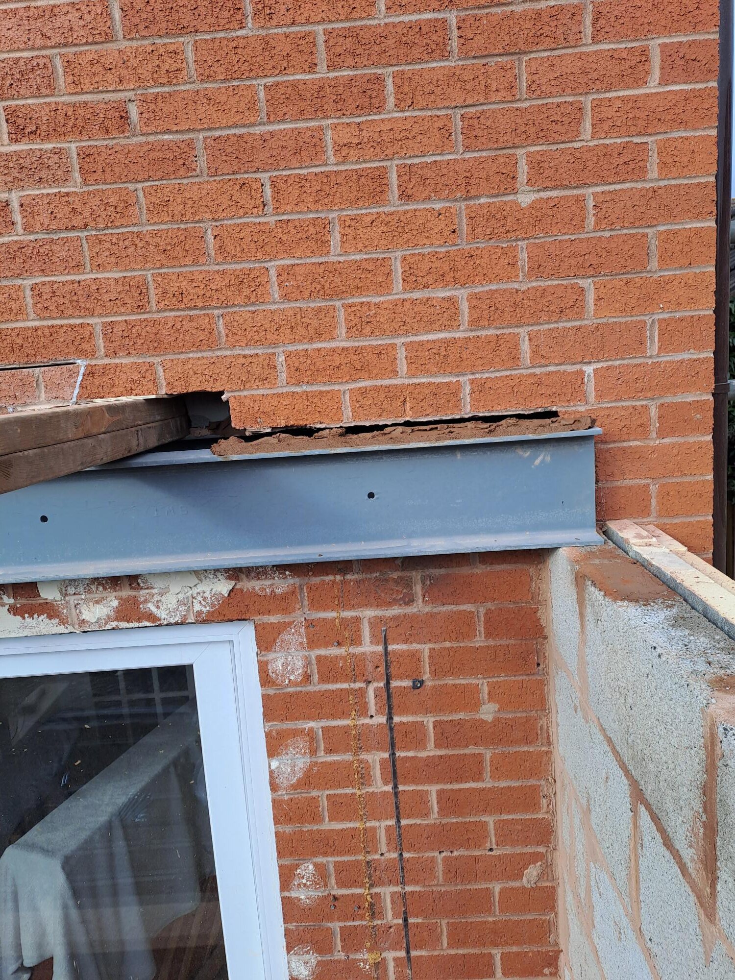

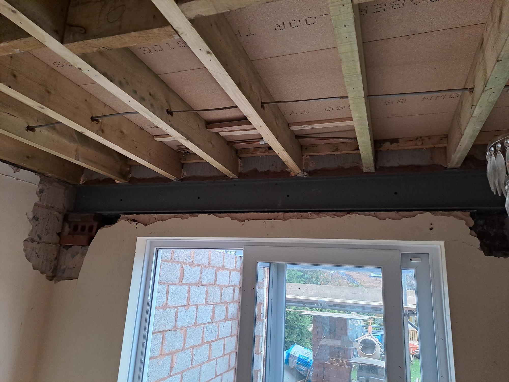

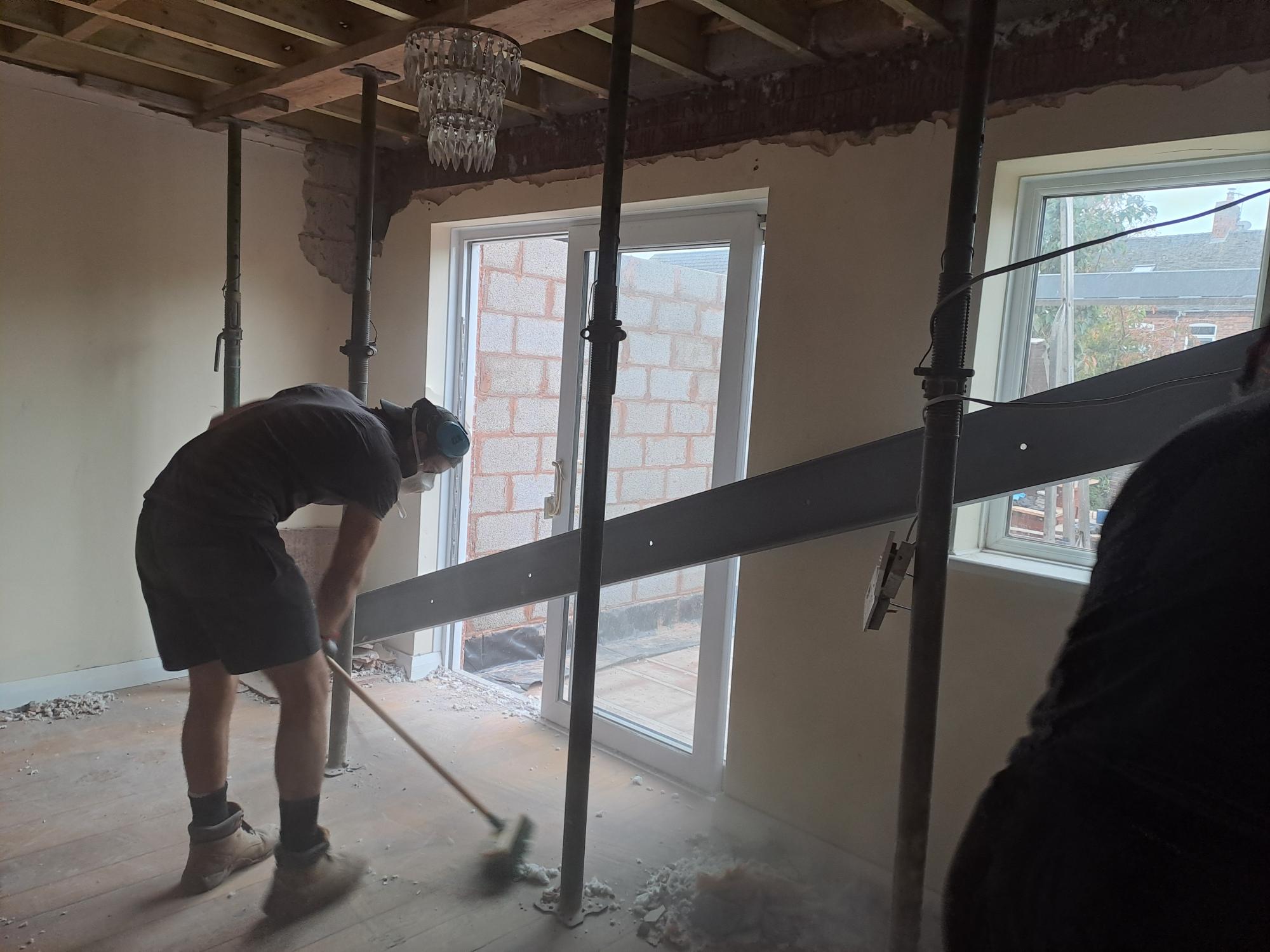

A 2.1m span will give you a beam of around 2.4m long. I could lift that on me ****.
As per Woody, 3 props plus two for the beam. Get six and you should be comfortable, just in case you need to do a bit of swapping about.

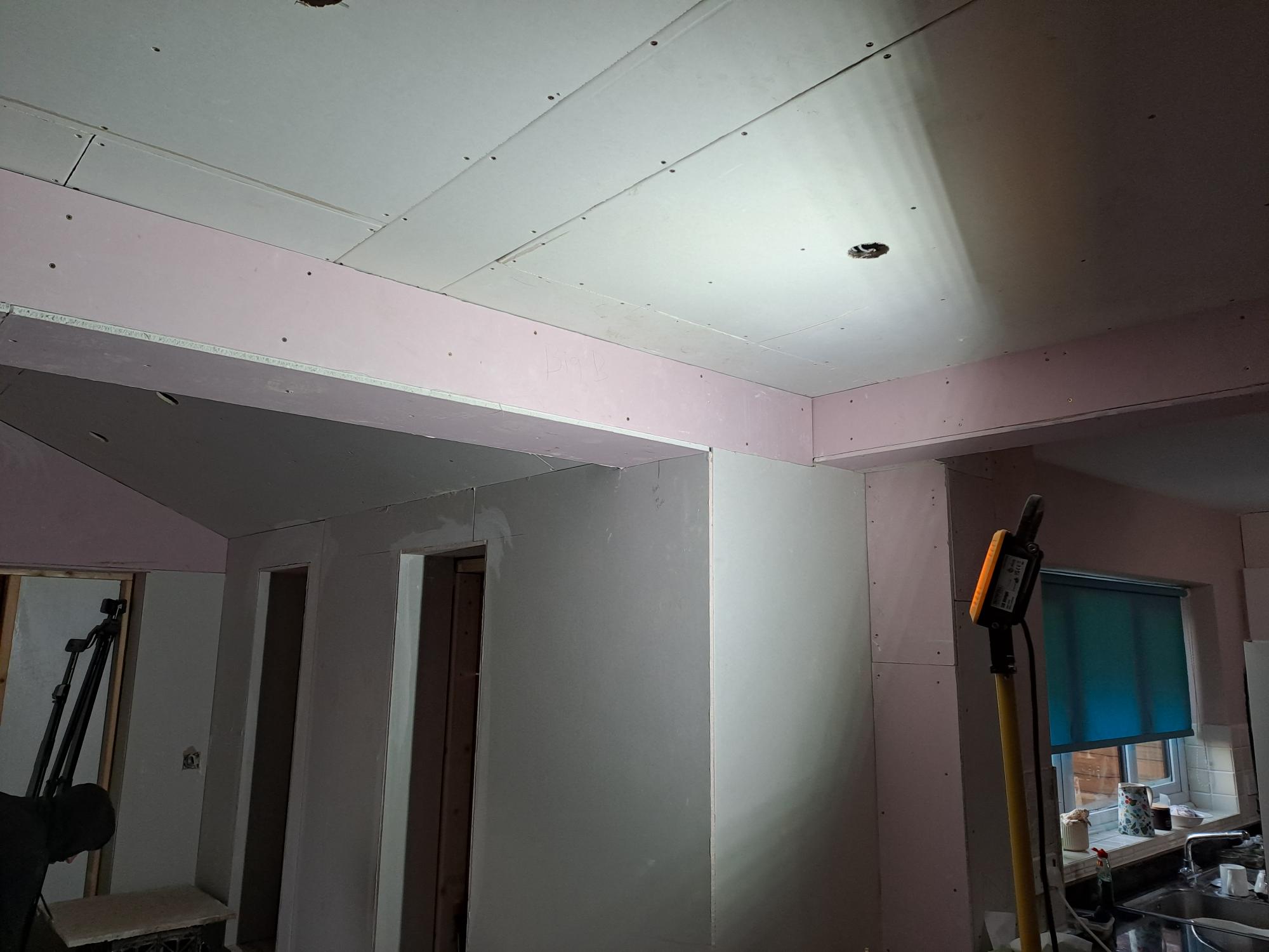

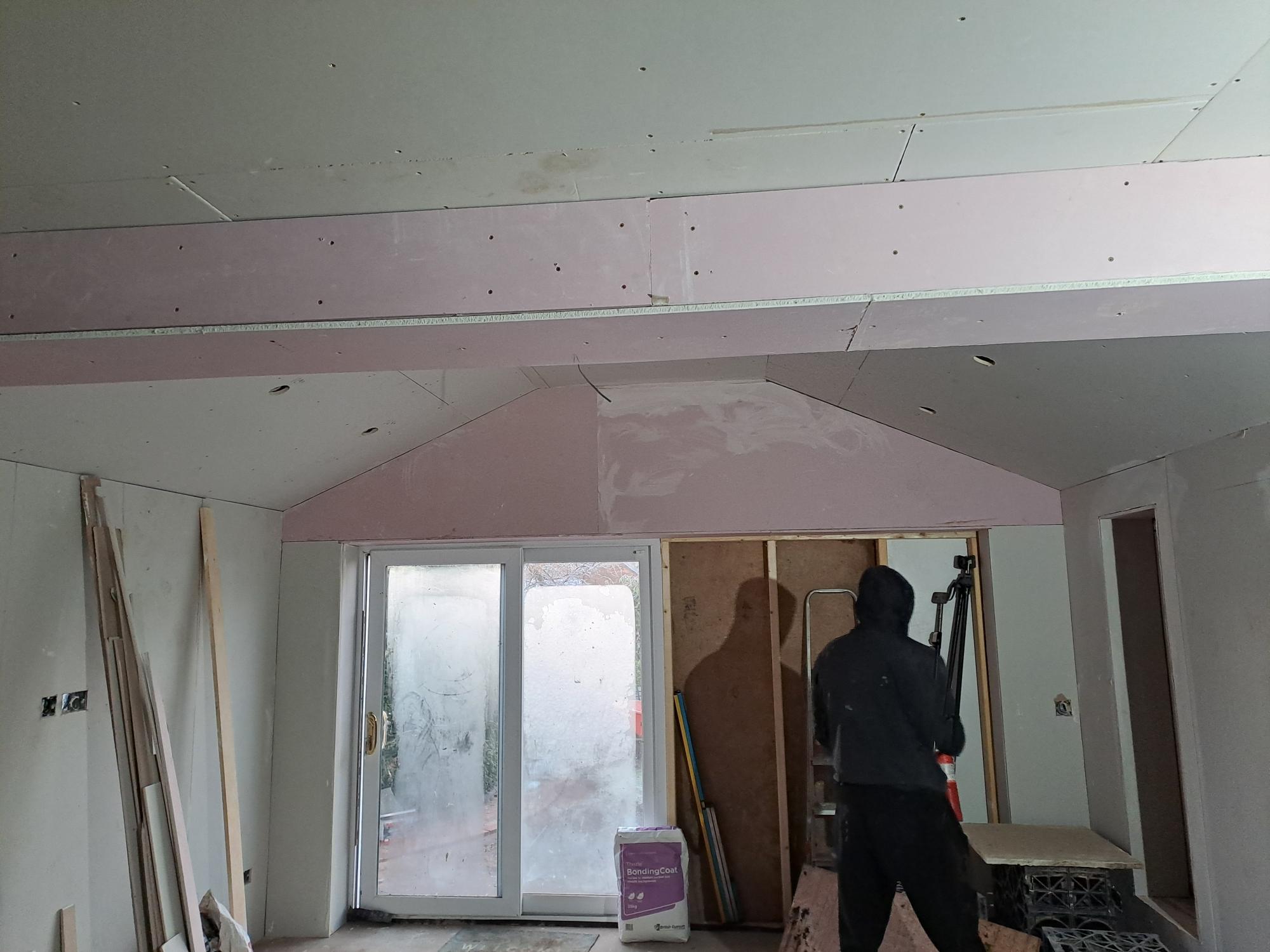

Any pictures of the finshed opening Noseall?
Andy

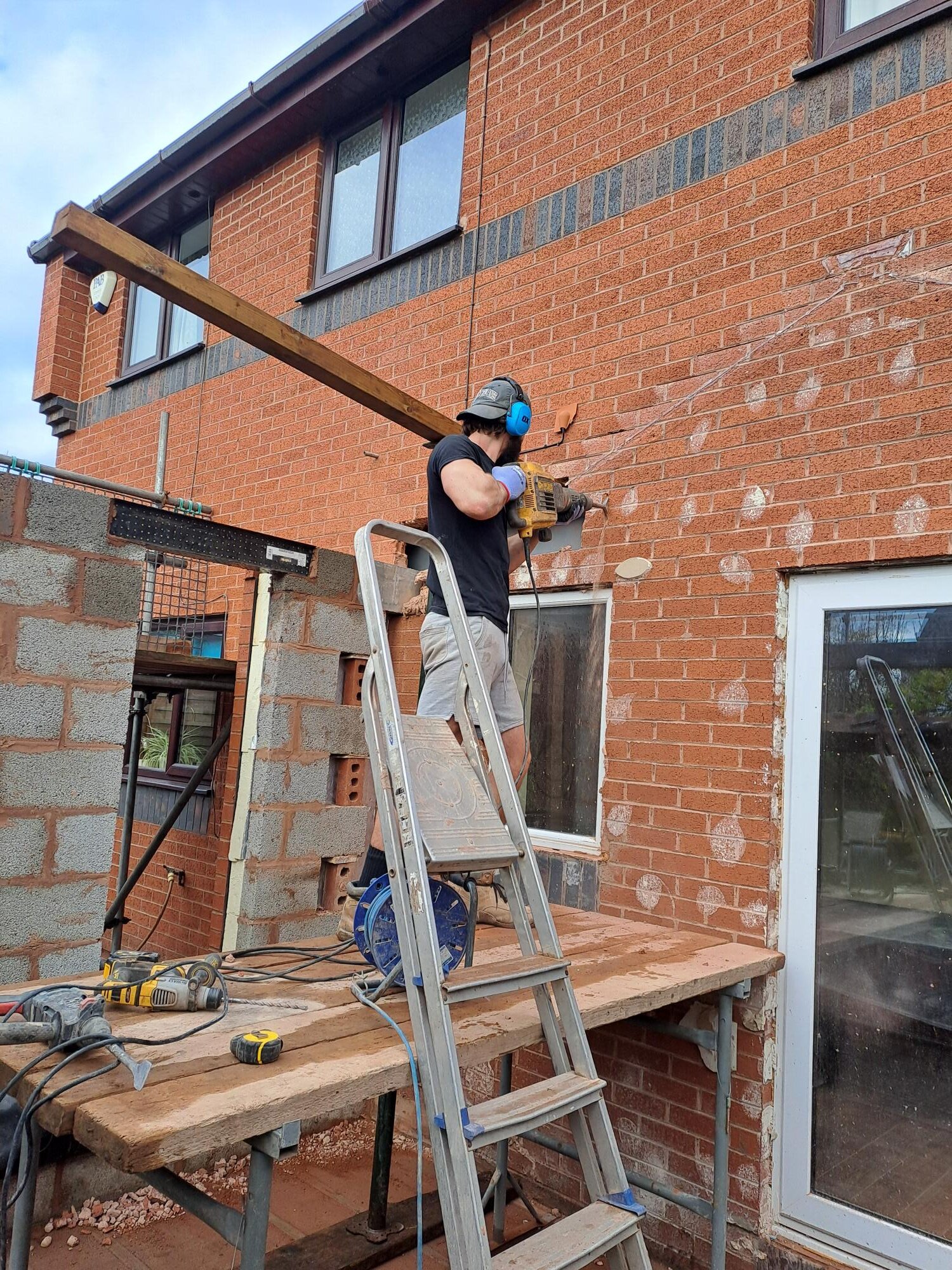

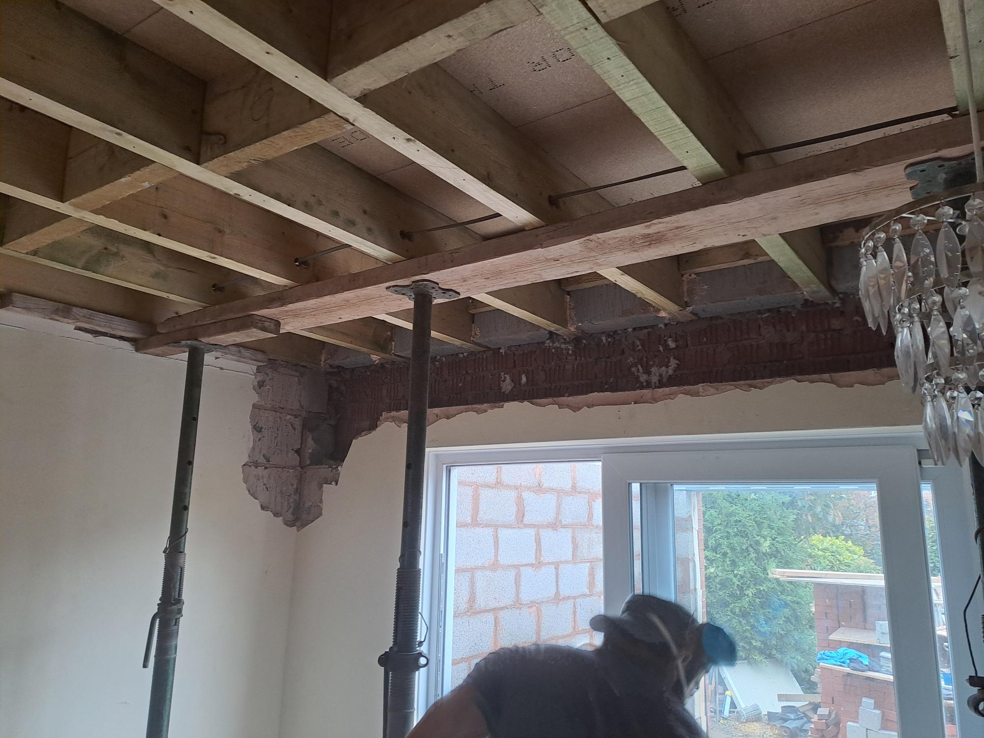

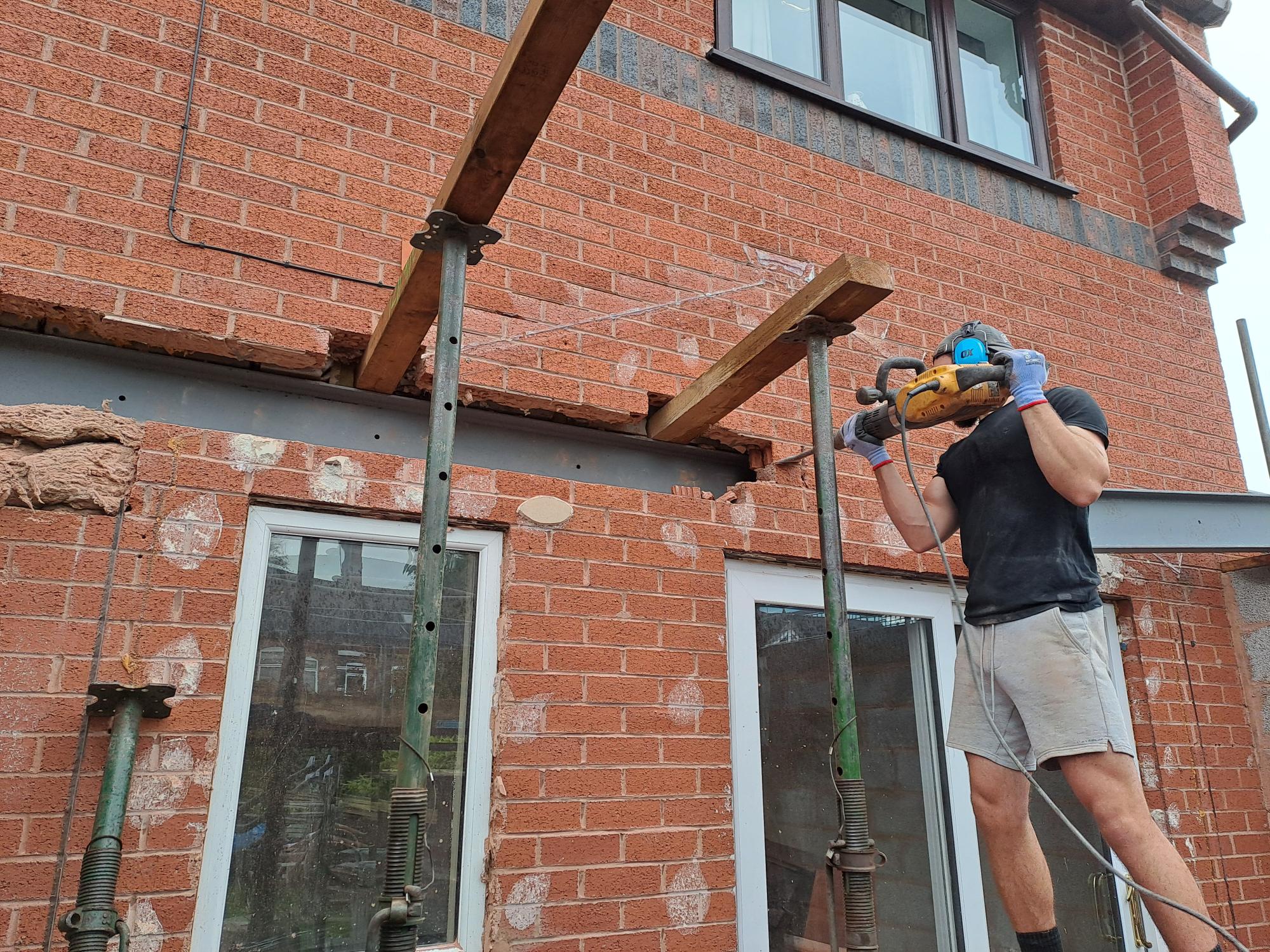

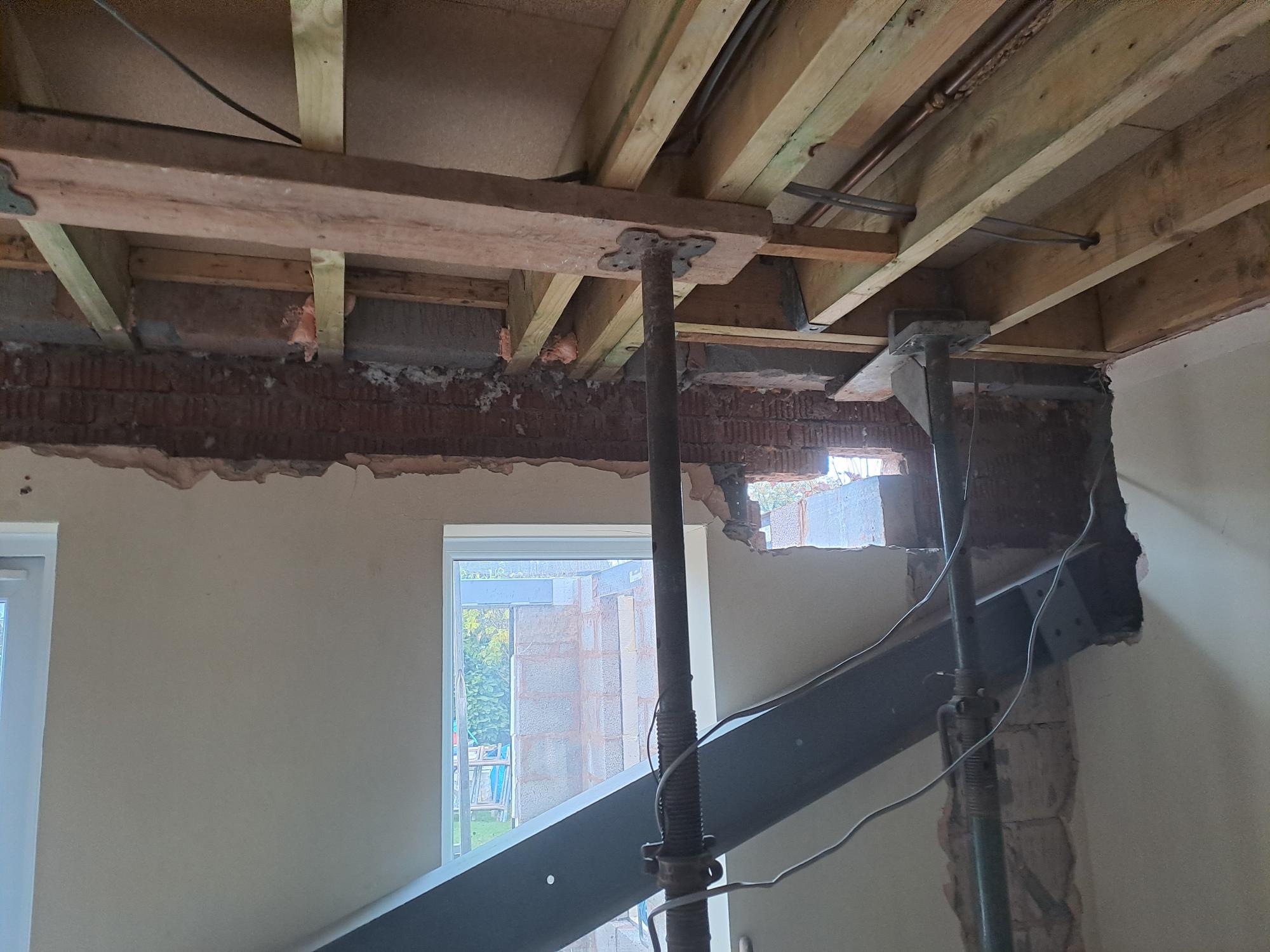

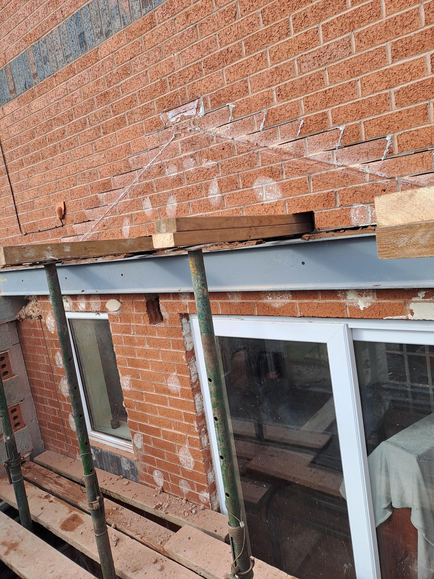

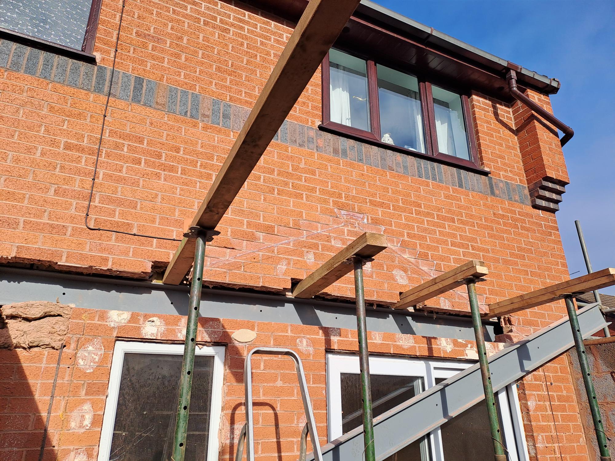

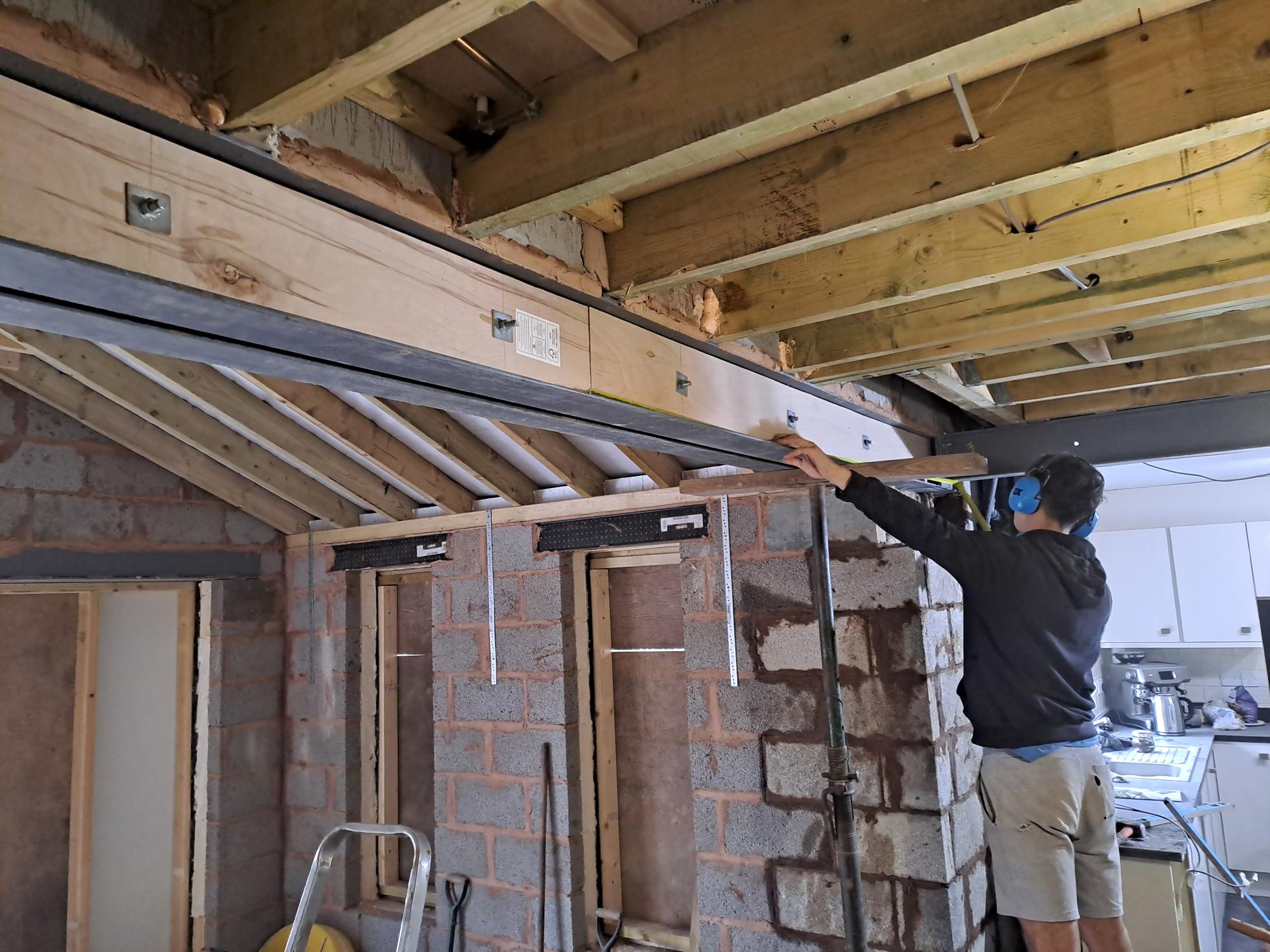

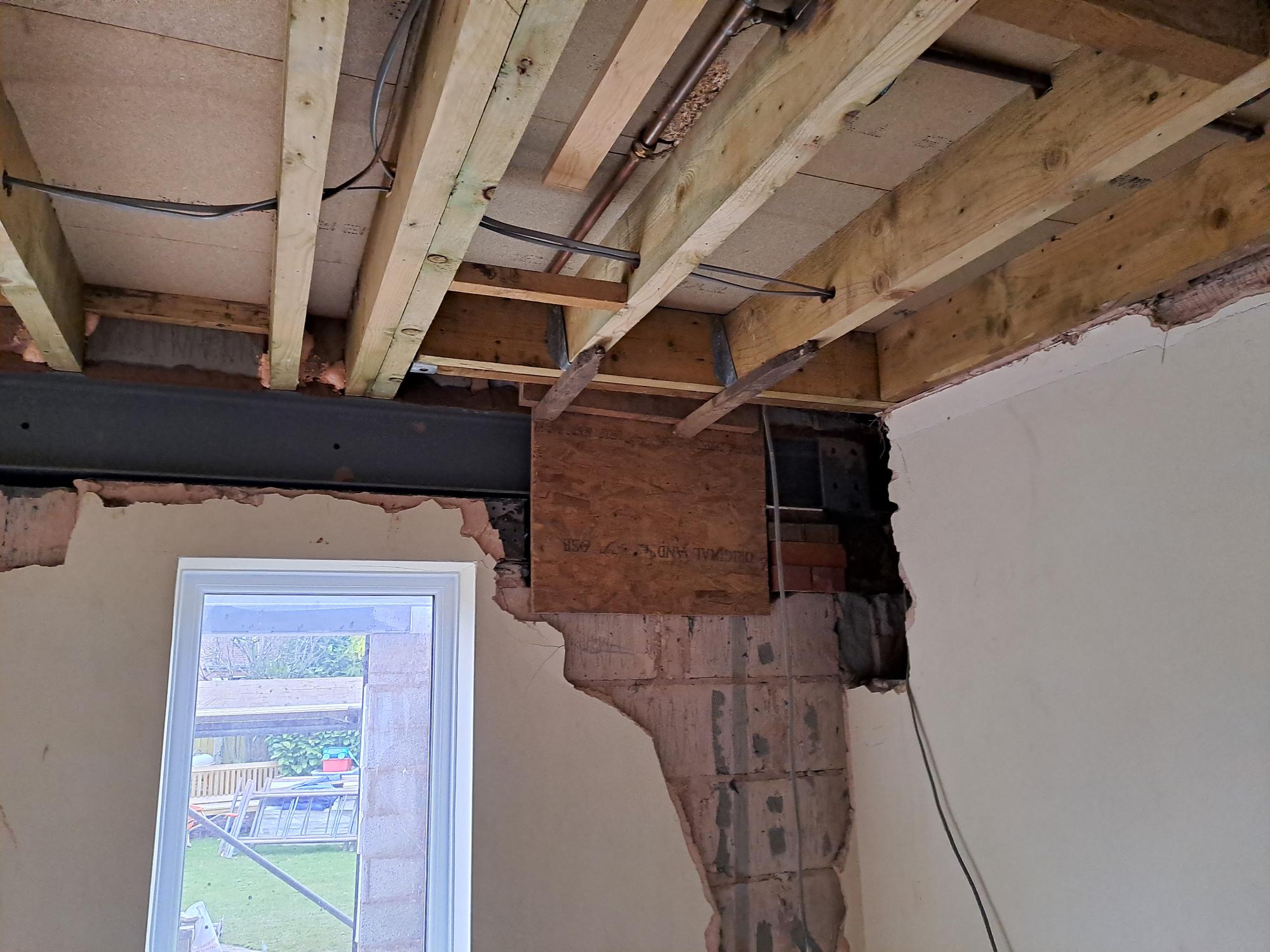

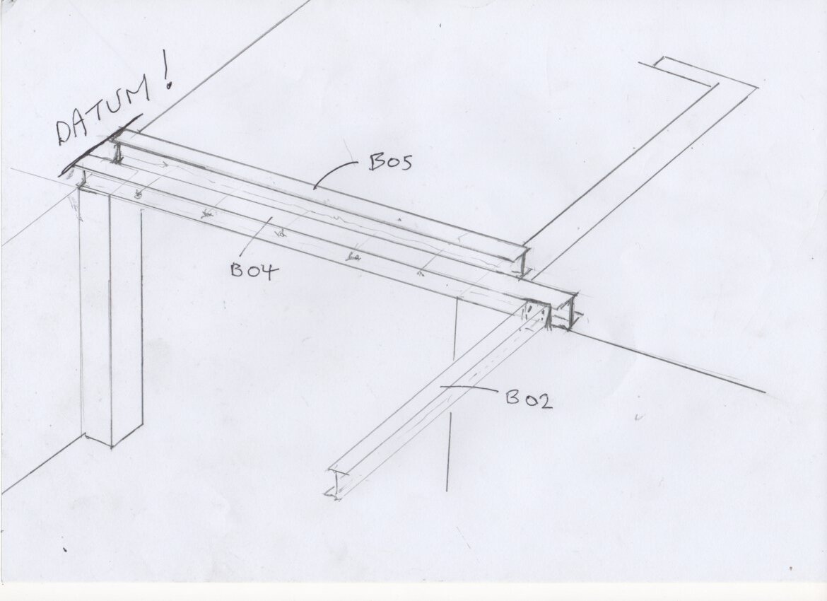

I dont really catalogue the finished article so much as I don't have much use for the images, i.e. i take stuff in case people like building control want a squint at anything relevant like Fire-line boards or end bearings etc. I have some piccies of his mate going in on the outer leaf, the other internal beam connected to it, the drawing I did for the steel company
and some of the padstones and fire boards etc...
