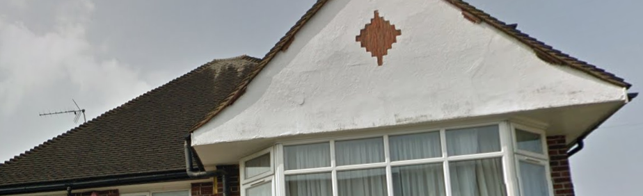

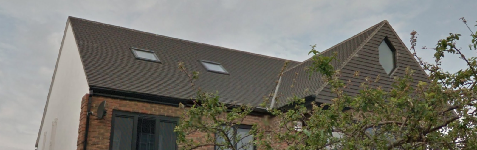

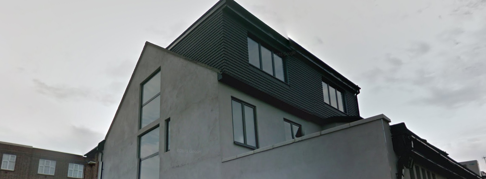

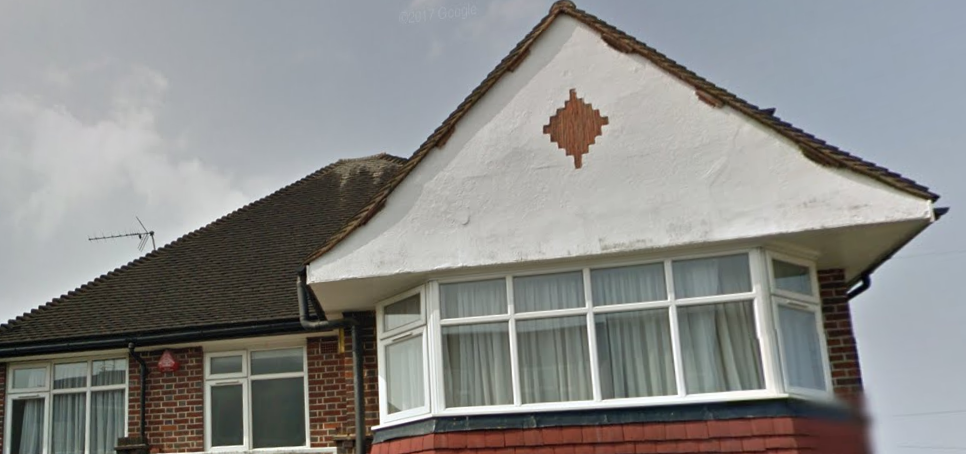

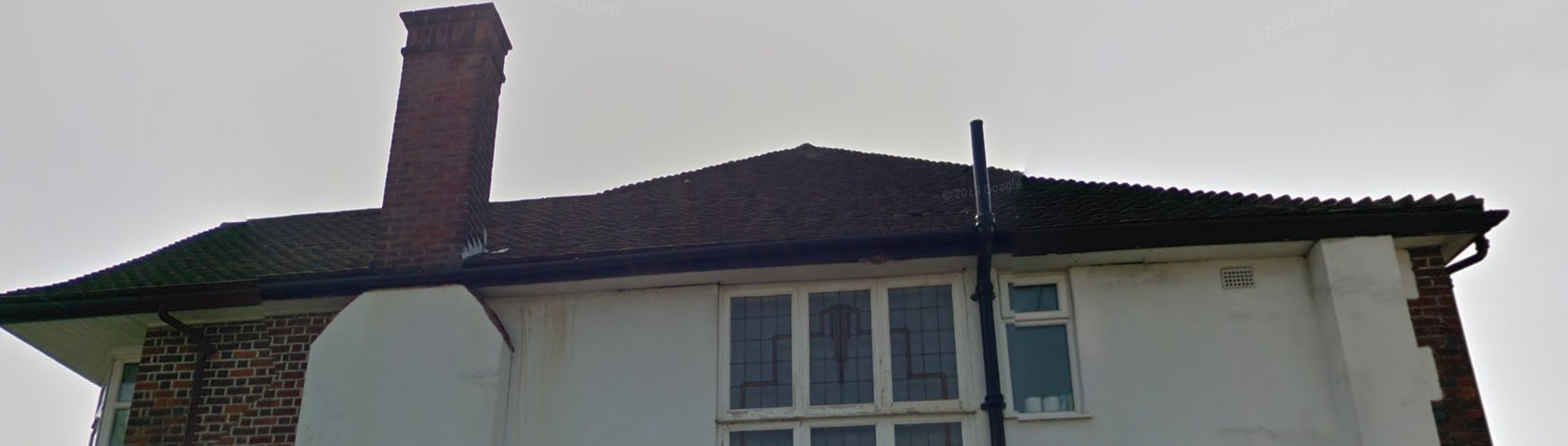

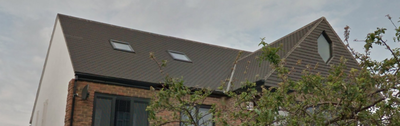

A neighbour has done the loft conversion as follows and he did it under permitted development so no planning but I cant understand how he could have done this and I am sure he would not have done this without paperwork
Basically he has taken a detached roof and made it hip to gable on both sides and added a full width dormer
The house is ten metres wide ten metres deep and the height from eaves to roof ridge is 2.2M
By my basic calculation just converting hip to gable results in 36 cubic metres being added and thats before the addition of the full width dormer
Cubic Volume of original roof - Its a prism right? - So current volume is 10 * 10 * 2.2 / 3
Cubic Volume of hip to gable roof excluding rear dormer - Its a triangle right? - So current volume is 10 * 10 * 2.2 / 2
Additional volume created by just doing hip to gable on both sides is (10 * 10 * 2.2 / 3) - (10 * 10 * 2.2 / 2) = 36.66 M
What am I missing? And how can a full width dormer and two hip to gables be less then 50 sq m?!

Ignoring the calculations, I doubt if that was permitted development, so what are you really querying. Do you want to follow suit, or talk to the council over it.
But work out half the size of the roof front to back, times the width and the height, then add half of that calcultaion for the front - try it that way.
Hi It was definitely permitted development because no planning permission was granted and the neighbour complained and it was deemed fine
I want to do the same on my parents house and the house is identical so understanding how permission was granted would help a lot
PD is 50m3 additional volume, so you don't need to worry about the existing roof. Any extra bits are just calculated as cuboid or pyramidal shapes.
The rear dormer is a triangular prism, which is really half a cuboid, so LxWxH /2
The gable conversion is again a triangular prism so the volume of that divided by 2 (ie deduct the volume of the existing roof which the new roof (the prism) intersects. The prism is an area of a triangle (the gable) x L (distance from new gable apex to existing ridge)
PD has other criteria, and it looks like the eaves have been raised at the front at least and the whole roof now being higher. Both of these are not PD. Not sure about the rear dormer set back, as it's difficult to make it.

Based upon the pictures above I estimate that the hip-to-gables are as follows:
1x Hip: H=0, W=6, L=5, O=2.2, P=0, Q=5 = 22m3
1x Gable: H=0, W=6, L=5, O=2.2, P=5, Q=0 = 33m3
Increase: +11m2
