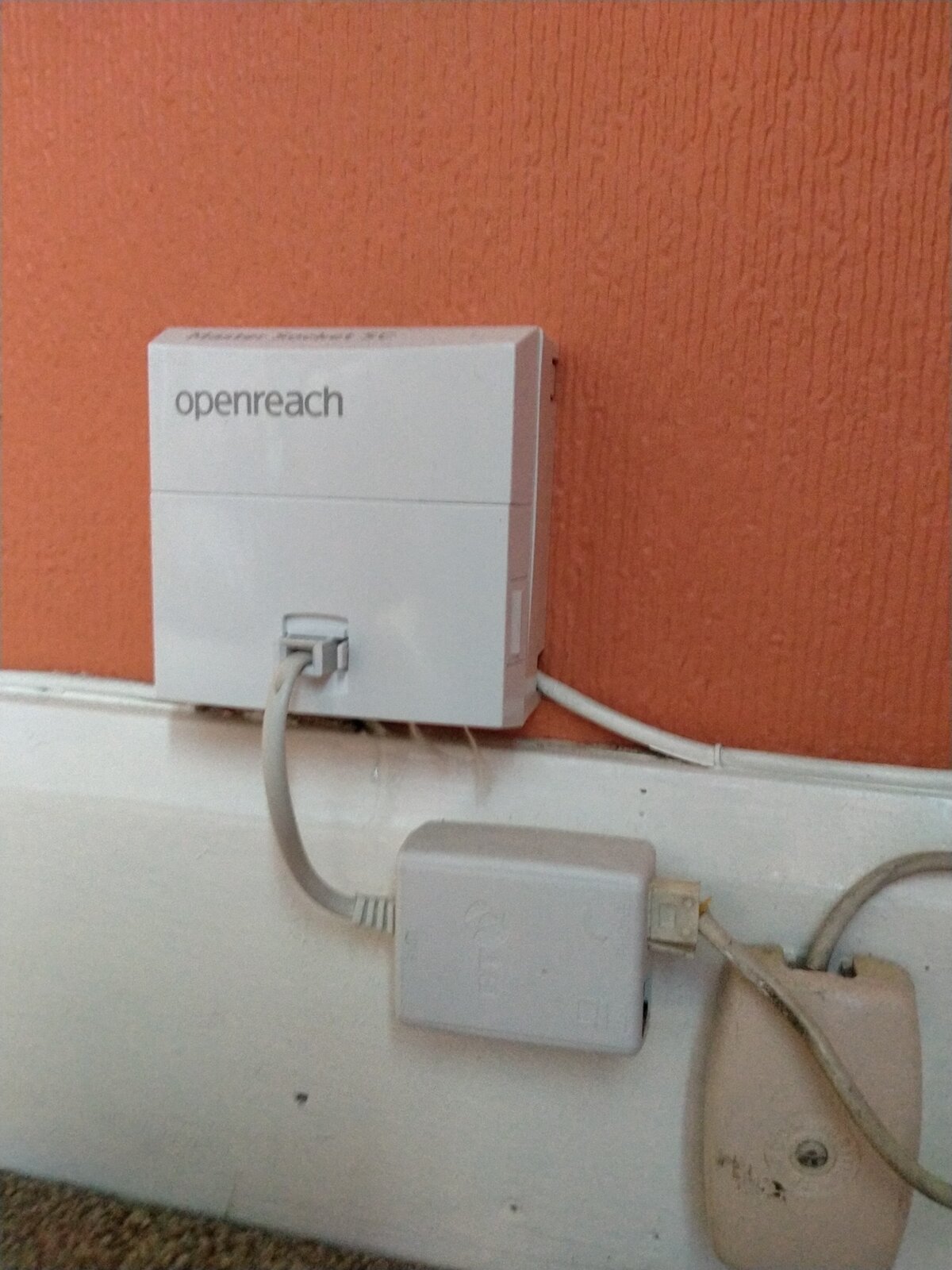

Openreach have installed a new line in the house I've moved into.
The existing master was in the kitchen which the engineer frowned on. He said he could blank that point off and site the master at an extension point but I told him to leave it.
I've now moved the master to the first extension point in the house so the fibre router is better sited for wifi. I've jointed wires 2 and 5 of the cables at the old master point in the kitchen.
Is it feasible to fit an extension plate where the master was in the kitchen, upstream of the master?

Upstream from the master the incoming pair will have both telephone speech and ADSL ( broadband ) signals on the pair. These are separated at the master where there is an ADSL filter.
From the master there will be two outputs.
One will be unfiltered providing both telephone speech and ADSL (*) for the modem/router.
The other will have only telephone speech, the ADSL being filtered out to prevent it interfering with the telephone speech.
(*) Some types of masters do have a second filter to separate reduce the telephone speech signal on the ADSL output,
Adding a telephone socket upstream will require a socket with an ADSL filter between the incoming pair and the socket.
ADSL signals are degraded by stubs ( spurs ) on the pair upstream from the master,

I have two telephones and both are two wire so don't need wire 3. I moved the master to what was extension no 1 and the wifi is now excellent. If I can install an extension at what was the master point, albeit upstream of the master, it will be handy to have a telephone in the kitchen.
Its occurred to me that rather than cause issues wiring an extension upstream of the master, I could use two spare wires of the cable running to the master and feed back to the original site of the master to feed an extension socket.
All the cables are 6 core, blue, white ring and white, blue ring being used.
The location of the master now is giving me about 50Mb on wifi.
That is an acceptable method,
