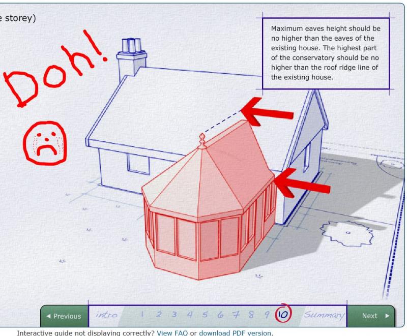

Appearances aside, the eaves are too high for it to be Permitted Development. It needs planning permission.
There's even a little picture on the Portal.
Hmmm I did spot that one in writing and wasnt entirly sure how to inturprete it (thanks for the pic).
So how about if we fit a box gutter and increase the eves/fasia hight on the house to 450mm? IM JOKING!!!!!
So if we were to lower the roof height we would pass?
