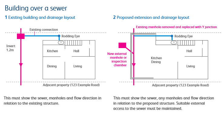

Can anyone help figure out a route for this drain?
Woody - you've confused me now. The drawing by our building regs chap has 2 bends with no chambers and you said it was ok other than the fact that it doesn't deal with the kitchen connections.
Also, the Thames Water build over booklet that I got the idea for my scheme from shows this which has a bend with no chamber:
Sorry, perhaps I should have wrote 'that' bend.
Strictly with drainage, pipe runs should be kept straight, and there should be access at changes of direction - a chamber normally. The over-riding principle is that changes of direction are potential blockage points.
But it's sometimes possible to design what are called 'slow' changes on direction (as under your new kitchen) which won't be a potential block point.
It's also sometimes permissible to change direction via a T or Y junction as long as you can get a rod in to deal with any future blockade - so not always a chamber.
But your situation would need a chamber either inside or outside the extension because of the angles involved.
That all makes sense. Thanks again for all your help with this.
There is a manhole outside the extension. With a 90degree bend you could jet/CCTV from the manhole to your downstairs toilet and clear any blockage.
If there was a fault on the pipe which needed digging up, it would need digging regardless of any internal chamber.
In the approved documents they just require all parts to be ridable roddable, not that the access has to be at the bend or junction itself. Our plans were approved where the junction under the house is roddable from a chamber just outside, which is similar to what you're suggesting.

Any possibility of taking the drain out through the L/H wall shown on the drawing to put the chambers outside?
naknah can you please post a more zoomed out pic showing all your boundaries? You said your house was L shaped with the implication that you're filling in the L but the plans show a cavity wall that I'd have expected to be internal if it was infill..
But the junction does. And where is that junction?
Sorry I didn't draw it out, basically it was previously my external soil stack then diagonally to the shared manhole on next doors half of the drive.
Now we built where the stack is, and it was drawn as our internal stack in a similar place, to a T junction under our house with the new kitchen drainage, directly through to their half of the shared drive and a bend with a new chamber on a 90 degree bend going directly back to the original chamber also on next doors land.
So a private T back roddable only from next doors land.
In the end the builder squeezed the new chamber on our half of the drive which in turn runs to the original main chamber connection on next doors land.
