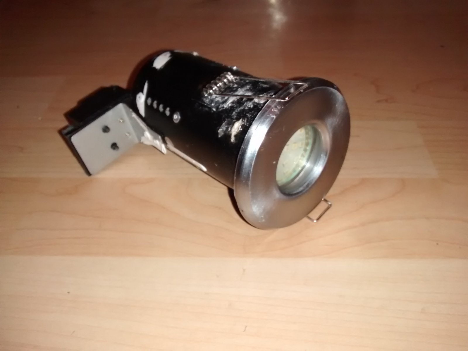

Can anyone identify these crap downlights ?

Well having moved house, the kitchen is (or was) fitted with TWELVE downlighters, but is so well lit that several times I'd be heading for the light switch and then realise that they were already on. Other times I'd be putting the cooker hood light on to light up the worktop. Absolutely crap lighting - not just the quantity of light, but the lack of light where it's actually wanted.
Having pulled one of them out to replace it with a cheap surface mounted light which instantly made the lighting better - I notice that the manufacturer is so proud of it that they didn't put their name on it :rolleyes: As there's an occupancy sensor to come out as well, at some point I'll have 13 big holes to patch :evil:
Just out of curiosity, anyone recognise it ?
No but is there a label visible when you remove the GU10 lamp?

The fitting dont look to me like crap, it has decent clips that dont break out the ceiling and the body looks superior to most as well as it also being fire rated.
More likely the wrong fitting for the job due to the lamp recessed back in the housing to give a more spotlight effect.
Looks like its got a poor quality led lamp in it too

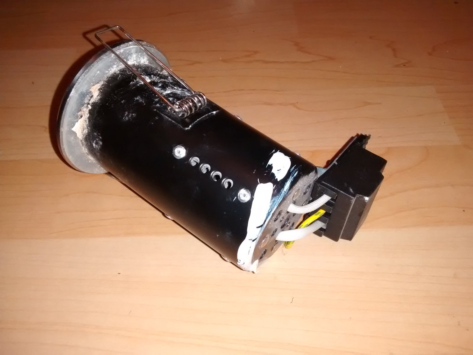

Thats quite a common style body, likely produced to be sold by many companies and not branded, image search brings up a few with the distinctive rivets and terminal block
https://www.ledsave.co.uk/brushed-chrome-fire-rated-gu10-downlight-fitting.html
Have you tried removing the lamp, there may be a label inside.
Ah, I hadn't looked that closely, didn't look like a removable lamp :whistle: Had a closer look, the bezel unscrews, and sure enough - a 5W LED lamp in it. 60W of LEDs and crap lighting. The fittings themselves do look fairly decent - solid bezel with fixed glass, screwed in, O-ring seal and gasket between body and ceiling.
Put just one of these up as an experiment and instantly vastly superior light - should need just 3 of them, half the power for vastly superior illumination. They are a bit cheap and nasty, but TBH they don't look bad and SWMBO is happy with it - will certainly do for now. She also prefers warm white - more like a traditional incandescent.
