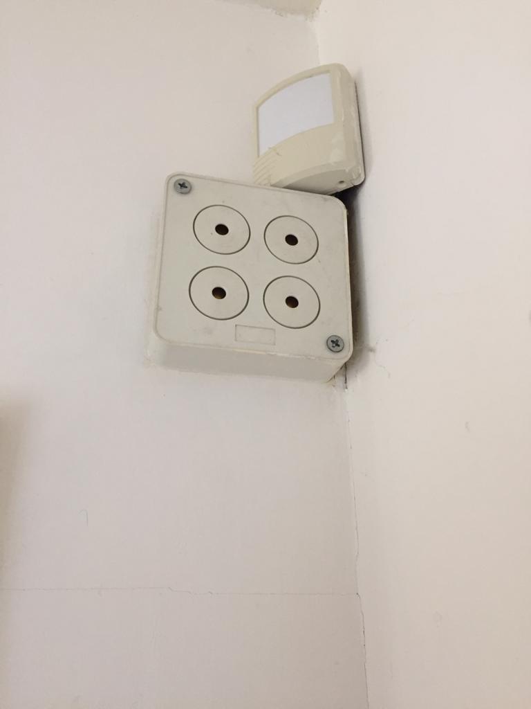

Hi,
Can anyone identify the block with four circles under the sensor? It's making an annoying buzzing sound apparently.

Just disconnect one of the wires ….they can have feedback when installed with some bellboxes ( they supply a resistor with some bellboxes )
