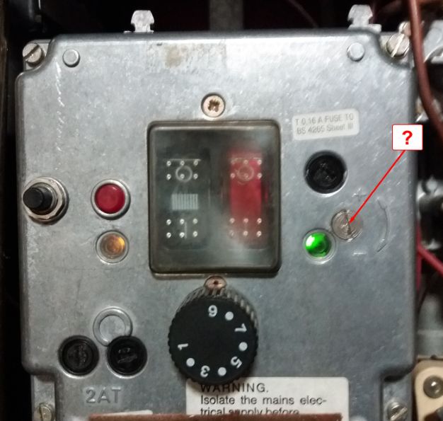

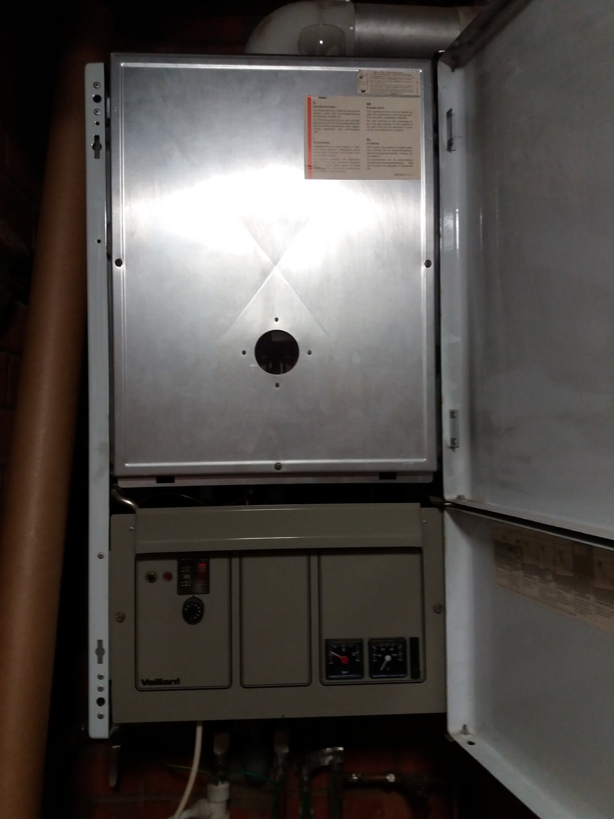

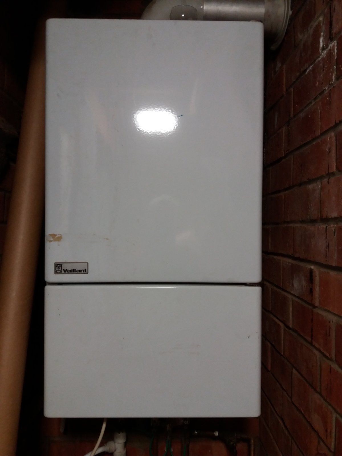

    My Valor central heating boiler, which came with the 1960's house I bought 5 years ago, decided to "play-up" 10 days ago
    What happens is that initially the boiler works perfectly, with the rads getting very hot (a little too hot to my mind as the rads smell as if the paint is burning - which never happened previously). Once the house is warm and the thermostat stops calling for heat, the boiler cuts-off.....which is exactly as it should be, of course
    But the boiler does not restart once the rooms cool down and the thermostat is requesting heat. To get the boiler running again, I have to turn the boiler off, and then turn it back on again. Once I've done this, it fires-up and works perfectly again....until the next time it cuts-out
    My heating engineer has already attended 6 times during the past 10 days, and has replaced the pump and a few other components - but the boiler remains defective in exactly the same way, and the engineer is struggling to come up with a solution
    Any ideas?
    Also, as I would like to find a manual for this boiler, could anyone identify the model for me?
    Thanks,

    Boiler is a Vaillant VCW 242

    Despite you identifying the boiler for me, i have been unable to find a manual, so I'm still struggling to understand how to make all but the obvious and very basic adjustments to the boiler. However, things have now moved-on a little . . .
    My heating engineer has attended again (7th time) and has somehow (but how?) adjusted the boiler so that the water temperature does not make the rads dangerously hot to-touch. He also managed to get the boiler to "work properly" inasmuchas it will now re-fire when asked to do so by the room stat. However......it will now only run for a few minutes before cutting-out (despite the room stat still calling for heat), hence the room temperature requested by the room stat is never achieved
    The engineer is schedulled to attend again (for the 8th time) on Friday, and is now confident that he can now cure the proiblem, having taken advice from both Vaillant and a local Vaillant-aware engineer. But in the meantime: Can anyone tell me what the "adjuster screw" on the pictured control panel actually adjusts? I'm looking for a way to adjust the boiler's cut-off temp, as it seems to me that increasing this slightly "may" allow the boiler to run long enough for the rads to become effective again, but without getting 'dangerously' hot....maybe! Of course if the engineer is successful tomorrow then the problem will be solved - but I'd still like to learn a little more about how this boiler works. If only i could find a manual! Ha ha!

    depending on age its a adjustable time delay for boiler coming back on after boiler stat turned in off anything from 1 to 15 mins,but its just a blank on some !
