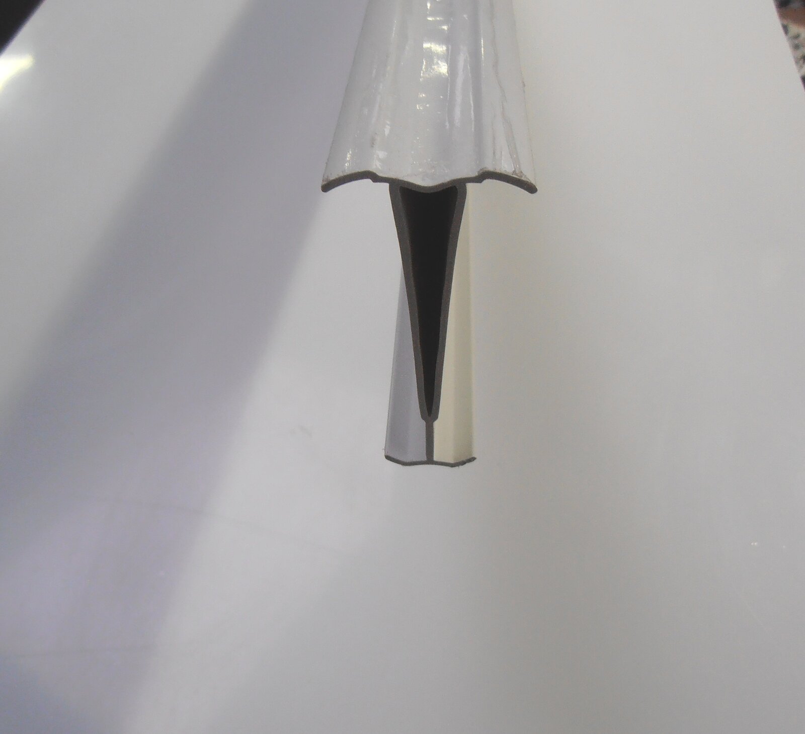

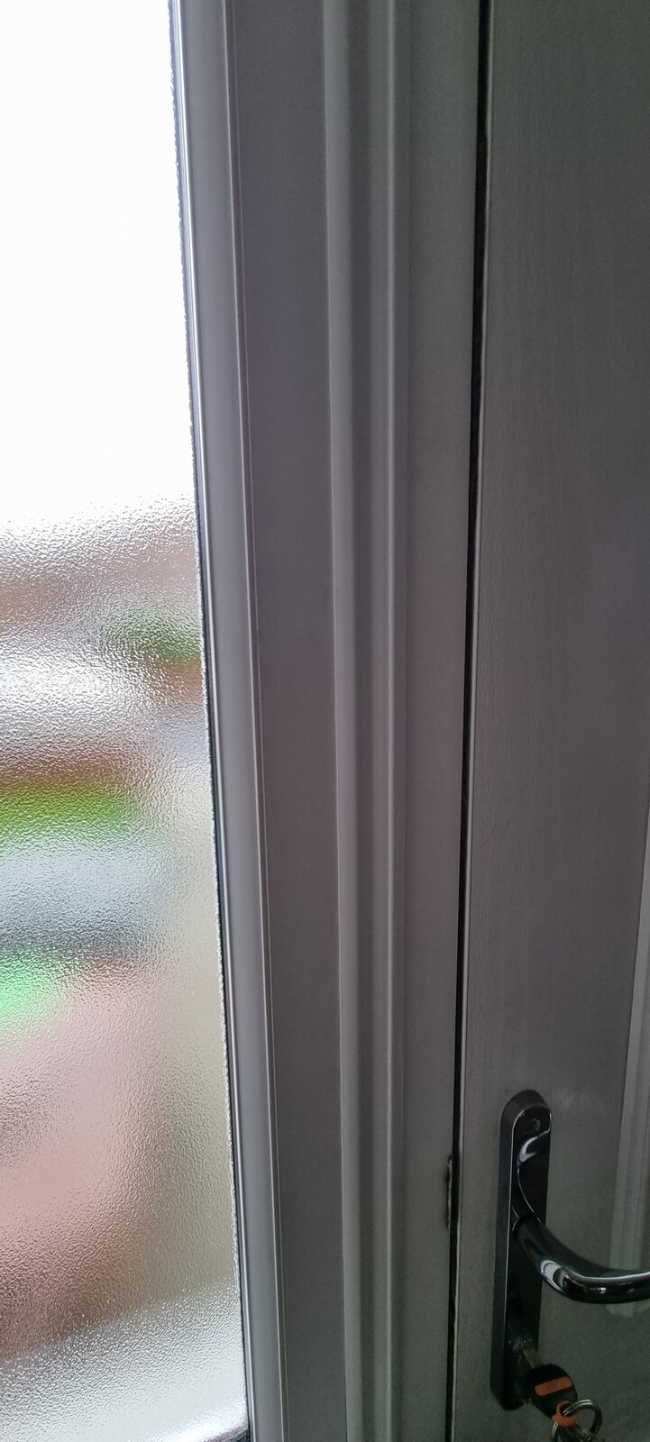

Just spent best part of 30 mins trying to Google to find this trim but I'm not sure what it's called? Any one help?
Hi,
As above, if it's the profile between the door frame and window frame, it looks to me (and I may be very wrong!) like a coupler bar. Something like:
(Although, this one is for a 170 degree corner).
There are lots of very similar profiles, some of them push into a metal post between the door and the window, some are just a piece of upvc which goes from inside to outside. The front view of the ones that push into a metal post look the same but the back varies a lot depending on the post design. I don't think you will be able to identify it without removing it and I don't think you will be able to remove it without breaking it unless you take the door and window out. What problem are you trying to solve?
