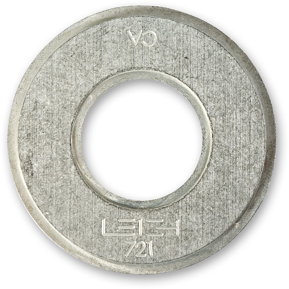

In no particular order, there's the Leigh 721 guide bush adaptor (this works with the Leigh dovetail jig guide bushes, but as they are P-C guide bush compatible they will work - and for anyone wanting to use P-C style guide bushes with any sort of router Leigh actually make quite a range of router adaptors):

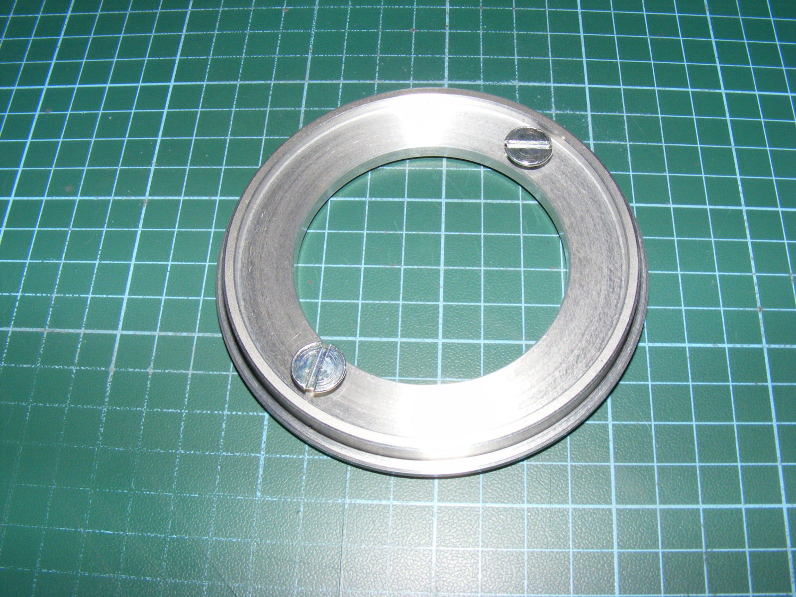

For anyone reading this at a future date, I got mine from Terrier Tools. Another source is to buy a low-cost Silverline Imperial guide bush set, such as this one:
These sets include a brass version of the adaptor (that's the big ring thingy with four holes in it). It should be noted that this adaptor ring also works in the plunge base for the Makita RT0700/DRT50 and Katsu trim routers (which is why I know of its' existence)
Another approach is to get a 3D Quality Products adaptor off eBay which allows you to mount a standard Trend/deWalt/Elu 60mm diameter guide bush (as supplied with the Trend dovetail jig) directly to the bottom of a big Makita router.
They also make adaptors to use the Trend/DW/Elu guide bushes on other routers including Hitachi, Ryobi, Erbauer, deWalt DW621/622/Makita 1100, etc that nobody else does. This is a small British business and I can thoroughly recommend their products.
