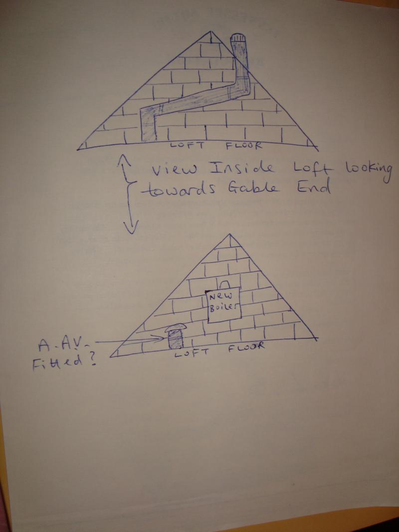

The pictures below show the view of the gable end wall from inside my loft. Its a bungalow.
At present, the soil stack vent enters the loft through the loft floor, crosses the loft in front of a breeze block wall where I want to mount a new boiler, and exits through the roof to the outside.
The pipe is blocking the wall where I want to mount a new boiler. Can I cut the vent pipe just above where it comes through the loft floor and add an air admittance valve intead (as in 2nd picture)?
I suppose I could do. Thought it would be less hassle than messing about with lead slates. Never fitted one before. Are they reasonably easy (I have done lots of other DIY)?
Would I be able to re-use the original lead slate, or buy new one?
I seem to remember "1 open vent per 6 houses minimum" so it might be worth a call to building control to check.
Your Plumber/ Registered Gas Engineer Should be able to do both jobs for you . and comply with all regs. :idea:
