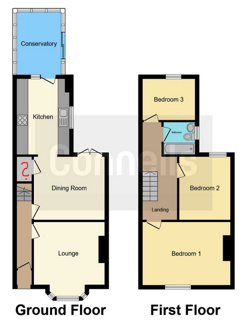

Below is the plan of a house I'm looking to purchase. Eventually, I'd like to add a downstairs cloakroom.
a) is it possible (easy) to add it where the question mark is?
b) any other/better place for it based on the house layout?
