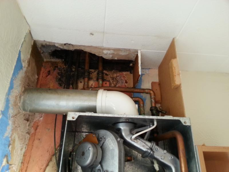

Hello All,
I have an ICOS M3080 24kw system boiler on its last legs. The Heat exchanger has started leaking and the boiler is now occasionally failing to fire up. As the heat exchanger would be costly to repair, and as the boiler is around 10 years old, it wouldn't make economical sense to get it repaired as I'm sure you will agree.
However, I am now in to minds whether I should move to a combi or stick with a gravity system. The house has 2 bedrooms upstairs, 2 reception rooms, bathroom + kitchen. In total we have 6 single panel radiators. We use a washing machine & gas cooker. The bathroom has a shower, and a crappy pump on the wall, so going combi would give us essentially better pressure upstairs, as well as save some space from the airing cupboard.
The question I have is would I need to have the 15mm gas pipe connection upgraded to a 22mm? If 15mm, are there any particular manufacturers that still do this? Would a 24KW output still be the one to go for?
Also how common is it for a heat exchanger to die before 10 years? I know people who have had there boiler's for well over 15 - 20 years.

A 24kw boiler within a metre of gas meter could be piped in 15mm , then again a 24 kw boiler 40 metres from gas meter may require 28/35mm (can't be arzed to calculate).
+1.
Your installer should be able to advise on the feasibility of the gas upgrade.

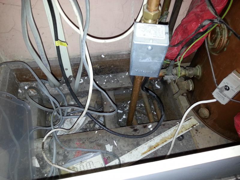

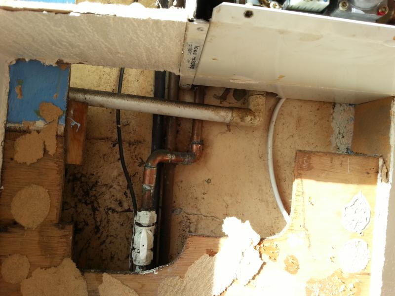

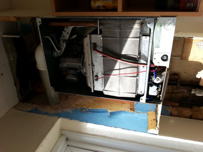

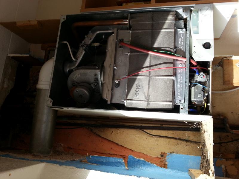

Its a conventional boiler setup F&E, tank, cylinder + pump.
Included some more side shots.

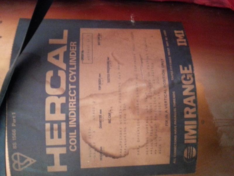

To be honest the cylinder is very old (pure copper) check out the image - it has no immersion heater so if the combi failed, it's no different to the situation at present. It'll also add further costs, but point well made.
:idea: That said to buy me some time for when it does pack up, and while I arrange engineer quotes etc. I could temporarily install an immersion heater with a thermostat? What length would this need to be? It appears it'll have to protrude from the side & not the top - I could also do this myself ;)

:LOL: You have managed to miss the pipe work we need to see....
We need to see your very first posted picture rotated round 90 degrees to see all the pipes and the pump.
