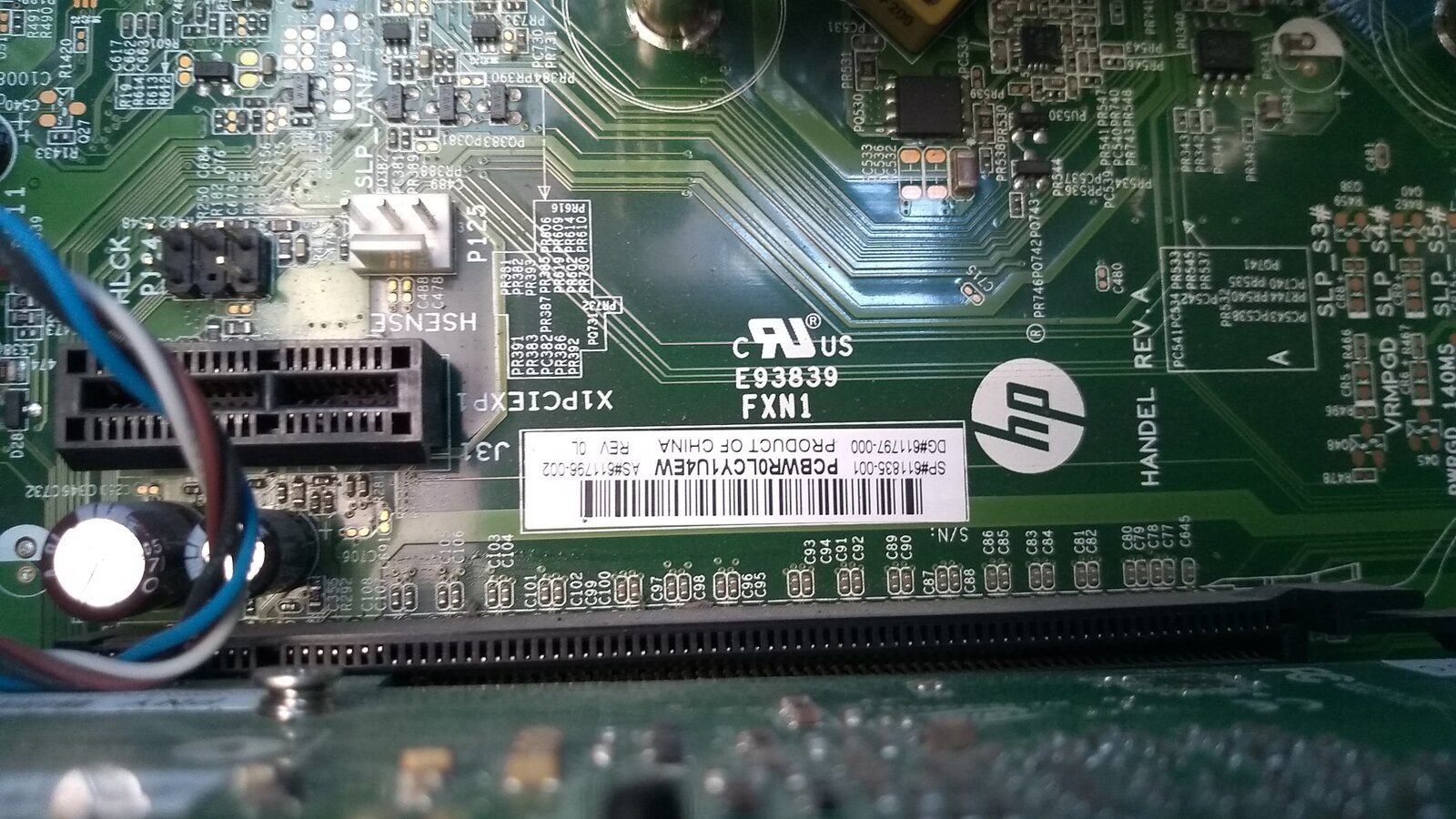

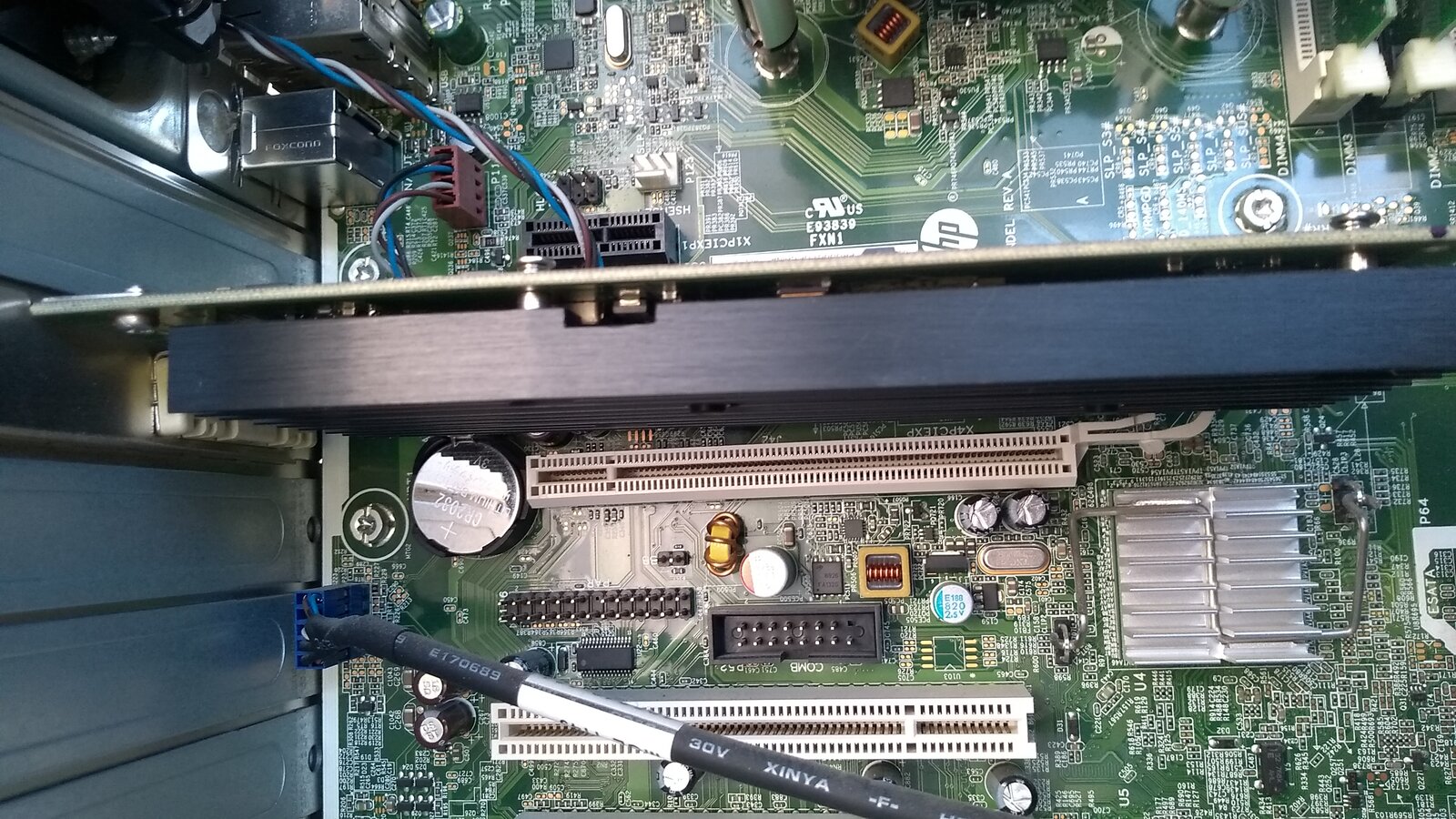

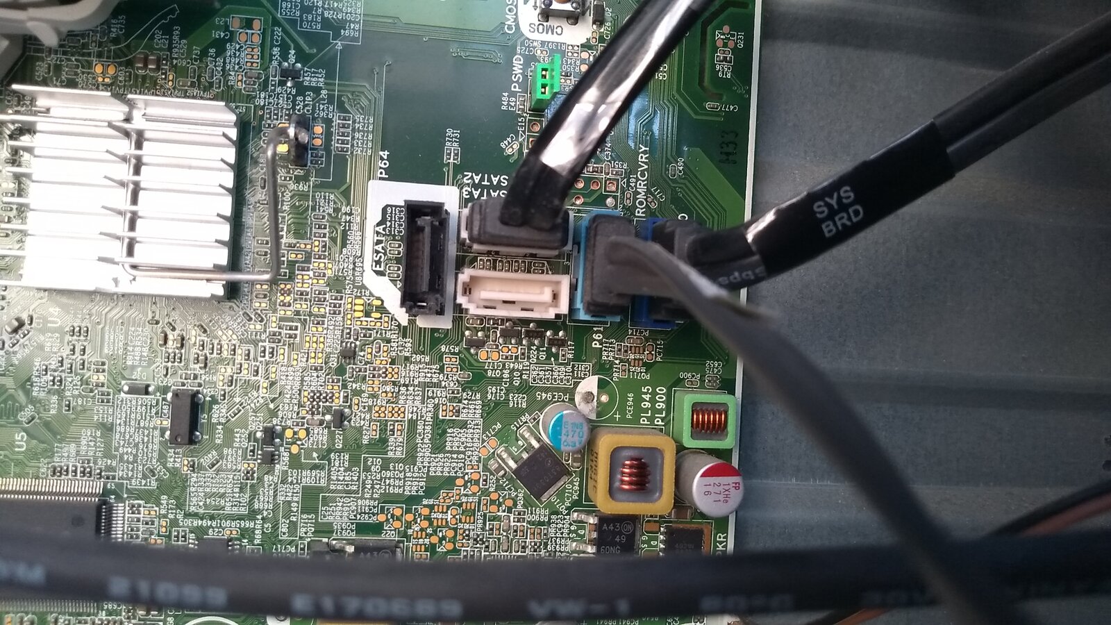

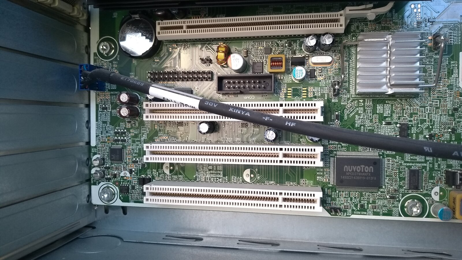

I took some pictures of the sockets.

So your board looks to have (Top to bottom):
• 1x PCIe x1 - small black one
• 1x PCIe x16 - Long black one with GPU installed
• 1x PCIe x4 - Long white one
• 3x PCI - white ones (old / slow)
So you should be fine to get a card with pcie x1 slot or upto x4 (its a full length slot but only capable of x4 speed)

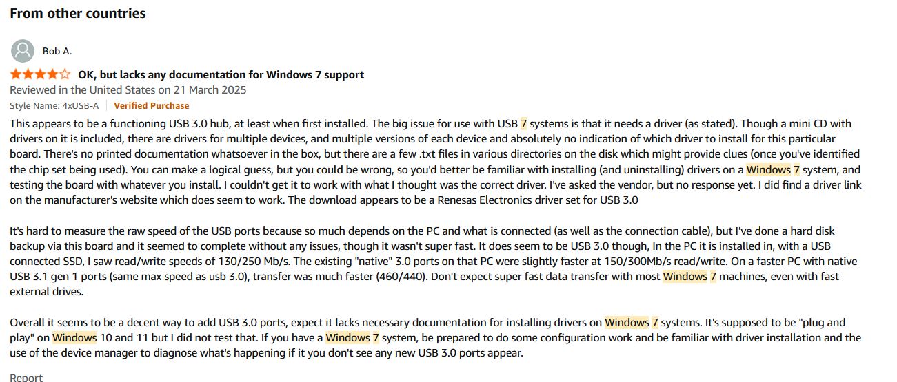

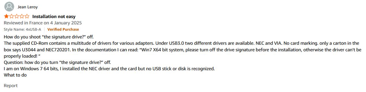

Also My system is windows 7 and reviews say they have problems finding and installing drivers should i keep looking for a card that has no win7 issues or am i going to face the same issue with any card.
