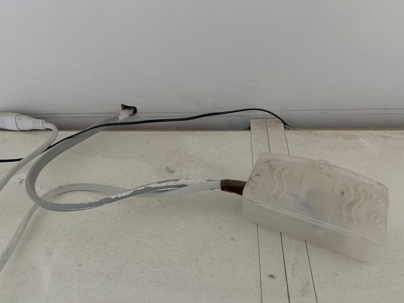

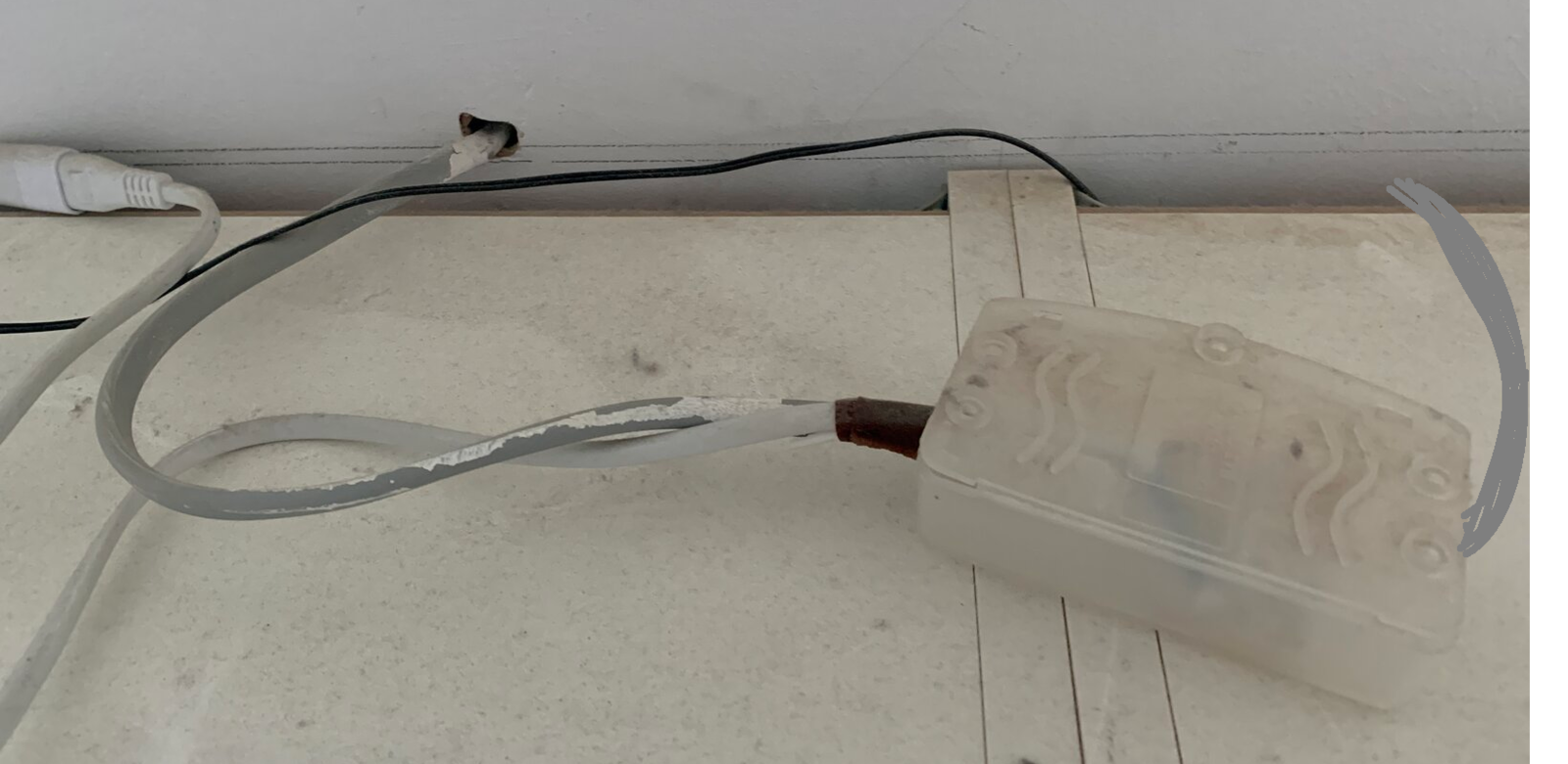

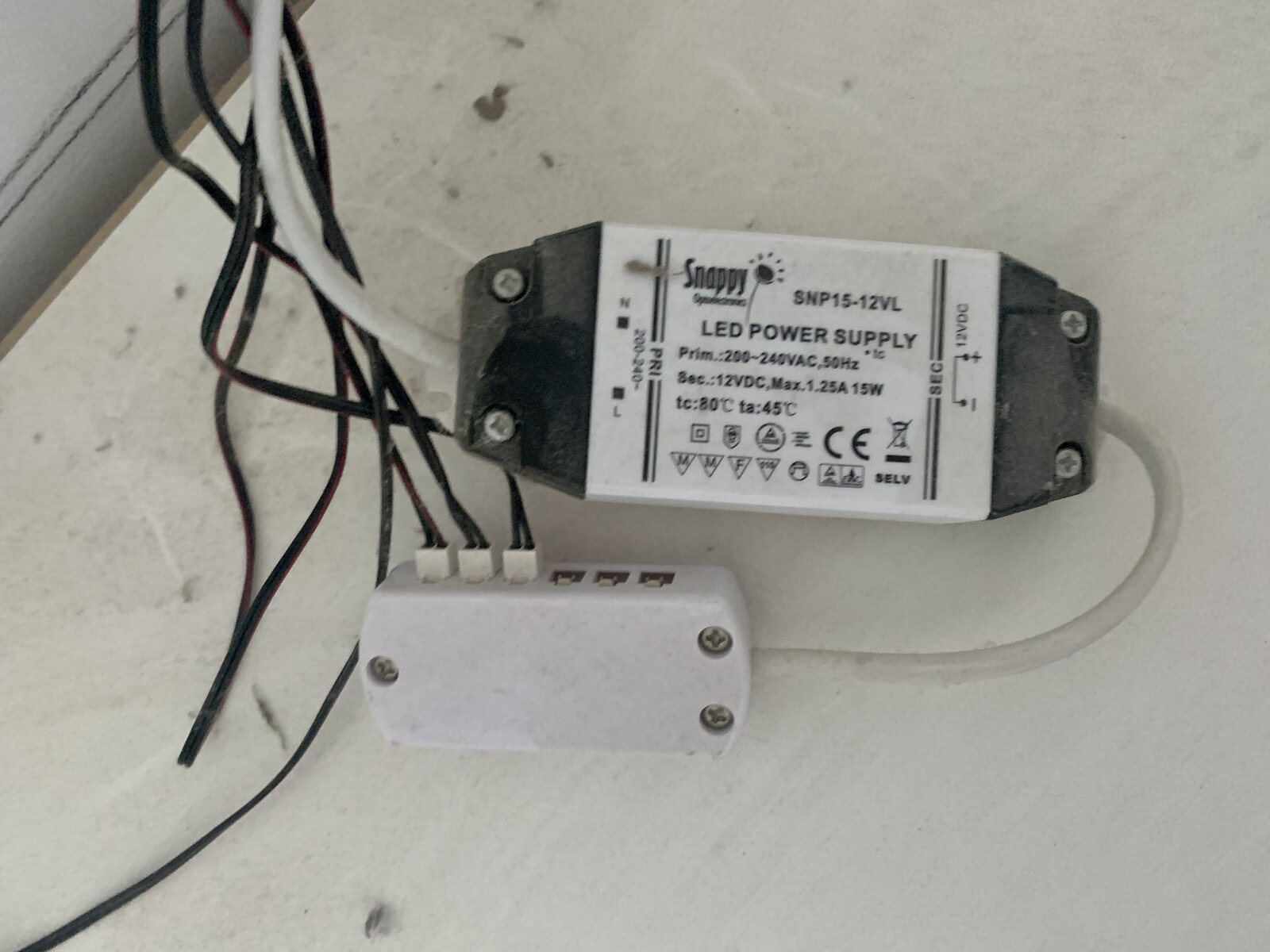

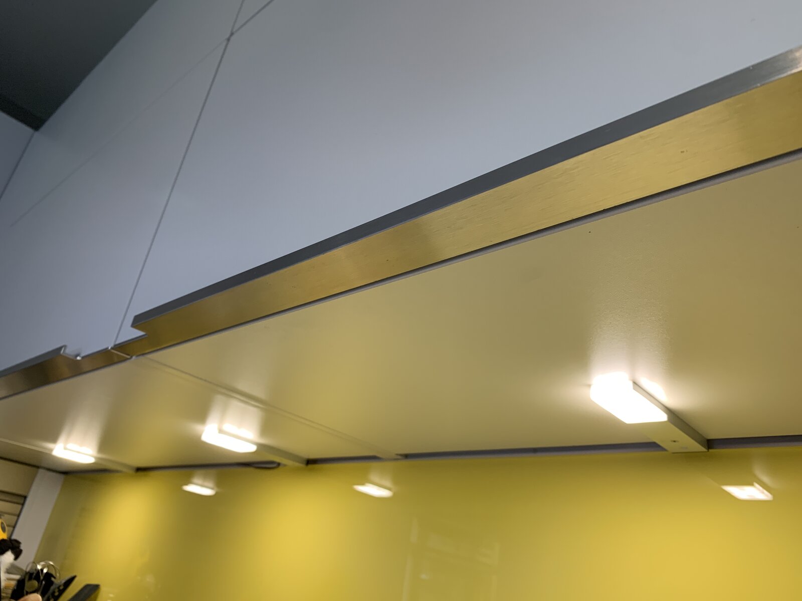

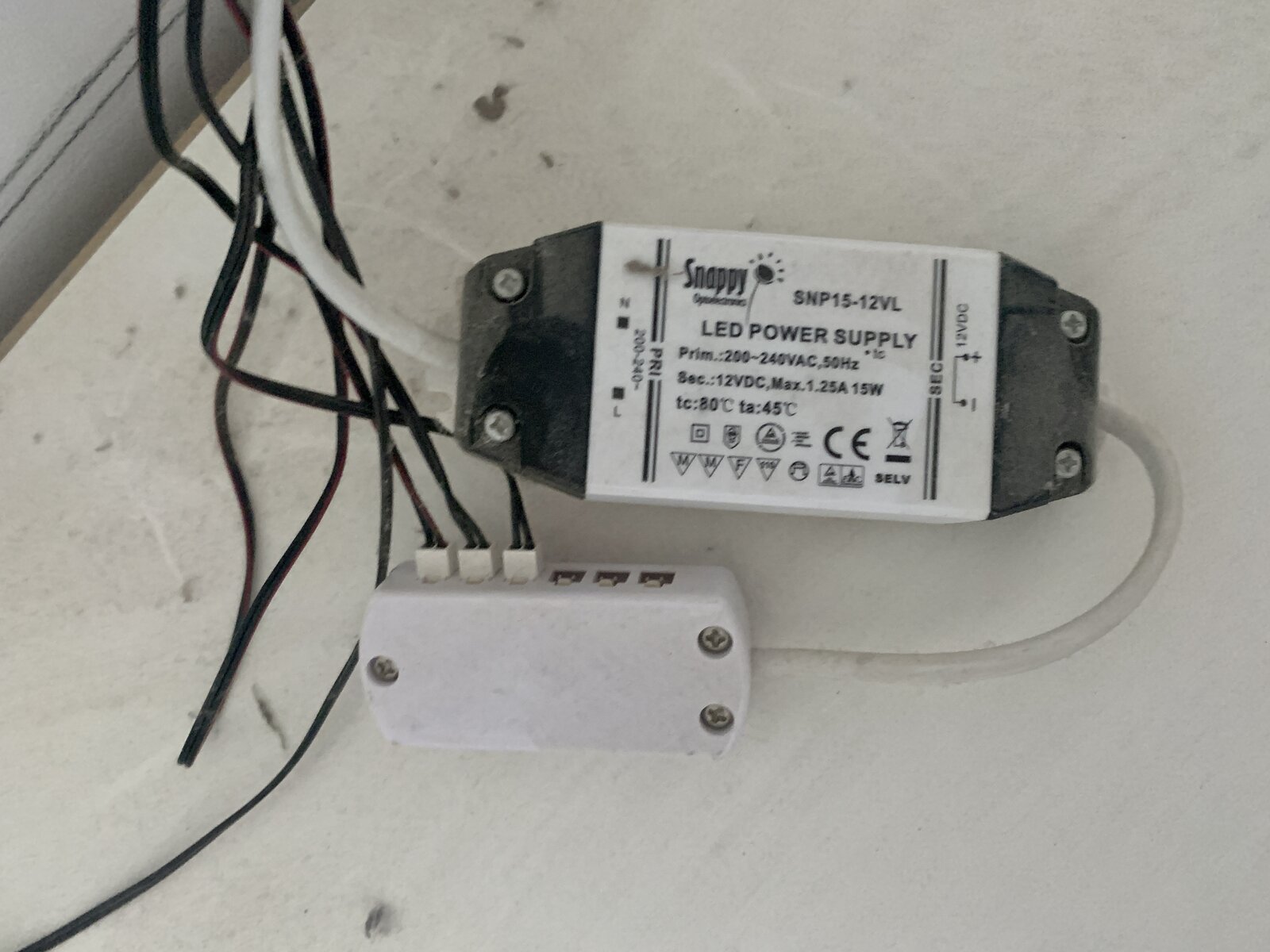

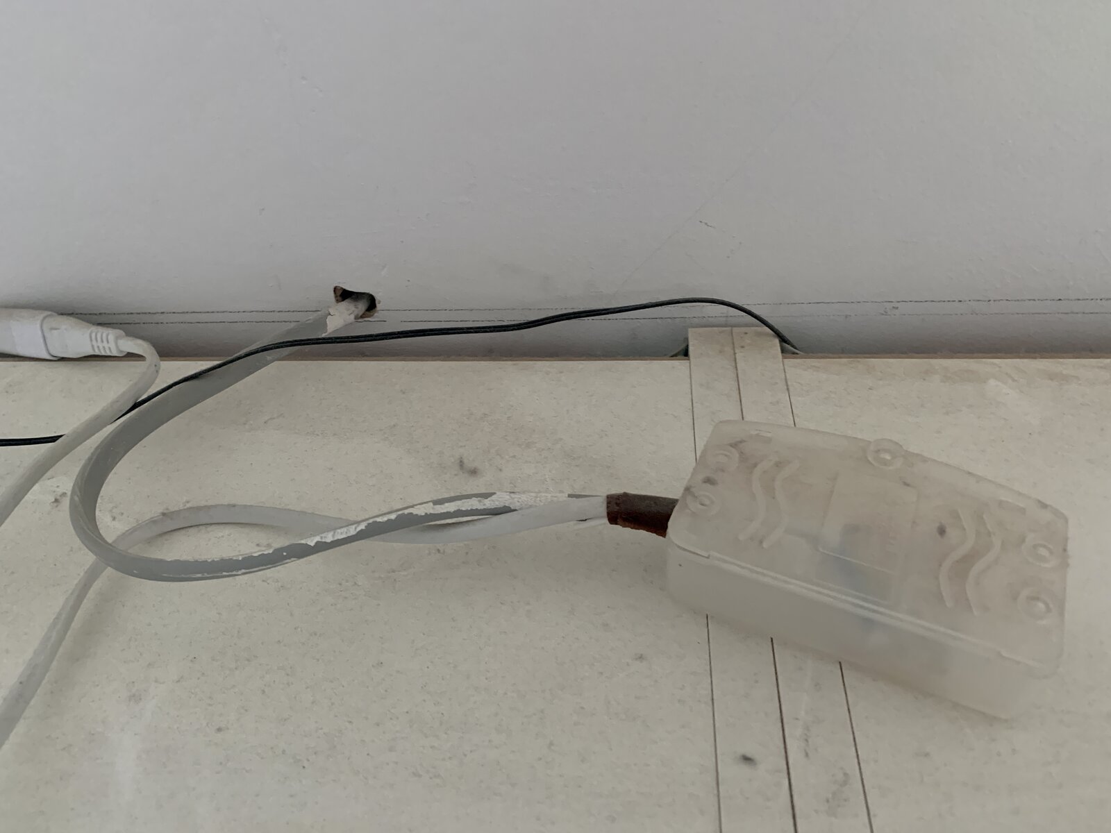

We have some under cabinet LED lights installed in our kitchen that are managed by a light switch that is on a wall in the kitchen.
Is there a way I could install a small rocker switch under the cabinet itself to allow me to switch the lights on/off as well more directly - ie leave the wall switch in the On position.
I’m not quite sure what I would need to buy if this is possible but I’ve attached some photos of the current power setup.

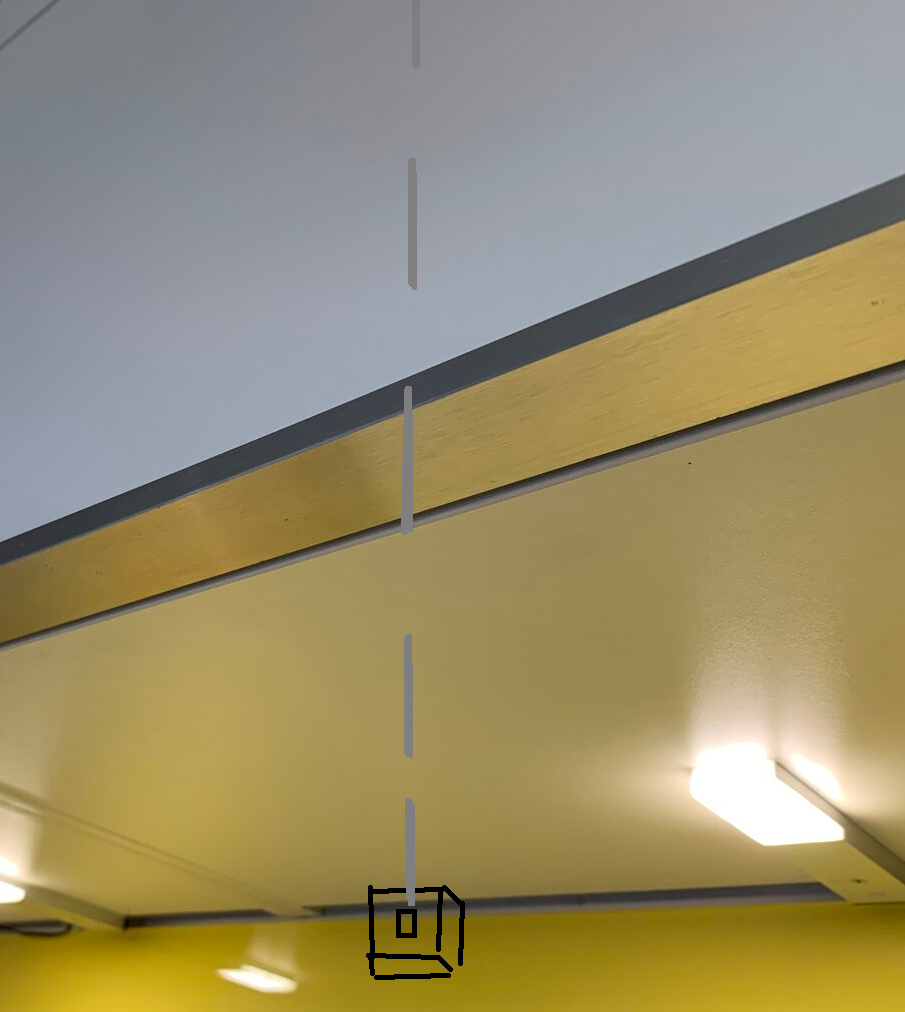

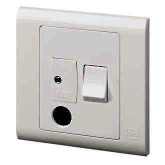

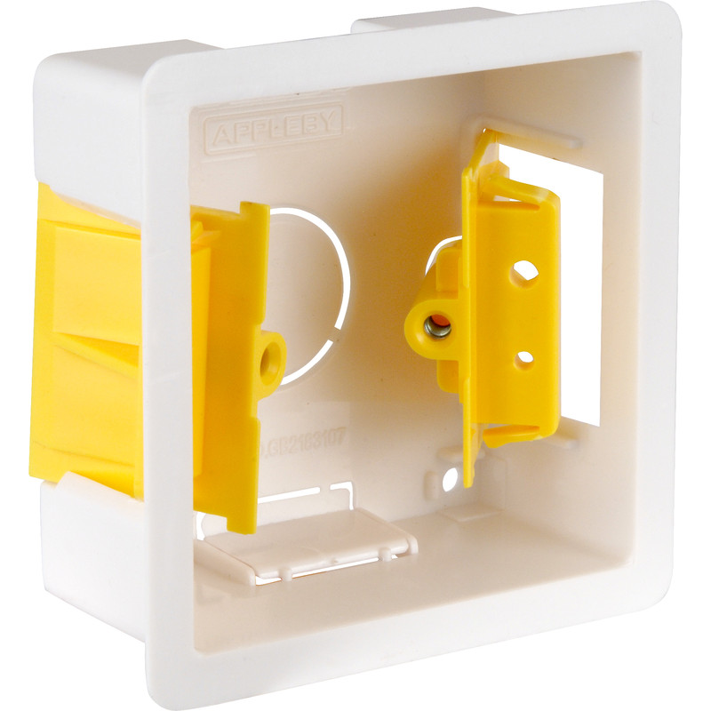

Yes I am sure there is, but as to how not so sure, personally I would want a unit as the wire comes out of the wall, be it a simple switch, or a FCU does not really matter, but this device could be a smart switch so you can use a remote control and would likely be a handy box where a junction could be made, some thing like this upload_2021-4-9_11-2-57.png dry lining box leaves plenty of room, and a FCU upload_2021-4-9_11-7-4.png can have a flex outlet, the fine details are up to you, as to work in a kitchen in Wales yes it is notifiable work, so in theory should be done by a scheme member electrician or tell the LABC but I suspect most don't bother.
Really the question is where do you want the switch?
It looks like there is a gap behing the wall units which will make this is a very simple job adding just a switch and short piece of cable.
Hi Sunray
Thanks for the response and yes something like the diagram you drew is ideal.
Just not sure on what sort of cable and compatible switch I need.
