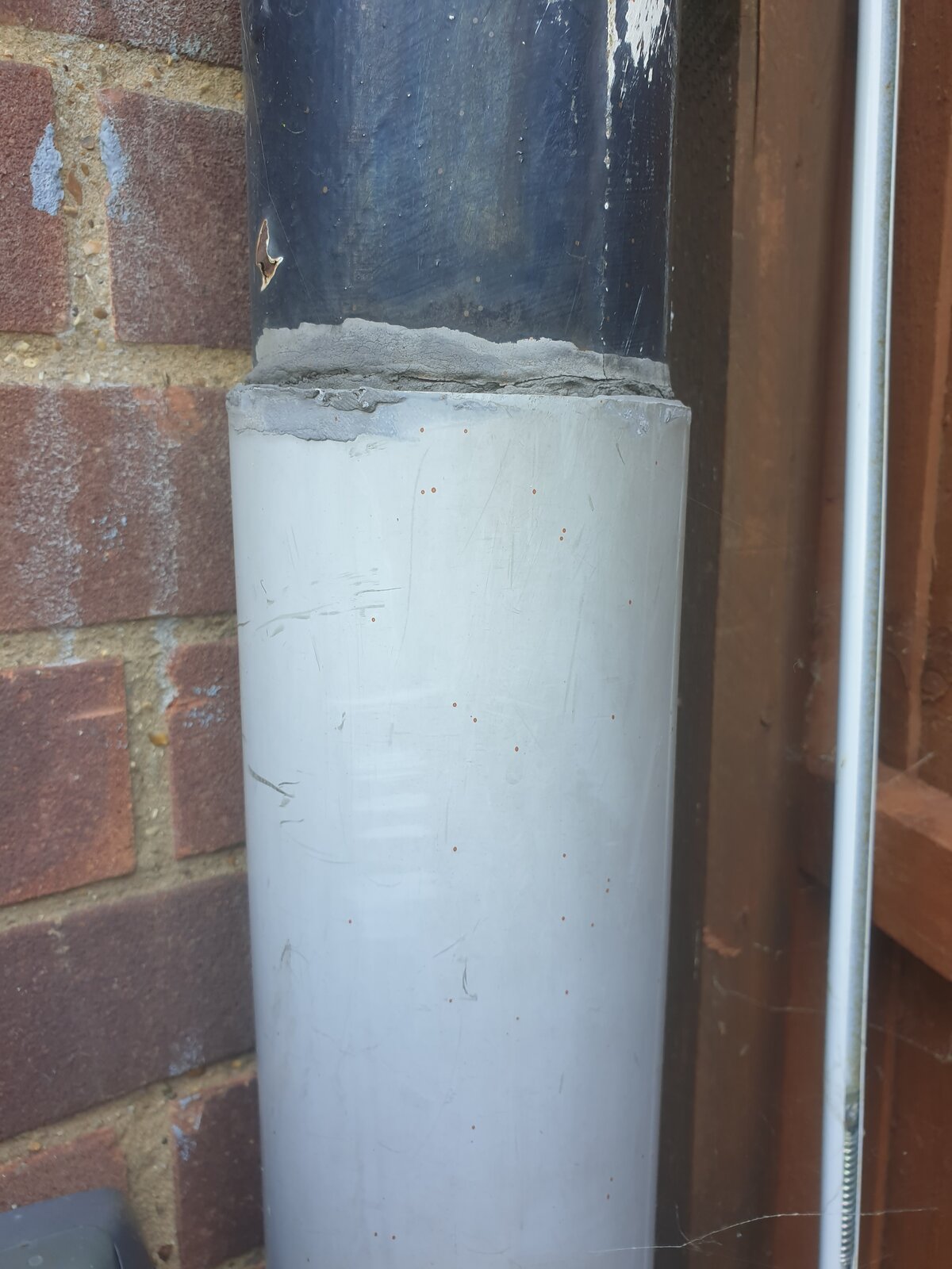

It can (or could) be done. I have a cast iron stack and a few years ago when I had a change around in my kitchen as well as adding a Saniflo, I cut out the bottom 6ft of my cast iron stack. I had a standard piece of plastic soil pipe and the plumbers merchants sorted me out with special collar to connect the two. I could then fit boss straps on it for the sink and the Saniflo. The standard cast pipe fitted inside the new plastic pipe. I ended up with this (needs a paint up but that’s been in my list for about 25 years lol).

Biggest concern with grafting a piece in to cast is the weight above. Cast can rely on the sections below to support the rest above, you need to make sure everything above is suitably supported before removing anything below. If it can be successfully cut into then I've seen the 'Flexseal' type couplings used to graft a plastic junction in, or alternatively, the Glynwed 'Timesaver' system allows easy jointing of cast iron, if you need/wish to retain the cast.
