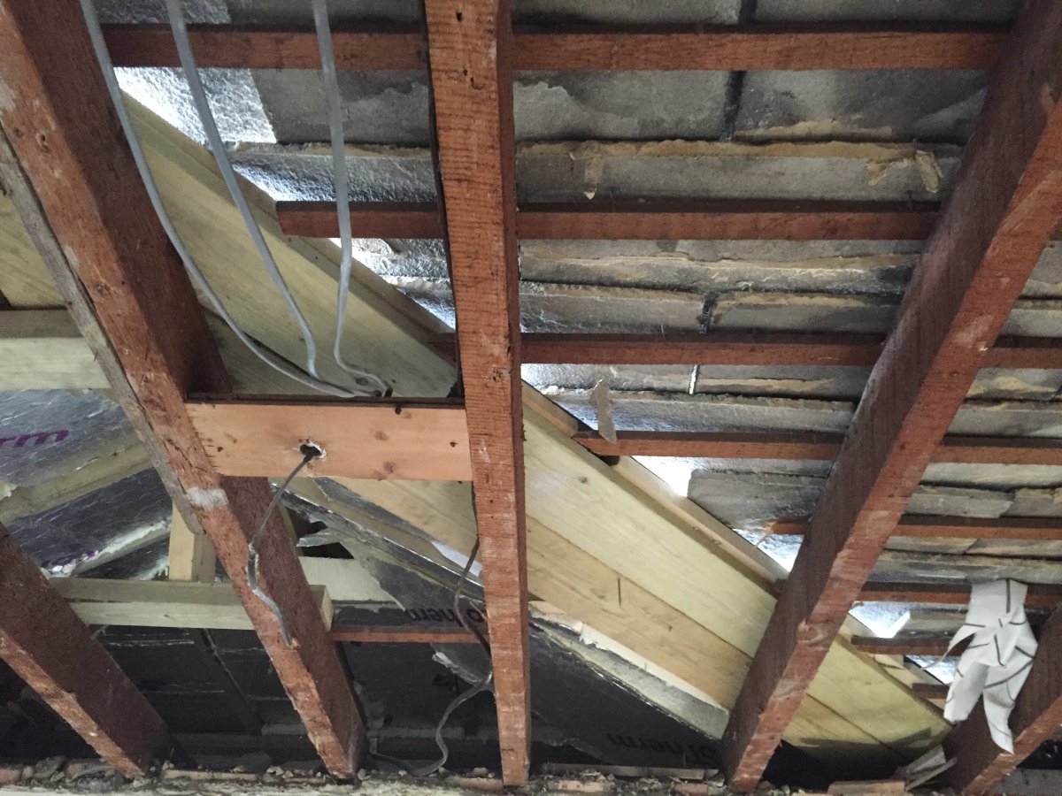

There are s few things but one I noticed yesterday is were they combined the new roof of my front extension to the old roof I can see day light and plenty of it

Is there no felt? Or are you hunting for problems? I can see daylight through bits if my roof but it does not mean that it is not watertight.
That's not a dry valley.
It's not acceptable no. There is no felt. Hence my question in earlier post.
In fairness the felt would have nothing to do with them as that's the old tiles to the right Were you can see day light towards the middle is my concern. This is were new roof meets old roof. I pulled ceiling down they were not to know I was going to renew the ceiling.
Bod
Irrespective of whether you had visual access or not, what they have done is not acceptable.
The valley they have installed is a standard 'wet' valley, meaning the tiles on both sides (new and old) should be bedded in mortar. A dry valley has a central up-stand to alleviate the need for mortar and wind blown rain etc. There should have been a run of felt beneath the valley in any case.

The insulation detail on any roof is either at or below the rafters. Anything that goes on above that line, i.e. felt, lath and tile level has nothing to do with keeping in heat. In fact, any gaps etc has the desired effect of ventilating any moist air that may migrate past any vapour barriers etc.
A typical detail would be tiles, battens, breathable membrane, 25-50mm air gap, 100mm Celotex between rafters with joints foil taped, 50mm celotex across rafters with joints foil taped and 12.5mm foil backed boards with skim.

Building Control will only be interested in the roof carcass and whether the tiles are suitable for the pitch. The quality of the tiling is not their concern. They may want to look at the insulation detail, but a lot don't. Has this job been designed or specified?
