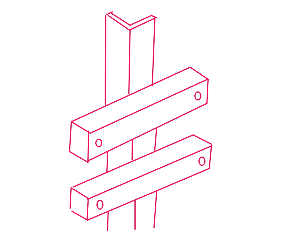

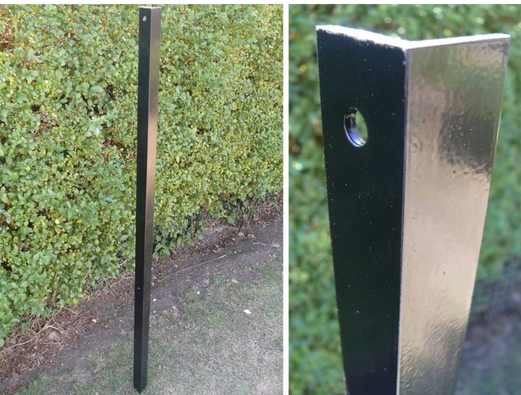

He's keen on installing his own post, but I'd rather, if possible, use one of the metal posts of the chain link fence we have. The posts are extremely solid, and are L-shaped like this:
From an electrical point of view, electrician said it was fine - he just wasn't sure how he'd attach the charger.
Looking at the installation manual https://a.storyblok.com/f/120859/x/...o-3-installation-commissioning-guide-2023.pdf - it seems it just needs to be screwed in on the four corners (about A5 sized).
Could I attached a small wooden panel with a clamp of some sort?
Or drill a couple of holes through and screw a wooden panel that way?
I think from the point of view of the installer he just has to be sure it's very solidly attached.
I would not make a panel out of wood it will rot in no time, if that is your only option get a piece of steel plate (preferably stainless). I also hope the site is not exposed as you could have problems with wind

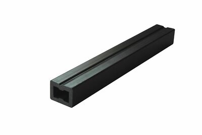

If you must use that post, use a composite material panel that won’t rot or discolour

Any board should be weather resistant. So alternatives to FMTs suggestion would be a thick piece of uPVC or cement board cut to the shape of the charger.
