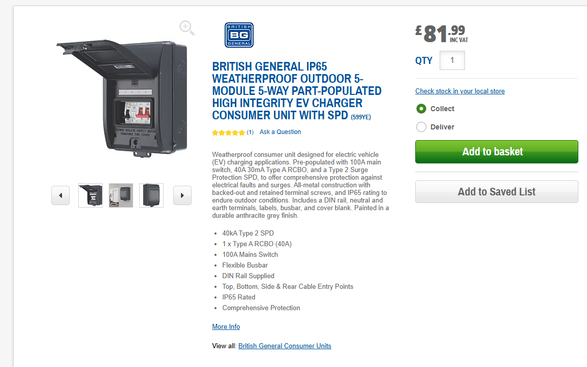

The CU below is the one that was fitted for my installation and (grabs popcorn) was fitted in the meter box. I believe that's now heavily frowned upon.
