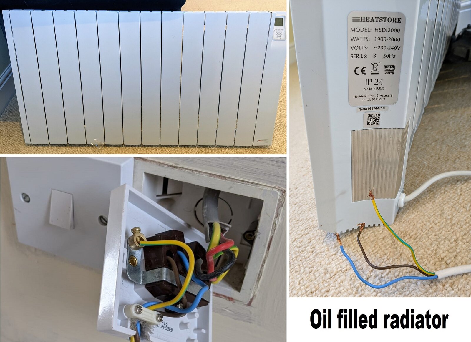

I would appreciate any advice on wiring a plug to a heater.
I recently moved to a new apartment and removed a storage heater and an oil heater that were wired into the wall rather than plugged in. Both had three wires intersecting with three wires from the wall that I guess were related to the economy 7 set up.
I’m not on an economy 7 and didn’t want the big heaters taking up space along the wall so I removed them and left the wall wires connected to the intersecting plates (as you can see the prior disconnection pic in the oil heater photo) then decorated over the wall space with no issues.
Now that it is getting quite cold, I want to use the oil heater for a few months but don’t want to have it screwed to the wall and permanently wired back up.
So my two questions are:
1. question is: can I just wire wall plug onto the three wires that come out of the wall heater that you can see in the picture and use it as a plug-in heater?

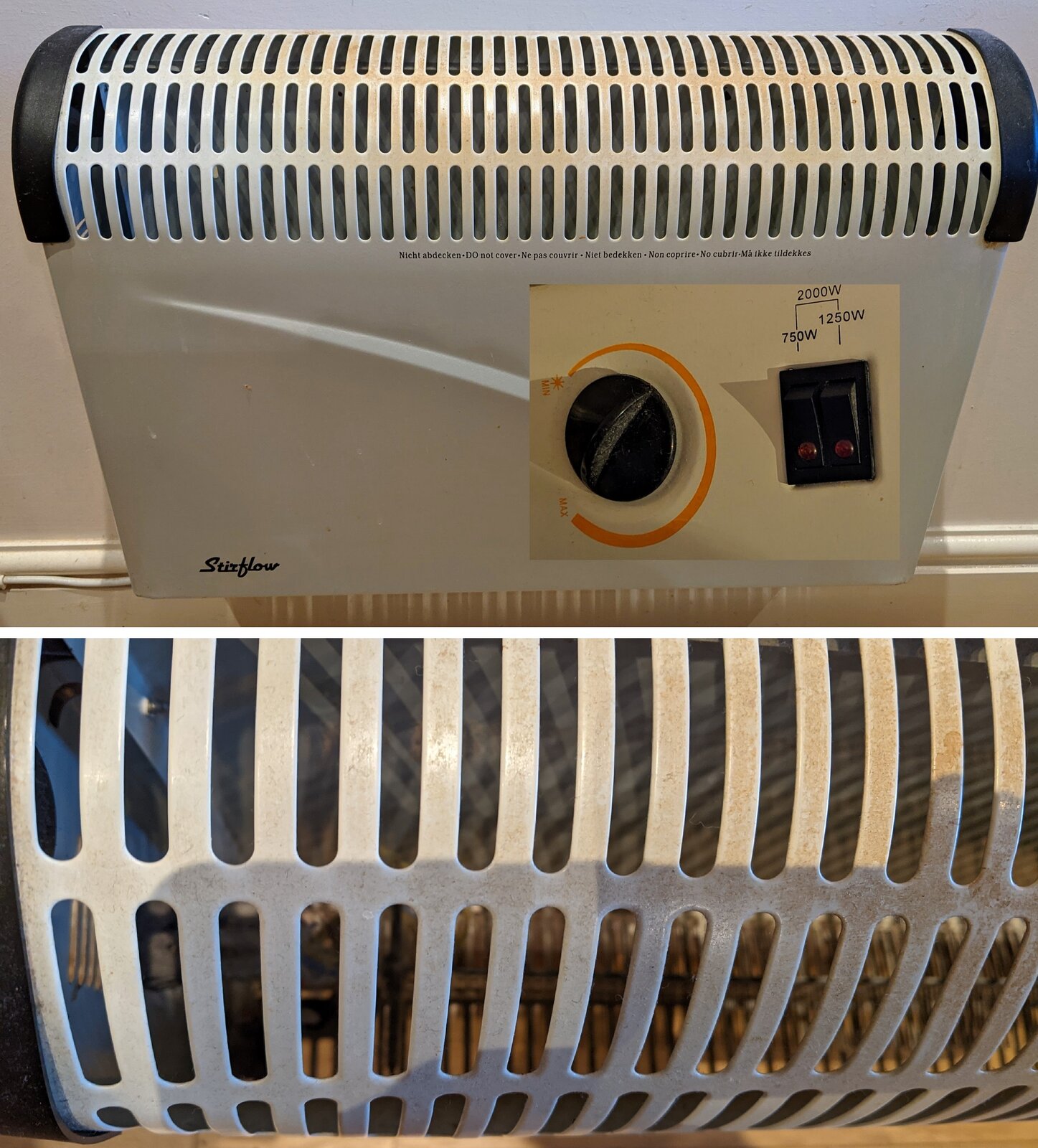

2. At the moment I’ve been using the kitchen heater as it’s a galley kitchen with an open doorway to the living room, but that heater has some kind of element in it as you can see in the picture and is very expensive to run for long durations.
So, my other question is: Will running the big oil heater be cheaper than the kitchen element heater? Or if it’s the same kilowatt per hour usage. And Question 2.1: Even if the oil heater will cost the same as the kitchen element heater, will it generate more heat for the energy used?

In principle yes, just bear in mind wall mounted heaters aren’t designed / tested to be deemed safe used as a free standing heater. I believe the rules may have changed some previously sold freestanding heaters are now only available with wall brackets.
no, all electric heaters are equally efficient. They all turn 1kWh of electrical energy into 1kWh of heat energy.
A more powerful heater will run for less time to get your room equally warm, but will use the same energy.
An oil filled radiator has a time lag and can heat a room more evenly, but it takes time between turning on and getting fully hot, and between turning off and getting fully cold. It does not emit less or more heat per kWh.
An oil filled radiator will not start a fire if you accidentally drop a newspaper on it, or a curtain blows against it.

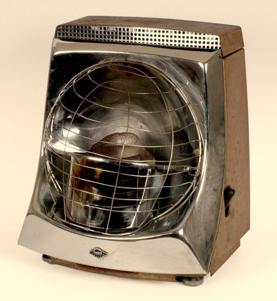

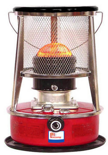

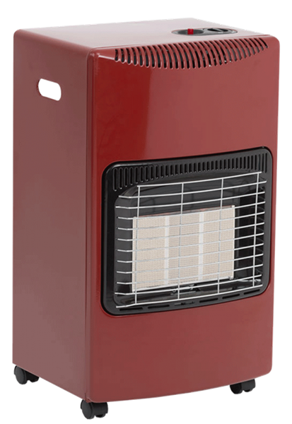

I have not seen an oil heater in years. The gas version upload_2021-12-2_10-42-54.png seemed to have replaced them, I remember Esso Blue and smoke gets in your eyes with cheaper grades I tried. Also seeing my school friends walking down to the local store to get bottle filled. It seems you can still get them upload_2021-12-2_10-46-42.png however in both cases they fill the home with moisture, OK for an emergency, but any flue-less heater makes the home damp.

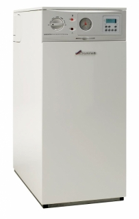

I do heat my house with an oil heater but it has a flue, in fact a balanced flue, seems odd name, it means it draws combustion air from outside so does not cause drafts. But one of these upload_2021-12-2_10-52-47.png I am sure is not what is mean by a

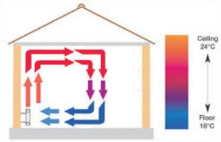

The oil filled radiator stores the energy so switching on/off it never gets cold so removes the hysteresis. But as to economy the position is important. This is clearly old circulation2.jpg before the days of double glazing, but the circulation circulation3.jpg is still important, I see this with my hall, and wonder what was in the mind of the builder to wire a wall thermostat in the hall opposite end to front door and radiator, how did he expect this would give a general reflection of the rooms heat?

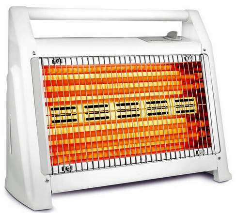

This upload_2021-12-2_11-3-30.png is likely the most economic type of heating, the more bars the better, as when you turn off a inferred heater the heat stops, so selecting 1 to 4 bars is only real control, air thermostats don't work. So some thing like this upload_2021-12-2_11-8-15.png will likely be cheapest method, as long as not aimed at windows, inferred will pass through glass, but there is clearly a fire danger, and also does not really look very good.
