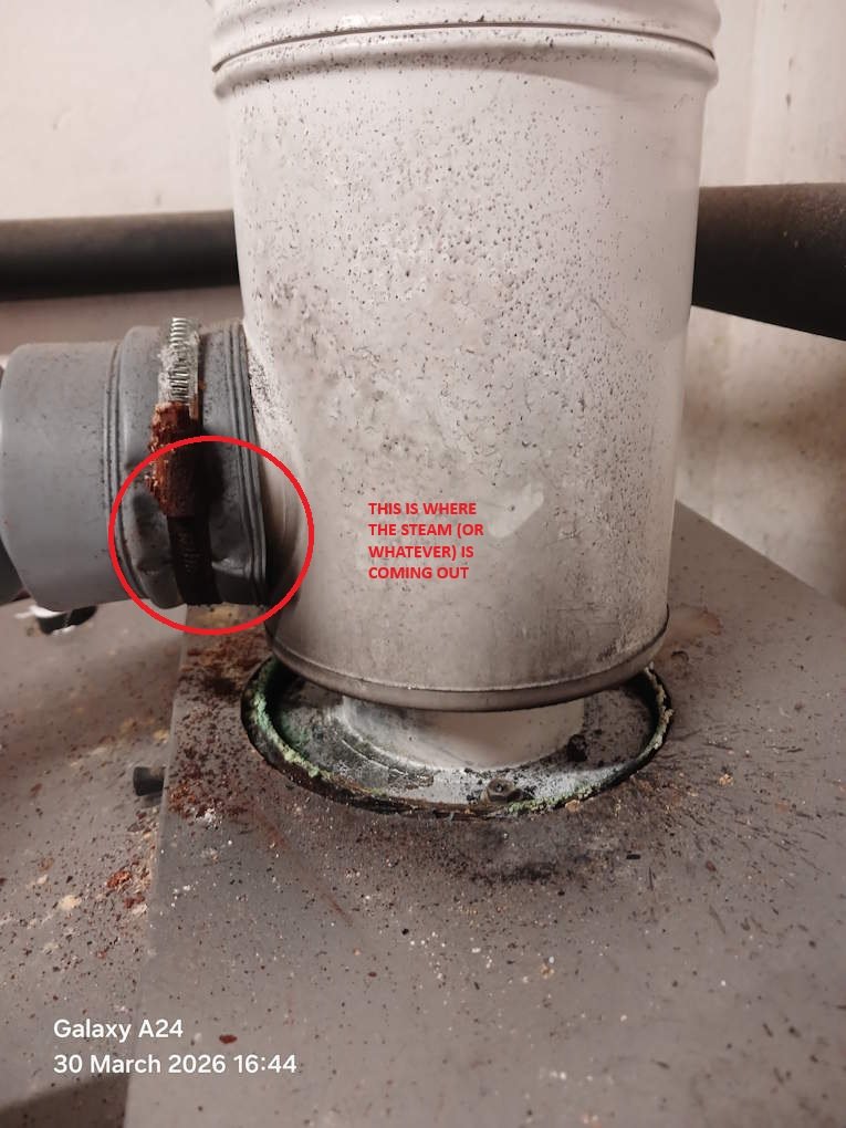

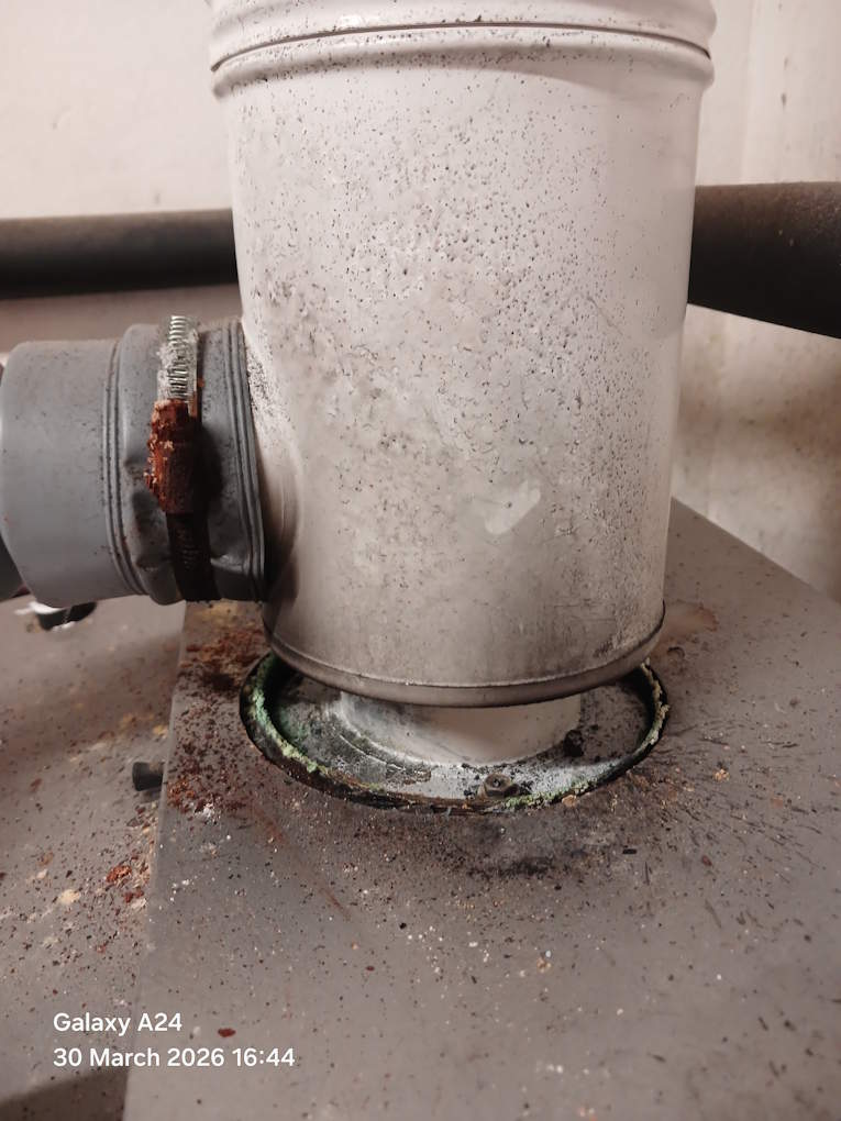

Can I replace this hose?
8 Jan 2009
937
49
Glengormley

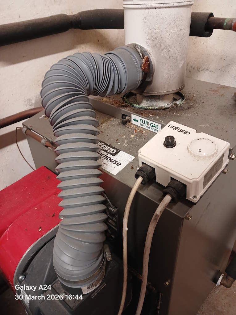

Just noticed there's exhaust gas leaking out from where this plastic pipe joins the flue, and it looks a bit knackered.
It *LOOKS* like a simple question of turning it off, undoing the Jubilee clips, and replacing the hose.... am I right, or is there more to it than that?
If I can do it, where might I get a new hose?
Thanks :mrgreen:
Sorry, it's a Riello burner on a Firebird boiler.
I would think it would need testing before and after by a gas safe engineer to ensure there are no leaks anywhere
If you really have flue gas leaking from that joint you have a problem.
The plastic hose is a air duct!
Burner out smoke pellet in stick burner back in quickly.
See where smoke leaks out.
Sorry, me not knowing what I'm talking about as usual. It might be steam coming out - is that likely? Come to think of it, there's no smell of fumes in the garage... the big plastic hose seems to be leaking where it joins the actual burner - I can see what may be vapour coming out?
You won't smell the nasty ones, for example with carbon monoxide you'll just drift off to sleep and not wake up.
Yeah that's true. Good thing I don't often sleep in the garage...
And of course the CO detector :D
So what is that pipe for? Seems to connect to the kind of jacket of the flue, so maybe nothing to do with exhaust gases at all...
If you have visible water vapour swirling around the bottom of the boiler then it could be a leak from one of the water pipe connections.
Yeah, they say it's a common problem with these. Booked in for a service in a month's time - soonest I could get :rolleyes: and they'll replace the hose on the day.
