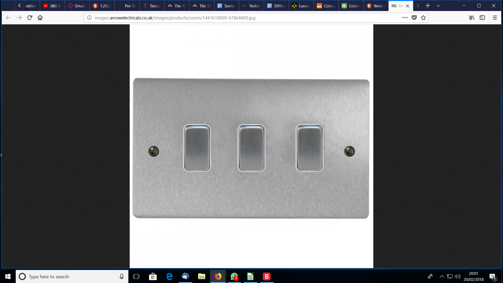

I’m going for the three gang switch on the two gang plate. Any suggestions for quality chrome switches and sockets or shall I just get what B&Q have on their shelves? I need 1x3 gang switch, 3x1 gang switches, 1 single and 1 double socket.
I'm not sure the above is common, without using a grid system.
Most are a three gang on a square plate.
Are you looking for Matt Chrome or polished?
