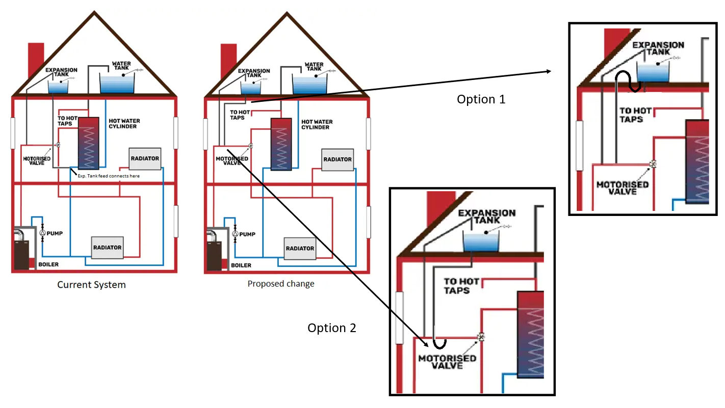

Can I reverse my CH/HW Pump
Last recommendation you made was "Don't forget to make your new cold feed up-and-under, to reduce convection warming of the F/E tank and encouraging algae growth".
I'm thinking this is a S bend to stop the convection heat going to the expansion tank. Just wondered as opposed to do it at the expansion tank "Option 1" whether I could do it at the Boiler feed side "Option 2"
I've done a diagram to illustrate both options. I'm hoping I've made the right assumption.
Yes, Option 2 is the usual way, exactly what I had in mind.
Hi, just wanted to say all working. Better than it's ever been.
Thanks for all your help
Was your original system working OK without any problems?.
Is your boiler oil or gas fired?.
Original set up resulted in warmish radiators. Now they are a lot hotter. No adjustment to the boiler, just seems to be working as it should.

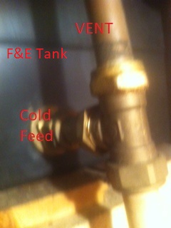

My oil fired (S plan) system layout is somewhat similar but has a combined Vent&Cold feed (below) installed over 50 years ago with somr rads over 40 years old, one, in the attic converted bedroom, does run under a very slight vacuum but its never been a problem, on the odd occasion that I check its vent with the circ pump off I get water immediately. It would be interesting if the OP checked his bedroom rad vents while running especially if the boiler is gas fired which have a far greater HEX resistance compared to a oil fired which has practically none.
Even the recommended VCP, Vent, Cold feed (within 150mm of each other) then Pump; sometimes suffer from pump over and have been "cured" by combining them.
