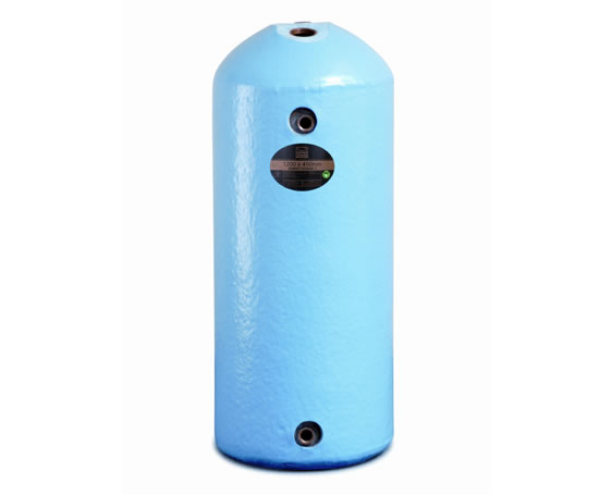

Have you got an unvented cylinder ?
Boiler heats the hot water, it will have no bearing on the shower. For that type of shower to work correctly will depend on the vertical distance between the bottom of the cold water storage cistern (this feeds the hot water cylinder) and the shower head. Greater the height of the cold water storage above the shower head means better the pressure from the shower.
Depending on your setup, that type of shower may prove problematic. They require balanced supplies (i.e. hot and cold water at the same pressure), otherwise it is very difficult to set and keep the water at a comfortable showering temperature. If cold water is mains fed, and hot tank fed, then the cold is likely to be at a higher pressure than the hot, so you may find shower is either boiling or freezing. Only solution would be to fit a dedicated cold supply to the shower fed from the cold cistern. (Assuming there is adequate height between cistern and shower as explained above.)
Otherwise you would need to look at a 'Venturi Shower'. These use the (higher) pressure from the incoming cold to 'boost' hot flow into the shower thus giving a more balanced supply, or fit an electric shower using mains cold supply. Electric shower would also need an electrician to connect power supply though as needs a dedicated supply directly from the consumer unit (fusebox).
A system boiler means that the water for the rads is sealed in and pressurised - so you don`t have a small feed+ expansion tank on that part of the system . The hot water cylinder you have described/linked to has a feed cistern * somewhere * above it to supply water to your taps - so if you can find it in the flat , near the ceiling in a cupboard - you won`t get that shower mixer to work :cry: BUT if it is fed from a large cistern in/on the roof , which feeds the hot cylinders and cold to baths in the other flats too - then your shower will work :D . And the nearer to the ground floor your flat is - the better the pressure to your shower will be . That`s a basic outline for you . Luckily I`m not watching the football match :wink: Just seen that Hugh is not glued to the tv also :lol:
