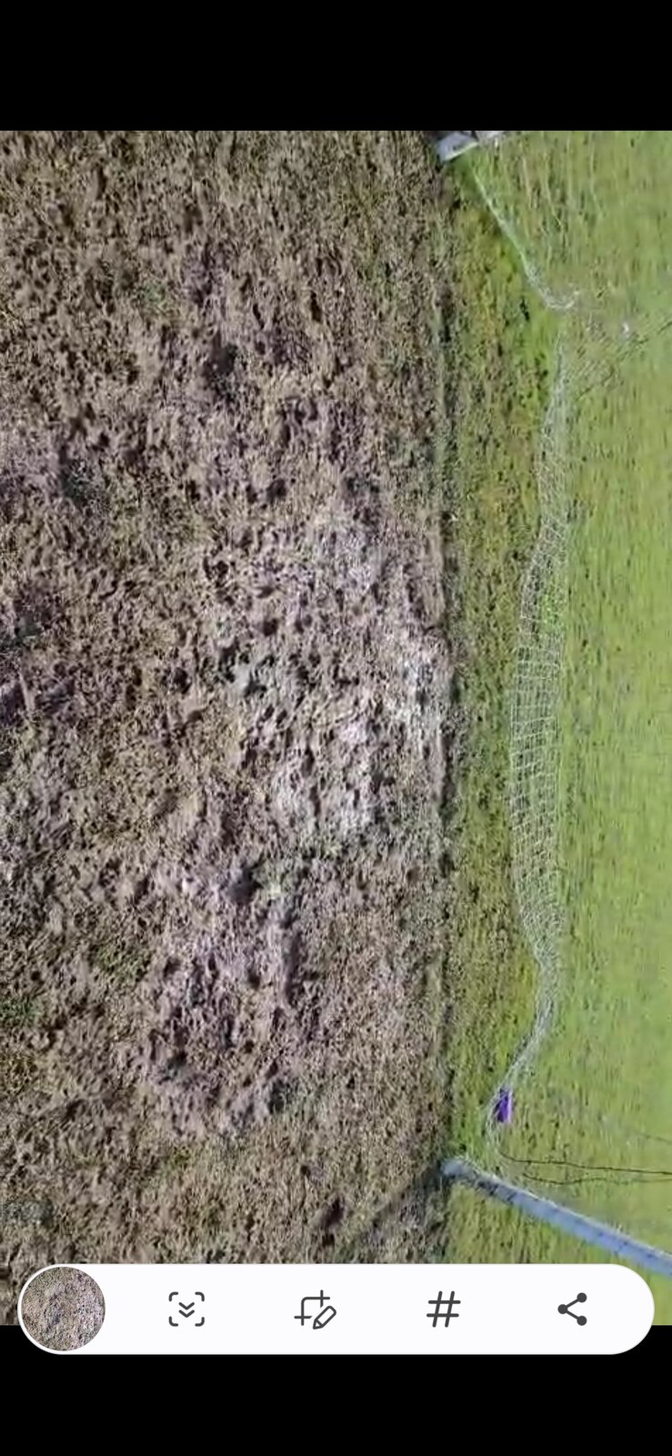

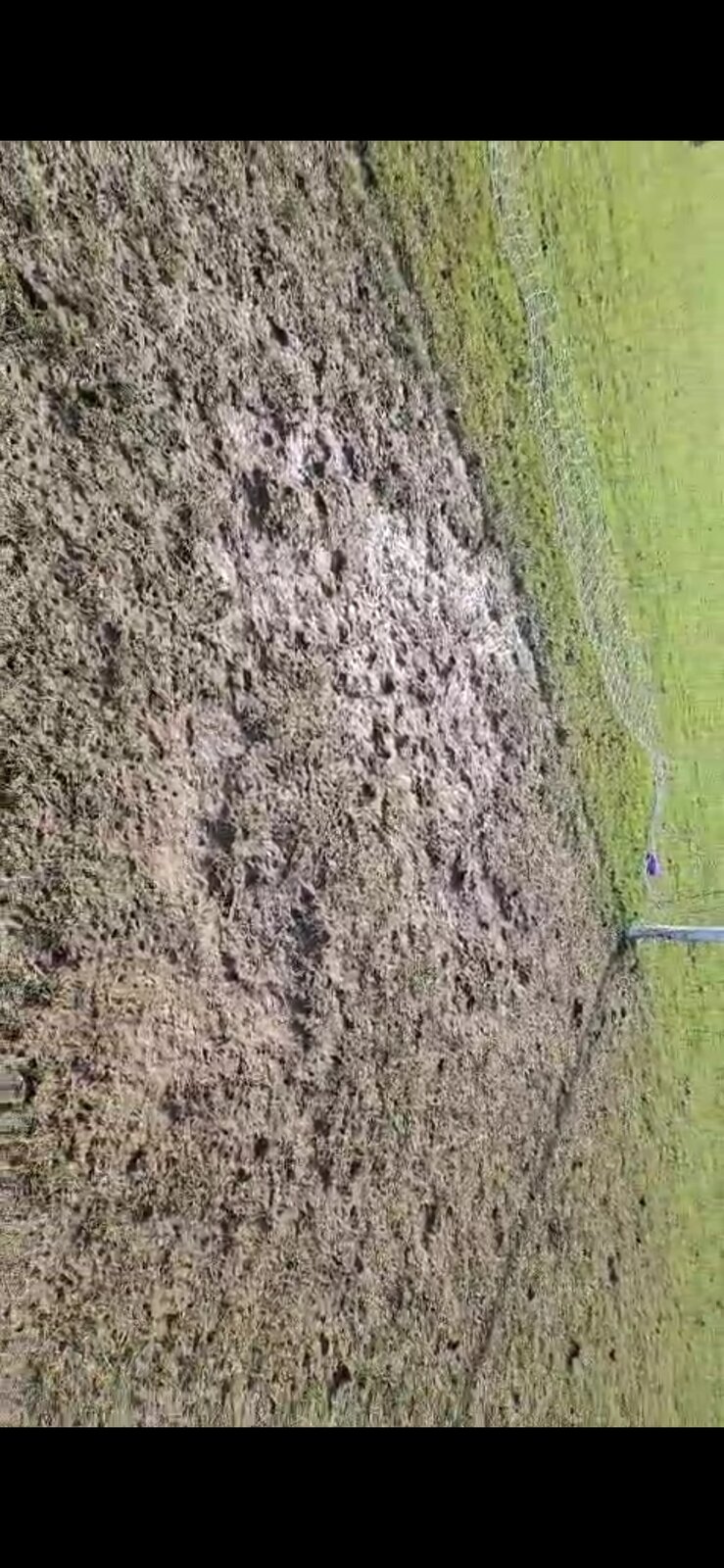

It's my girls teams home ground
It's a bit knackered.
Well at least one goal is.

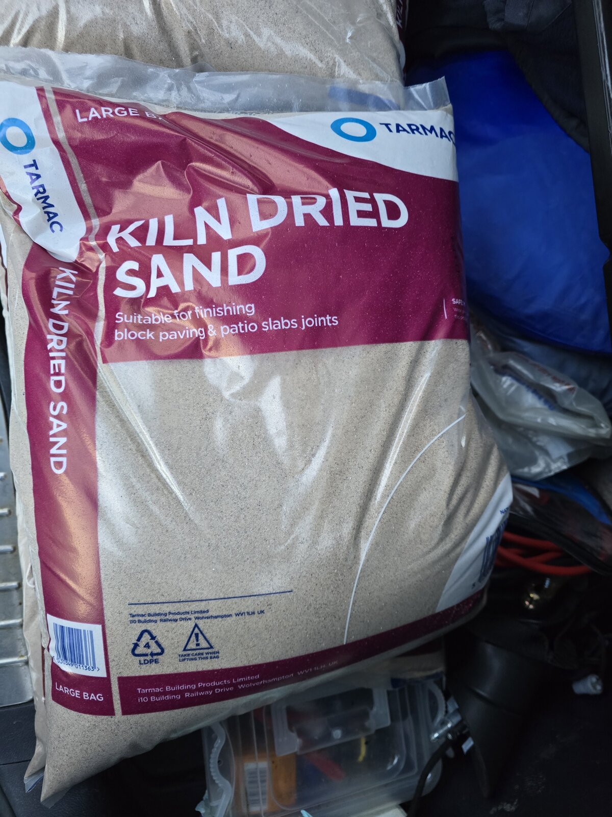

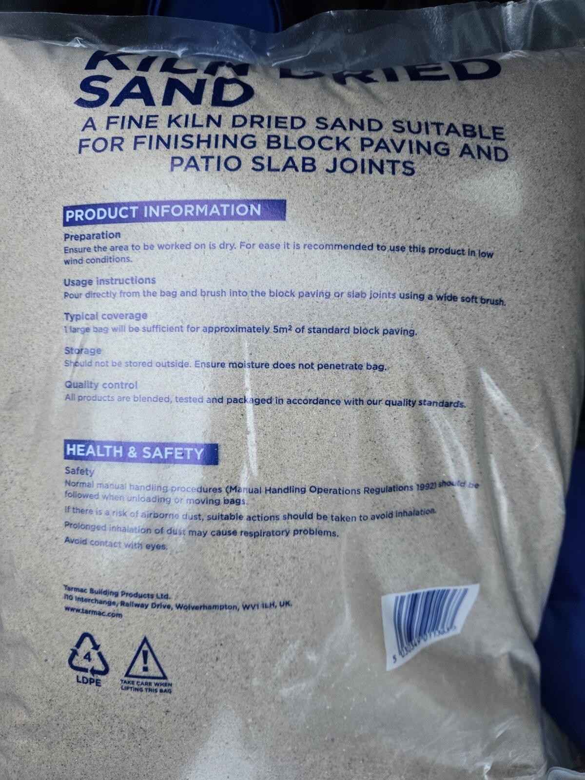

I had a little read up and bought some of this stuff.
Now I'm not too sure after a bit more reading up.
It's too fine. If you have a muddy patch on a clay soil, you need a coarse grit. The players will work it into the soil. This is common in goalmouths. If it was a lawn you would have to rake it in. Lawn sand is sold by garden centres but a coarse grit may come from a place that caters for sports grounds and bowling greens. If you ask a local bowling club someone will know.
Interestingly, gypsum plaster scattered or dug into clay also lightens the texture but does not keep for long as it will harden in a damp shed.
You can make up a mix of top dressing for regular use. Peat used to be added, I don't know what the modern alternative would be.
If you're taking on the job of groundsman, these patches would benefit from hollow-tining to pierce the mud before brushing in the grit. You can rake broken ground to get it fairly level, this is hard.
You can flatten hollows by dragging a home-made lute over the surface after applying top dressing, but hills need to be scraped or dug away. A simple lute is made of boards or a metal grid long enough to bridge over the mounds and dips. Players can help with the effort in training or maintenance sessions. Maybe someone in the club has a garden tractor.
If posting photos, please include something to show scale.
The picture is of the center of goal.
It's all about bit if a rush job as I was asked to inspect yesterday.
Im not groundsman , just a dad who wants to do the best for a bunch of 12 & 13 year old girls..

Go to you tube and watch Daniel Hibbert lawn expert. He does grass that resembles Wembley. I am not expecting you to follow suit but he will give you a step by step guide on how to improve and manage the grass. Whatever you do will improve it in the long run.
