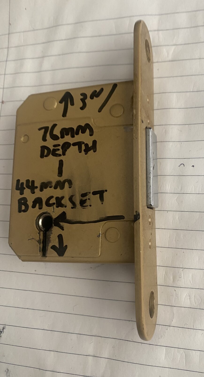

Just removed a deadlock from a fire door and it’s an unusual size?
The case/depth is 76mm/3” but the backset is 44mm.
The only locks I am finding with 44mm backset are 64mm/2 1//2” ?
Anyone advise please.

It’s an inside deadlock
measurements are 76mm X 44mm as above. No
It’s a thick solid door. 44.mm min

So the height of the case is three inches, as well as the depth?
The centre of the keyhole spindle is 44mm from the fore-end. How far from the top and bottom?
Are you concerned about the size of the fore-end, or will you chisel it to fit?
In your photo the bolt looks unusually large. Is that significant?
It is an odd size.
3” high and keyhole is set back 44mm.

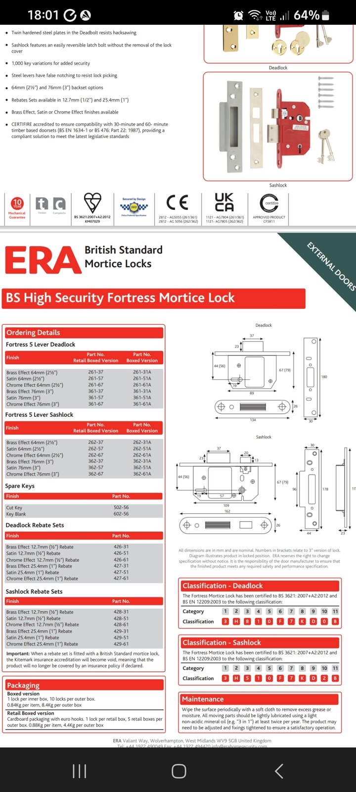

I tried Screwfix. Toolstation and both local building merchants amd no joy.
I have put on a standard night latch it for now but find it odd that there is no replacement for this size?
My local BM stated it was discontinued and that I need to use a 3” case and a euro cylinder even though it an internal door??

There is a 44mm backset, which you want.
The height of the case is 90mm, which is more than 3 inches, so you would have some chiselling to enlarge the mortice. The Chubb 3G114 is 76mm high and 67mm deep, which would fit, but the backset is only 40mm, which is a little less than you want.
I can't see the thickness of the case mentioned. It nay be about 18mm. Old internal locks are usually less.
