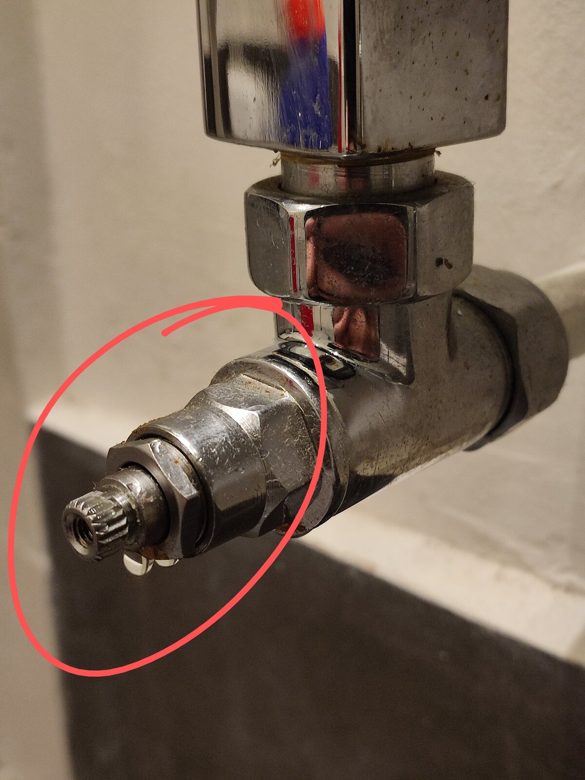

Got another flipping leak around a valve spindle, this time on a towel rail. Can internals be bought rather than the hassle of fitting a whole new valve? Just the front 'cartridge' bit or whatever it's called.

Have you tried tightening the nut slightly where the water is dripping from? That usually sorts it. If not I would remove the nut and pack it pack it with PTFE.
PTFE tape would temporarily fix the leak.
You might need to find a right size O ring to stop the leak permanently.
